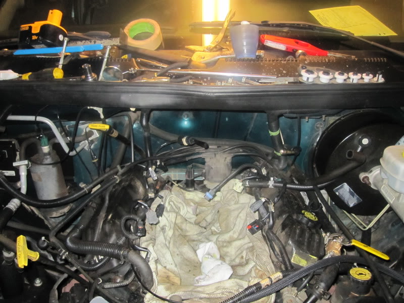

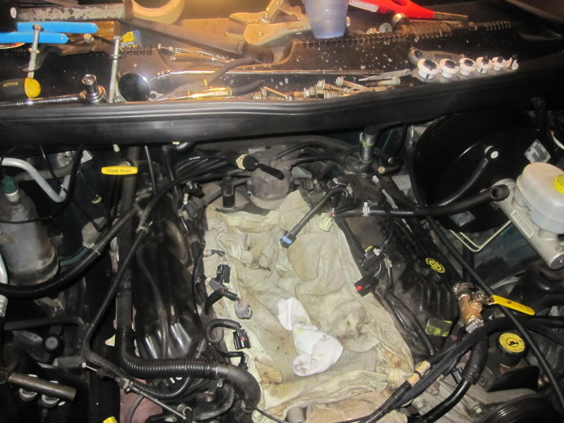

Here are some pics of the progress:
I cant wait to actually start working on relevant items.
I plan to replace the cap, rotor and plug wires, valve cover gaskets, and of course the plenum gasket.

nice pics. why do you have a ball valve shutoff installed in your drivers side heater hose ?

tip - start spraying the distributor cap bolts with pb blaster or similar penetrating oil to avoid another killer broken bolt.

I am guessing the previous owner used the valve to prevent coolant from going to the heater core to make the AC colder?
