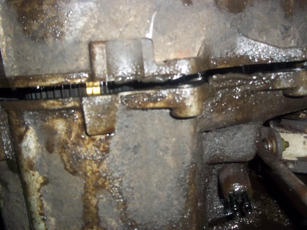

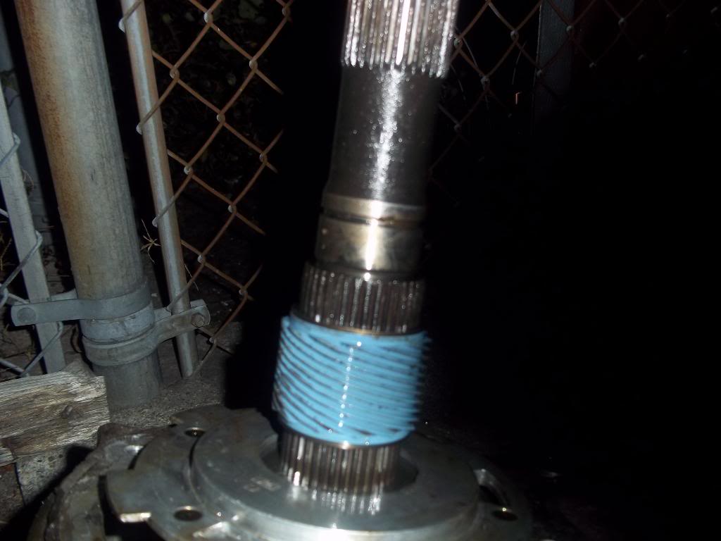

alright my t-case is blown, so i pulled it today. When i dropped it i noticed that i could move the output shaft back and forth, and when i pulled back and spun it, the front shaft (where the front driveshaft should be) would spin as well.
So i began gutting it out.
Now tell me, where is this "Snap Ring" supposed to be...i diodnt find one. looks like it goes in the groove where its flat between the splines, am i wrong?

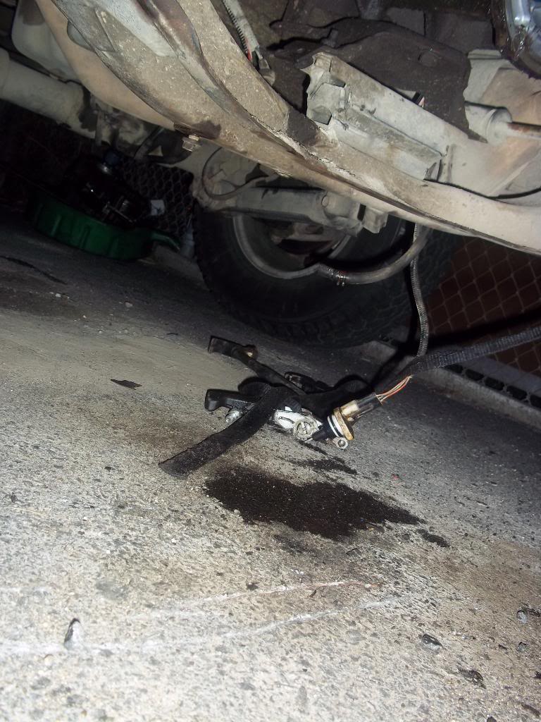

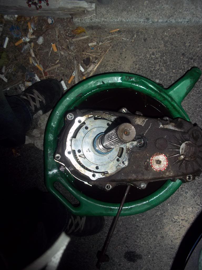

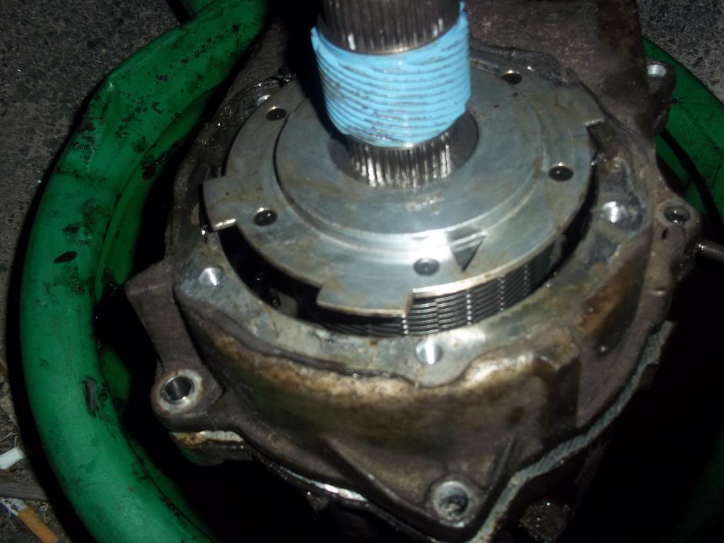

Also i must add, this was really simple dropping this t-case...took me about an hour and 15 mins....i had the most trouble with the top bolt on the t-case....didnt need any jacks or stands...just used ratchet straps to the frame, and slid it right out.
heres some more pics of the removal

i do plan on getting the saver, but can anyone tell me if they see where this snap ring is supposed to be? i have a feeling thats the problem that started this all.

Old Nov 4, 2010 | 12:05 PM
Posts: 87,561
Likes: 4,231
On the rear output shaft of the T-case, there is a snap ring, that tends to "fall off", and let the shaft, bearings, etc, "float" inside the case. This is bad, as they start encountering things they normally shouldn't. Transfer case failure inevitably follows.
The T-case saver, replaces that snap ring with a 'collar'....... preventing the aforementioned failure, thus, "saving" your T-case.
