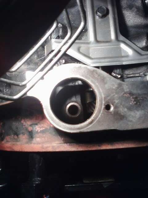

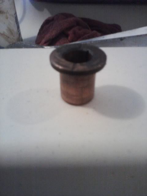

yes they're crower enduro II full roller.
you said torque the stud w/ loctite, but whats the torque?
some forums say the intermediate shaft bushing has to be modified so the shaft will fit is that right?

Erm, what bushing are you talking about? Post a pic? I was thinking in the trans.......

u can see the shiny metal through the distributor hole where the bushing used to be.
here it is on Summit
only reason i knew about it was because Hughes says that they replace them in their kit block as I was reviewing the Hughes block prep list
