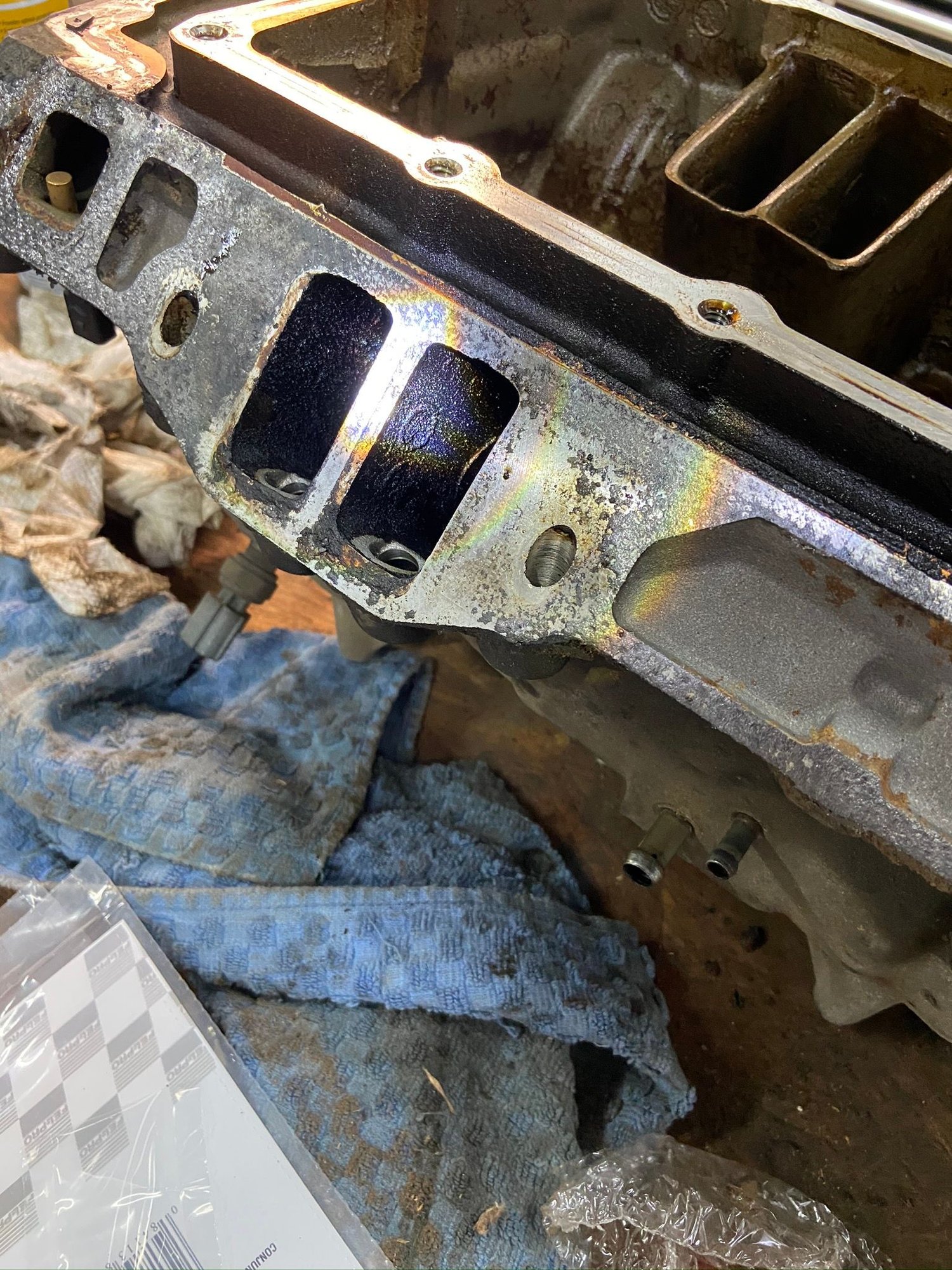

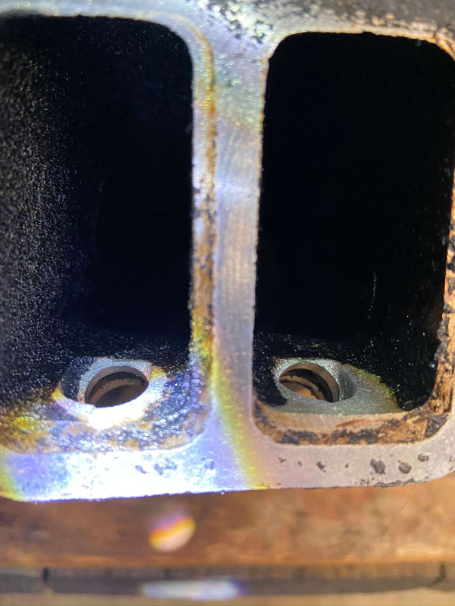

Here are some pictures of my intake. Should I try to clean these channels out before I reassemble? If so, what solvent/cleaner have you guys used effectively? Or do you just leave it alone?

Brake, or carb cleaner.... just spray it in there, and if it comes off, fine. If it doesn't, well, that's fine too.
I took the intake I was going to swap in to the machine shop, and had it hot-tanked. But, I had picked up a spare, as I knew that was going to take a while.

I hit it with a little both today and neither seemed to faze it. I figured if it was that baked on, it prolly wouldn’t matter if it didn’t come off.
Thanks
