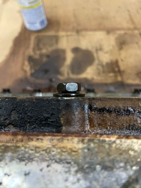

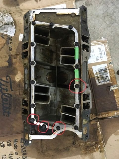

I made some observations and took some measurements yesterday on my plenum. 4 of the washers on the factory bolts would not snug down to the face of the intake surface. The rest did. I use a feeler gauge and measured about .010 gap between the washer and the face of the plenum. Then I mic’d the thickness of the factory plenum to be .090 and with the gasket .125. In other words, there is a 1/64th gap filled with an 1/8th thick plenum/gasket. I would think that would be enough to hold the gasket in place. So maybe there’s something to the differential metal theory.
That said, all the bolts measured the same length. So it would appear that the depth of the holes machined into the intake were not consistent.
Notice that the worst failed gasket was between two good bolts. No failed gasket between “tall” bolts at bottom.
The bolts circled in red are the places where the washer on the bolt would not contact the surface of manifold before bolt bottomed out. Area in green highlight is where gasket failed.
This gap measured .010/.012 on feeler gauge.
