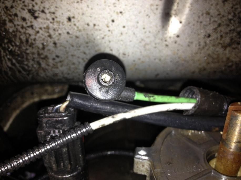

Attachment 17416
Here is a another photo of that plug....anyone have an idea of what it is for?

Originally Posted by nwracer45
Attachment 17416
Thanks
Ok so it's on the drivers side just in front for the dizzy but can tell. I think the other two pix were better (sorta) but those are no longer viewable?
I can tell you it's not a vac line. That would be a tupe/hose of some type. Maybe repost those othere two or better yet new ones..No CEL huh?

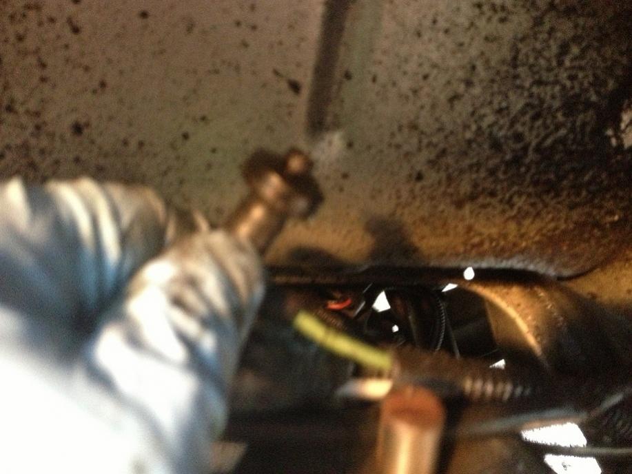

hey Patt, Here are the photos again. The location is right behind the distributor. The white line coming out the same location is a vacuum line. Anyways someone has got to be in the middle of a tear down that can help out. The truck a a 2001 1500 quad cab 5.9L.

i would guess it is a vacuum line. could be for anything since it is back there. i think you might have to download the 2001 service manual in the FAQ section.
