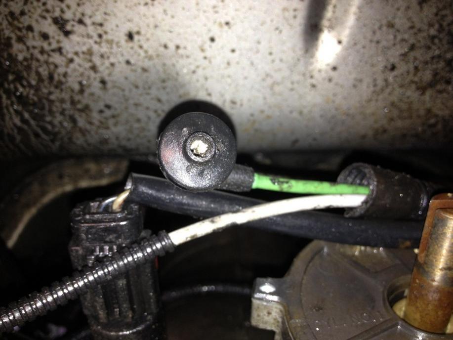

Originally Posted by nwracer45
Attachment 17423
Attachment 17424
hey Patt, Here are the photos again. The location is right behind the distributor. The white line coming out the same location is a vacuum line. Anyways someone has got to be in the middle of a tear down that can help out. The truck a a 2001 1500 quad cab 5.9L.
Thanks.
same issue here 2 weeks ago, the white is a vacuum line, the green is a vent with protector to keep anything from entering it. it is just how it is supposed to be.
