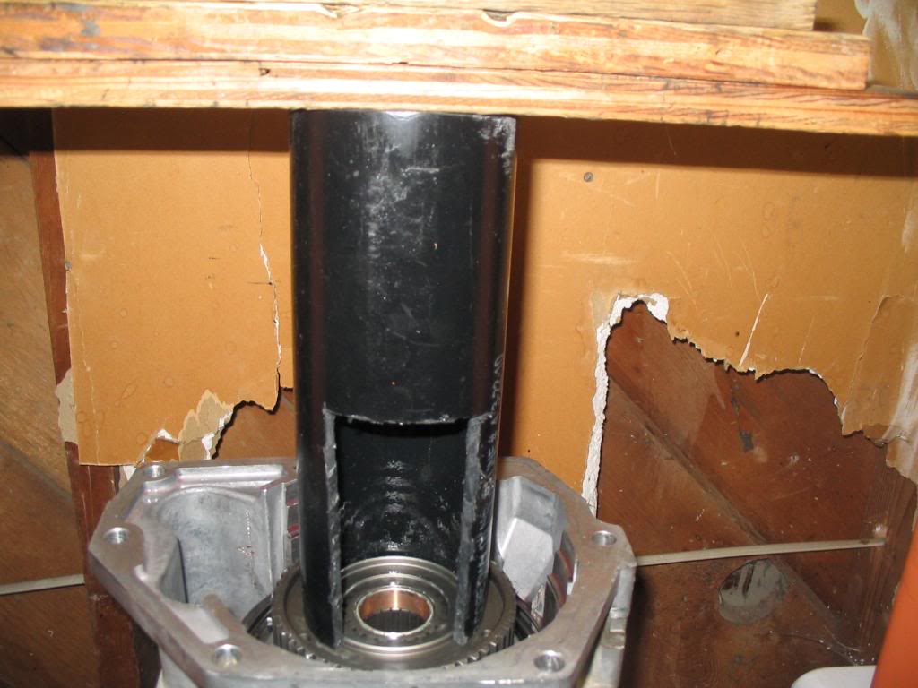

Setup in the press.

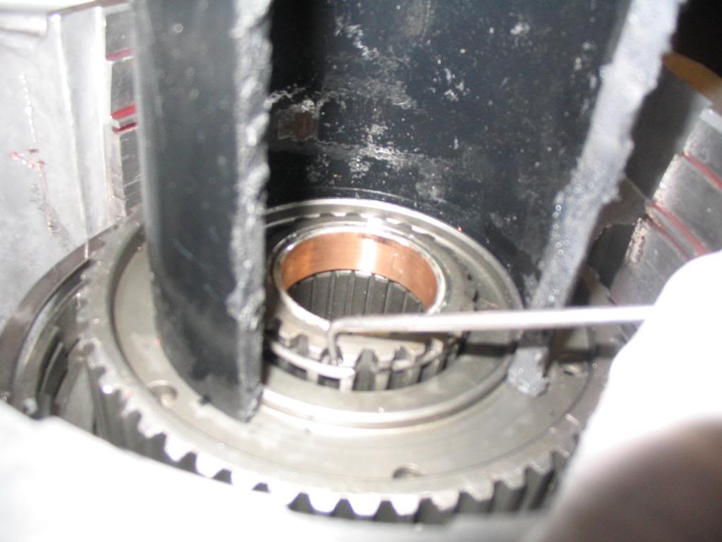

Old Aug 20, 2011 | 01:51 PM
  #122
rocky_mtn_ram's Avatar
rocky_mtn_ram
Joined: Dec 2010
Posts: 209
From: Crawlorado

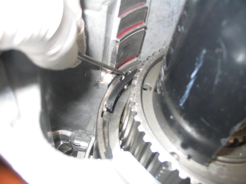

Removing round snap ring from O/D sun gear shaft.
Snap ring removed.

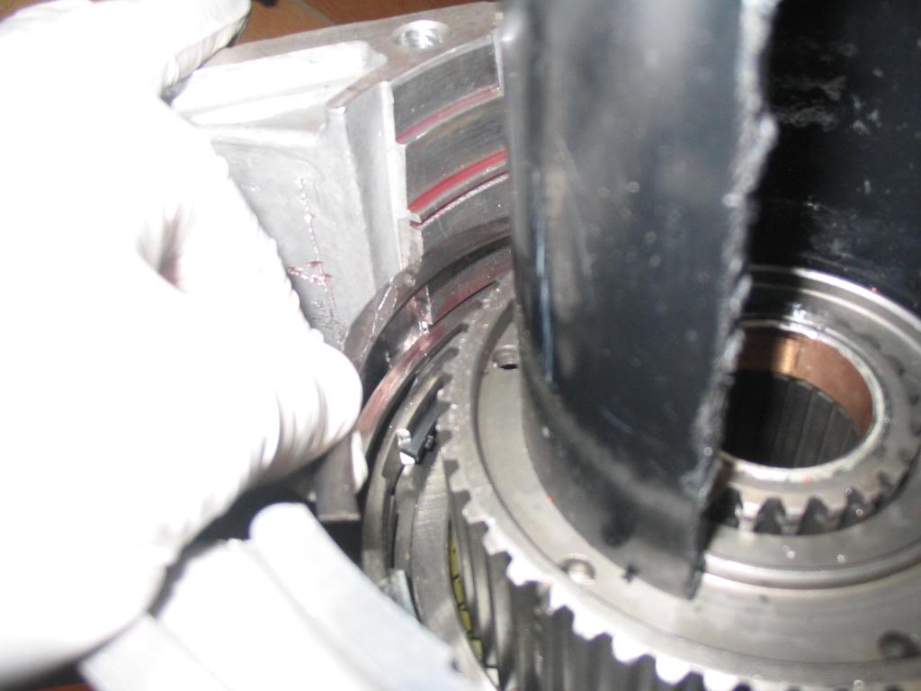

Old Aug 20, 2011 | 01:54 PM
  #124
rocky_mtn_ram
Joined: Dec 2010
Posts: 209
From: Crawlorado

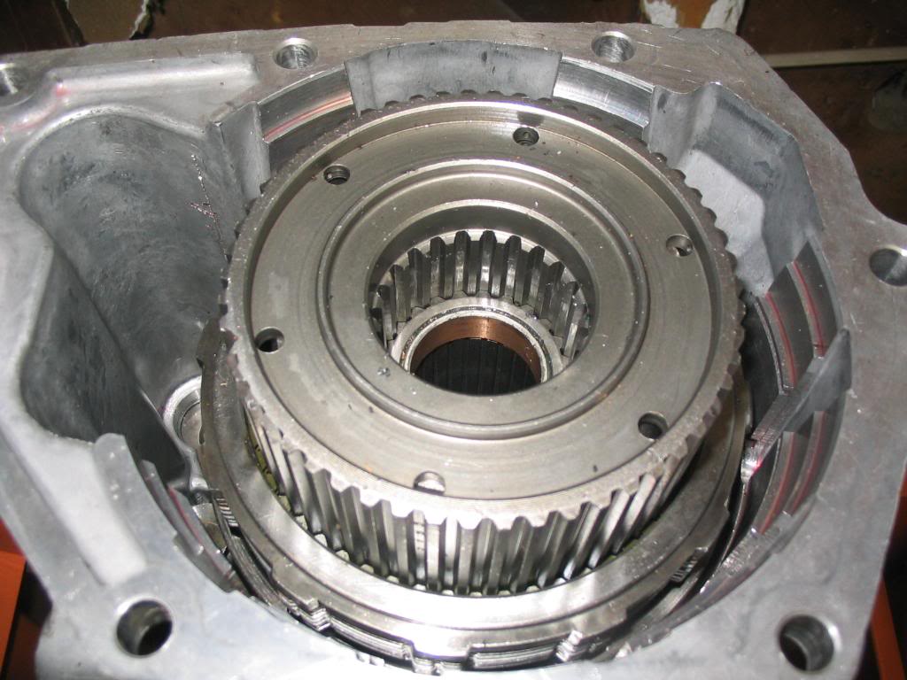

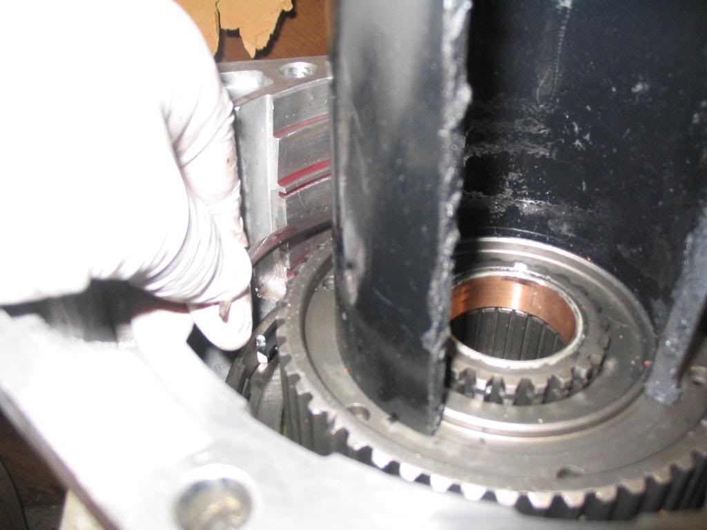

Removing wavy style flat snap ring.
Removing the flat snap ring.

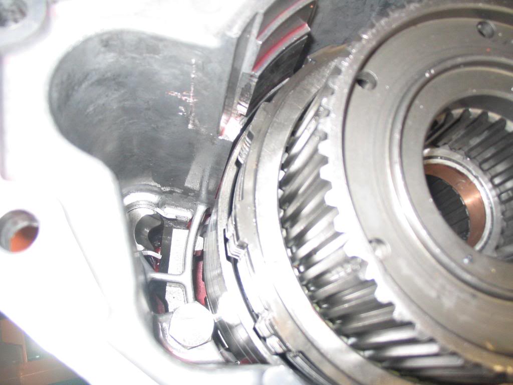

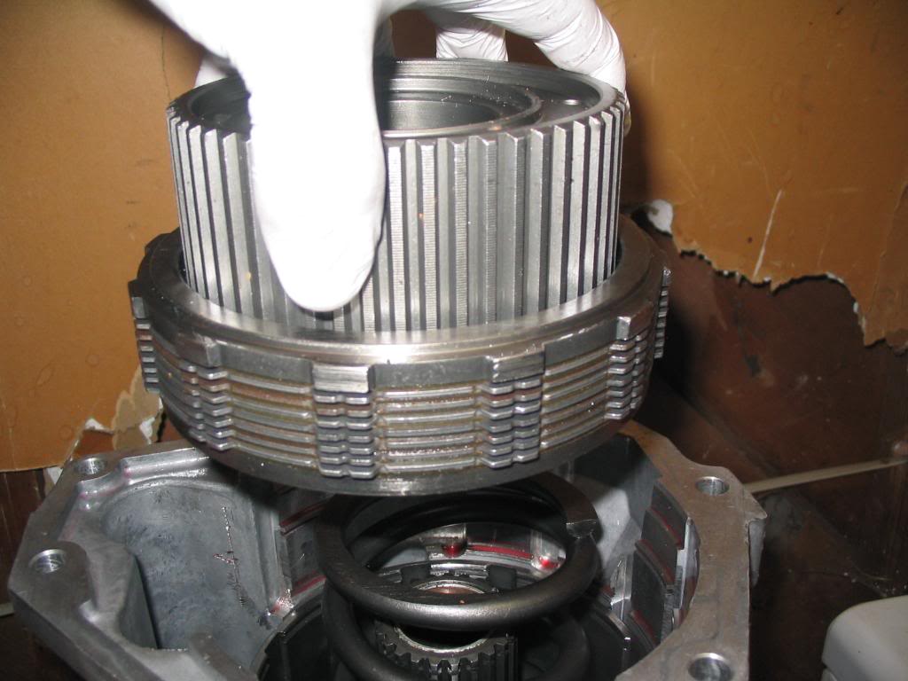

Old Aug 20, 2011 | 01:56 PM
  #125
rocky_mtn_ram
Joined: Dec 2010
Posts: 209
From: Crawlorado
Removing snap ring from the top of the O/D direct clutch pack.

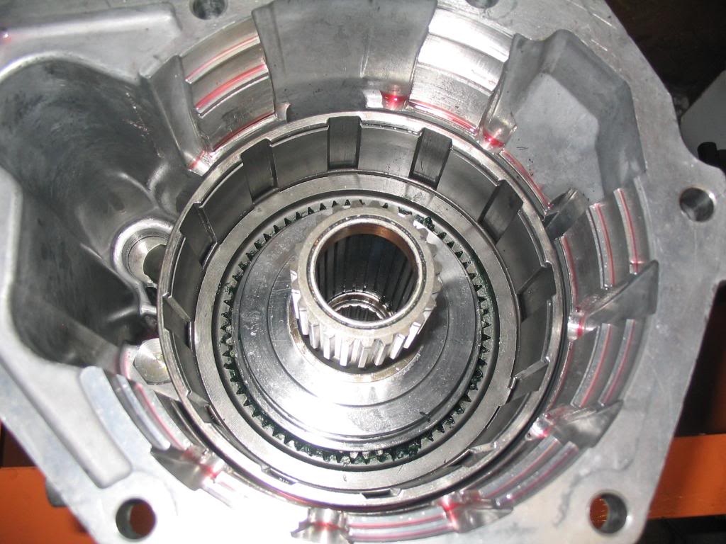

And finally the pressure released from the press and everythings all loose.

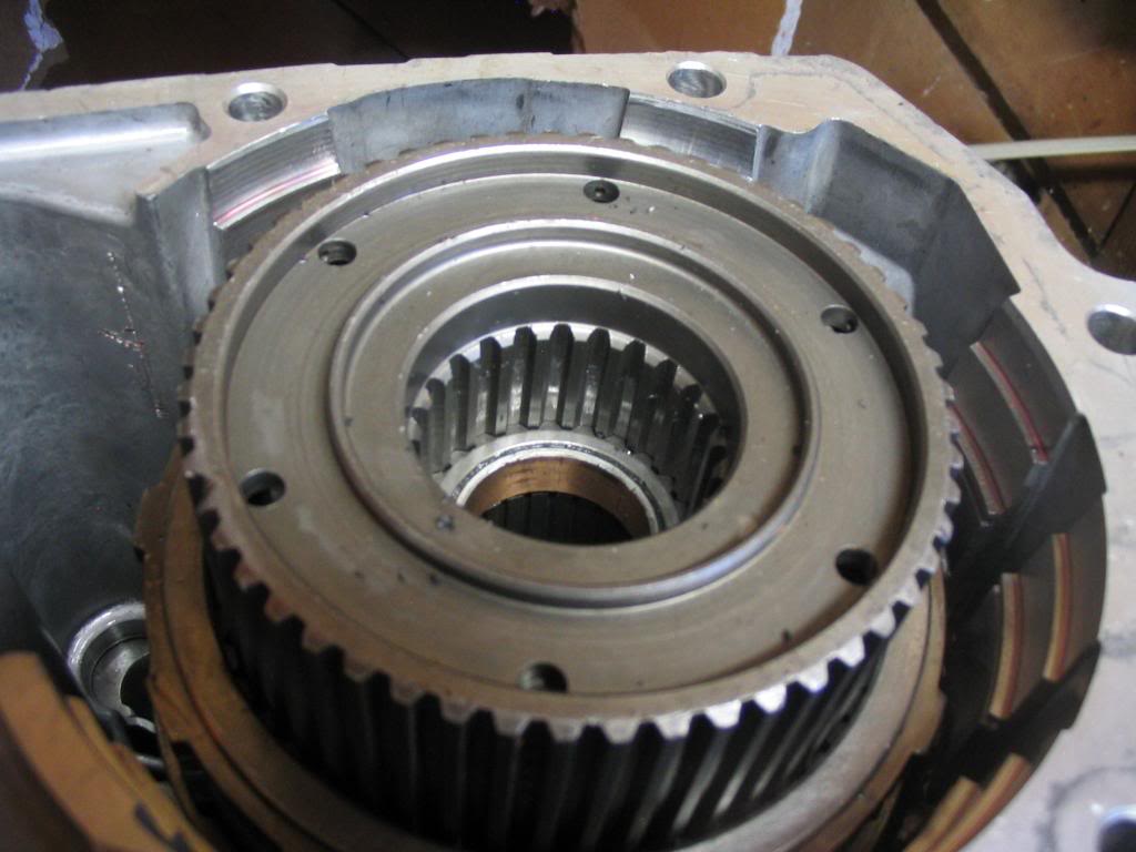

Old Aug 20, 2011 | 02:02 PM
  #127
rocky_mtn_ram
Joined: Dec 2010
Posts: 209
From: Crawlorado

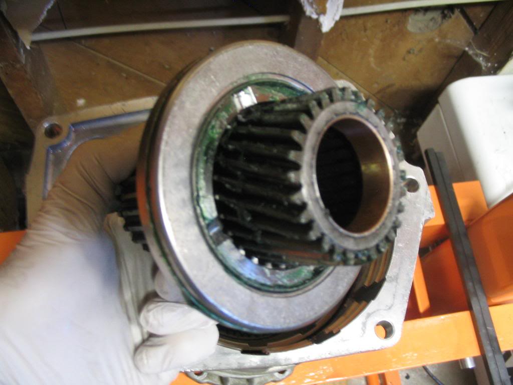

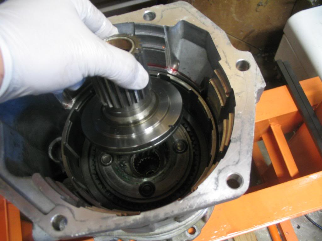

Removing hub and O/D direct clutch pack.

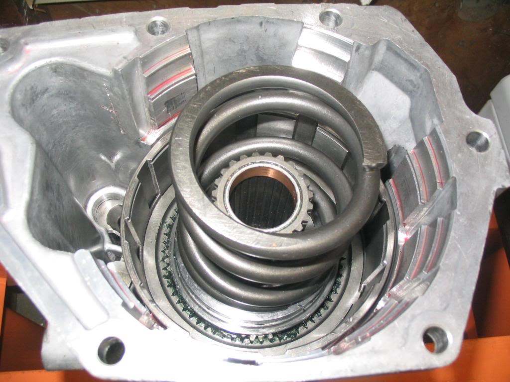

Old Aug 20, 2011 | 02:03 PM
  #128
rocky_mtn_ram
Joined: Dec 2010
Posts: 209
From: Crawlorado

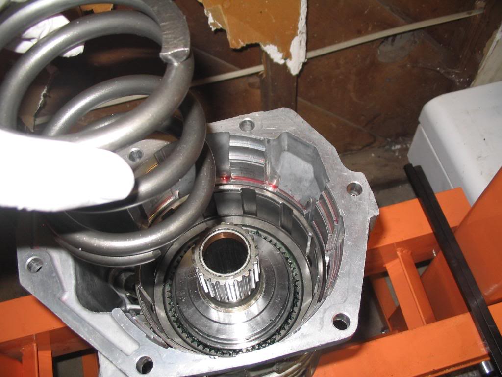

Removing spring from its seat.

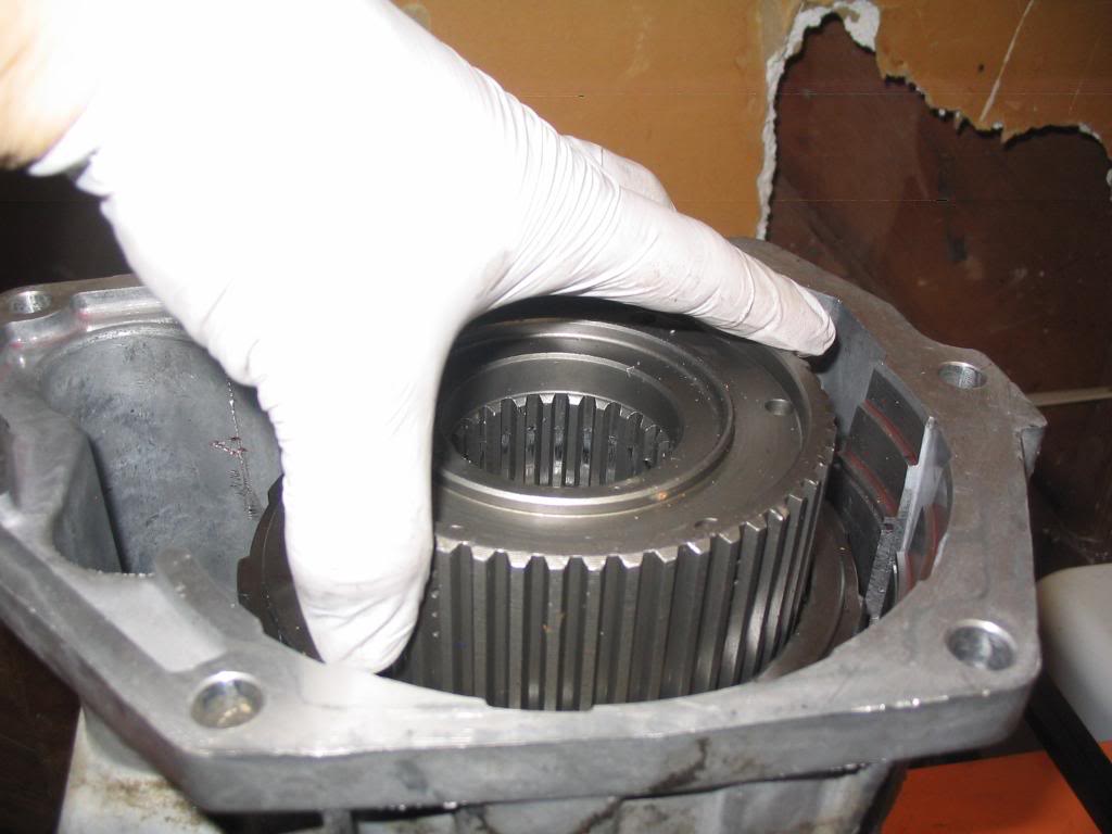

Old Aug 20, 2011 | 02:05 PM
  #129
rocky_mtn_ram
Joined: Dec 2010
Posts: 209
From: Crawlorado

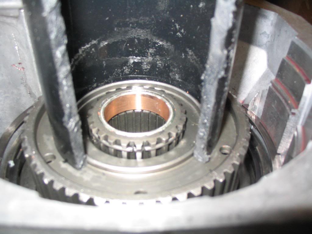

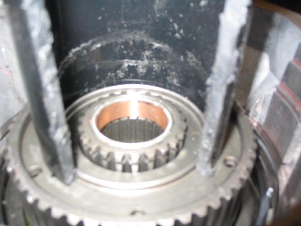

O/D sun gear seated in planet.

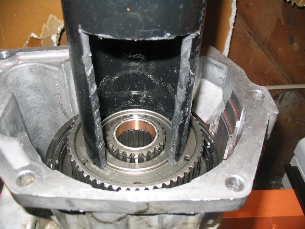

Removing.

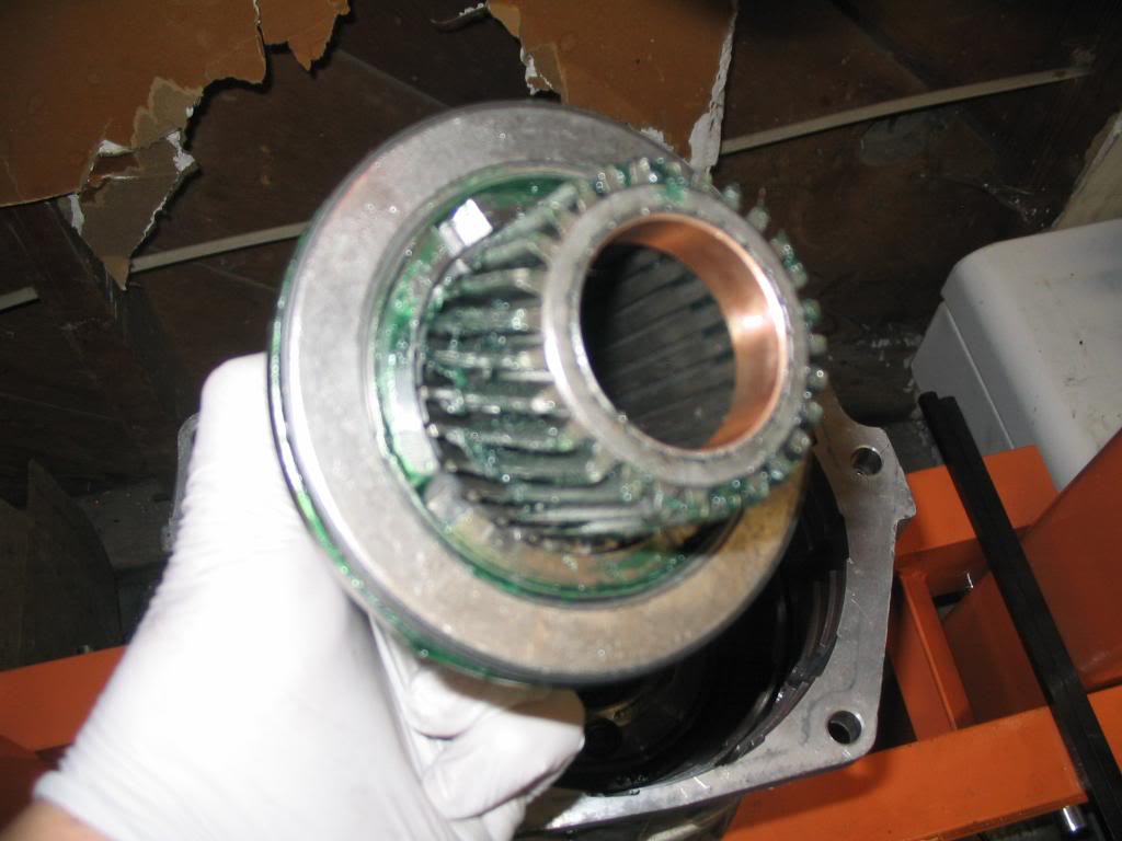

Thought maybe I had this bearing upside down...? But I dont think it is.
