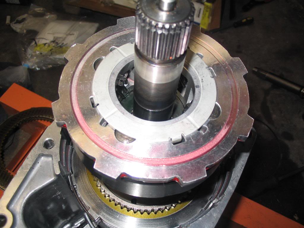

Another question...so I called WIT today because they actually shorted me 4 frictions for my forward clutch in the main case, so they sent em' to me today free of charge. I even neglected to order the copper plated thrust washers that go in between the from and rear planet in the main case and in the sun gear shell, so they threw those in for free. My question is, I'm not particularly one to complain about free stuff, but the I.D. of the new washers they sent me are slightly larger. I had a 4 tab between the forward planet and the forward ring gear measuring 2.5300" I.D.
They sent me a replacement for that, same measurement. I have a 6 tab in between the forward ring gear and sun gear shell, they sent me an identical replacement for that. Now the third washer that goes sun gear shell to rear planet, the I.D. is the same 2.5300" I.D. but my old one measures 2.2500" I.D. Is this harmless or will I have to complain about the mismatched parts? Lol... Otherwise, I'm about ready to button this thing back up. Thanks guys.
Old Aug 23, 2011 | 07:55 PM
  #150
rocky_mtn_ram's Avatar
rocky_mtn_ram
Joined: Dec 2010
Posts: 209
From: Crawlorado
Figured a picture is probably in order.
