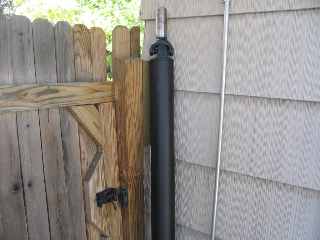

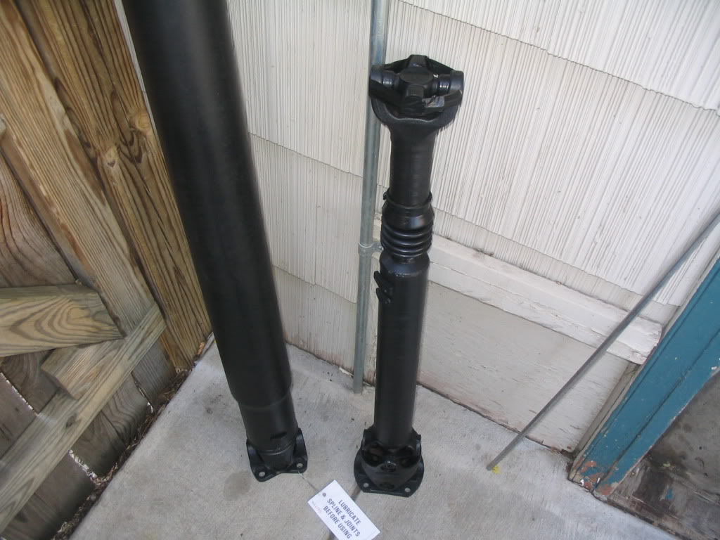

Yeah living in the mountains of Colorado 2wd isn't really an option. Got the driveline back. Damage was $202.96. The kit worked fine he said, and he even polished up the rust on the slip shaft and laid a coat of paint. Thoroughly pleased. Time to get to work I suppose.
