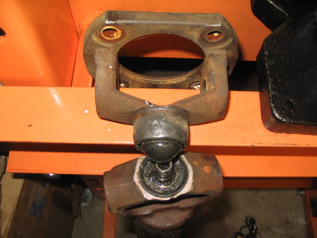

Can someone please tell me what this part of my front drive shaft is? And why it's not referenced in the manual anywhere that I can find...
And more importantly, can it be repaired? I think we may have been talking about two different things. This isn't a center support bearing.

Because the driveline shop I know about said when I called that I was looking at around $300.00 for all new spicers and rebuilding this part pictured above. I think $300 is way steep. Especially because everythings already taken apart. I think he was referring to the center support bearings most 2 piece shafts have...I just dont want to look like an idiot going in asking him to rebuild this part if it's not salvageable.

Is that the yoke at the transfer case?

It's the front driveshaft, the end closer or closest to the booted splines. I can't remember if its the end closer to the front diff. or the transfer case at the moment. Its like a peg sticking out of the shaft, and a ball with a hole and a spring on the flanged end. I didn't take pics for the driveline, of course...just index marks.
