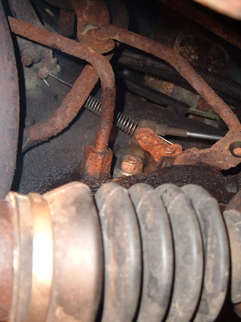

does anyone have a pic of the spring on the out side of the tranny. im pretty sure i hooked mine up wrong when i did my od solenoid replacment

It should latch onto the upper lever on the shift shaft and latch the other side toward the bellhousing.

thanks z, and i replaced my od soleniod becase i lost o/d as weel, but after less that a week i lost o/d again. im gonna bench check the new soleniod and replace the gov transducer and see if it helps
