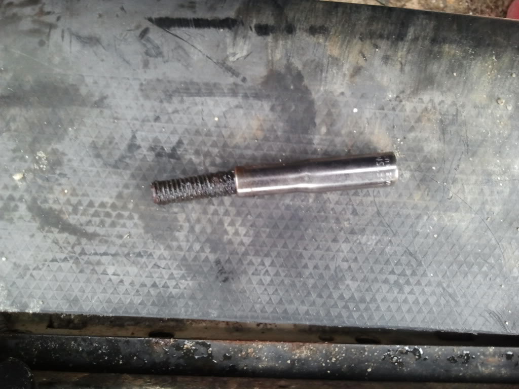

my inventful way of getting this damn broken bolt out. couldnt drill through it to get an extractor in there, so i jammed a 1/4" drive, 1/4" socket on there and she came right out!
