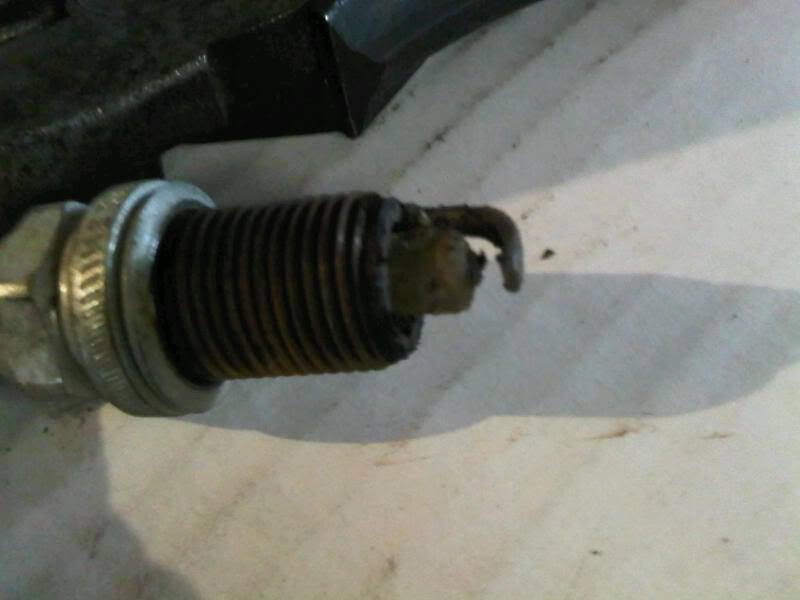

Found the cause of the misfire:

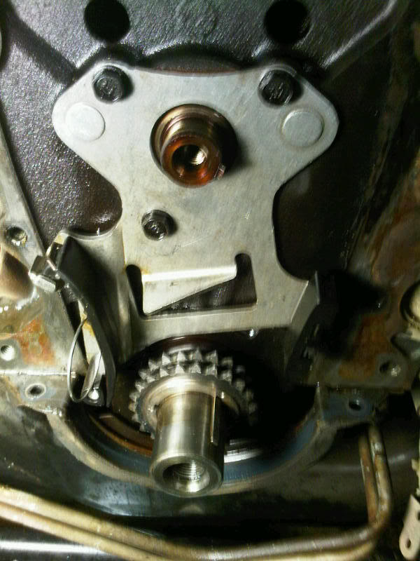

Timing set:

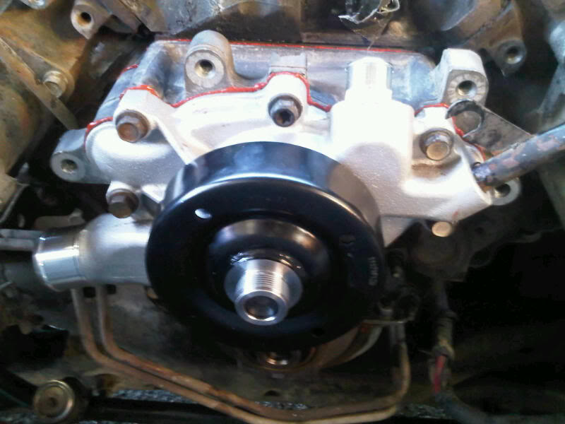

Timing cover and water pump back on:
Didn't get the intake pulled and swapped yet - too many ball games this weekend! May have to slip off work early tomorrow.......

That is what I expected. 4 other plugs were nearly as bad, and although it got CEL running aound town (30 - 40 mph) I did not feel anything until around 70 mph. I am surprised it was running as well as it was with plugs in that condition. With new plugs, rotor, wires and tune, this thing ought to really feel like a different truck - hopefully tomorrow.
