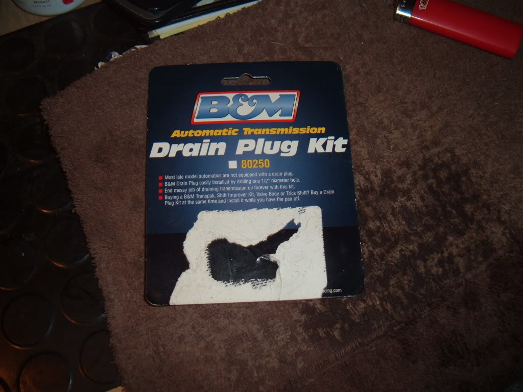

Order one of these in the meantime , and install it next time you drop the pan.

Yes, I tried to get one from autozone but they didnt have one. Also someone there said DON'T do that! He said something about it being pressurized and putting a plug in would be catastrophic.
LMAO... reason 1001 to not shop at Autozone. Unless wax or oil is on sale. Do NOT buy the gov solenoid at AZ.
