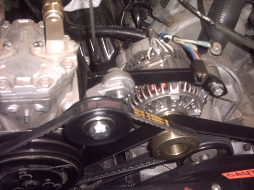

Onboard Air for the AirRock system plus ARB lockers and to fill the tires after a day of playing. Not a great picture but that is a York compressor and a 175 amp altenator for my onboard welder.

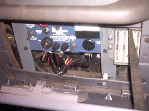

Onboard welder is hidden in the glove box. It really does work out great.

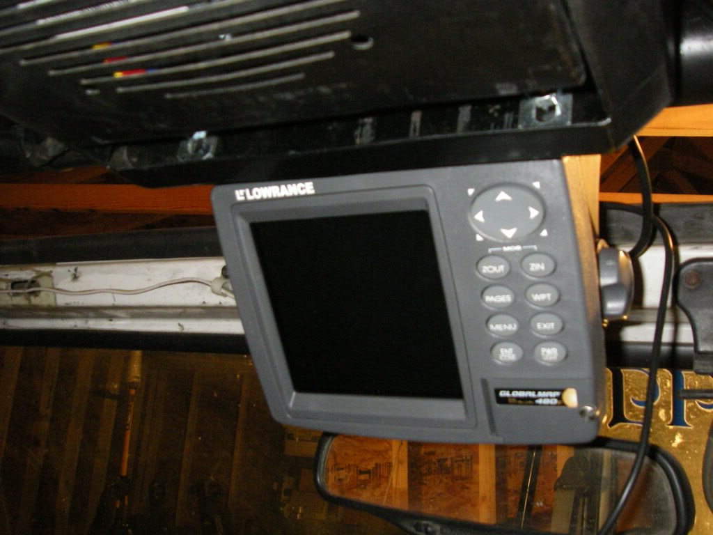

GPS so I don't get lost.......Nice color screen and nice and big so this old man can see it.

Is that REALLY a welder in the glove box? Brand, links, etc. That looks interesting!

This is the onboard welder link: http://www.premierpowerwelder.com/index.html
And then I also carry a mig welder in a case. It can hook to the arc welder leads or to two or more batteries. Here is a link for it: http://www.premierpowerwelder.com/re...readyweld.html
And then when I'm out somewhere that there isn't a lot of trees and stuff I carry a Pull Pal: http://www.pullpal.com/
My Jeep is setup for pretty much anything I need and if some breaks down I've got the tools to fix it. I've used my welder on maybe 10 rigs since I had it. The unit also has a 110 AC outlet and I sat one day just running my Jeep while we installed a fence to keep people out of a closed area. It was all rock so we were using roto hammer drills. You couldn't get anything much bigger than my Jeep up there so I was the only power.

Dang! That is all rigged out, and in a small package. I like!
