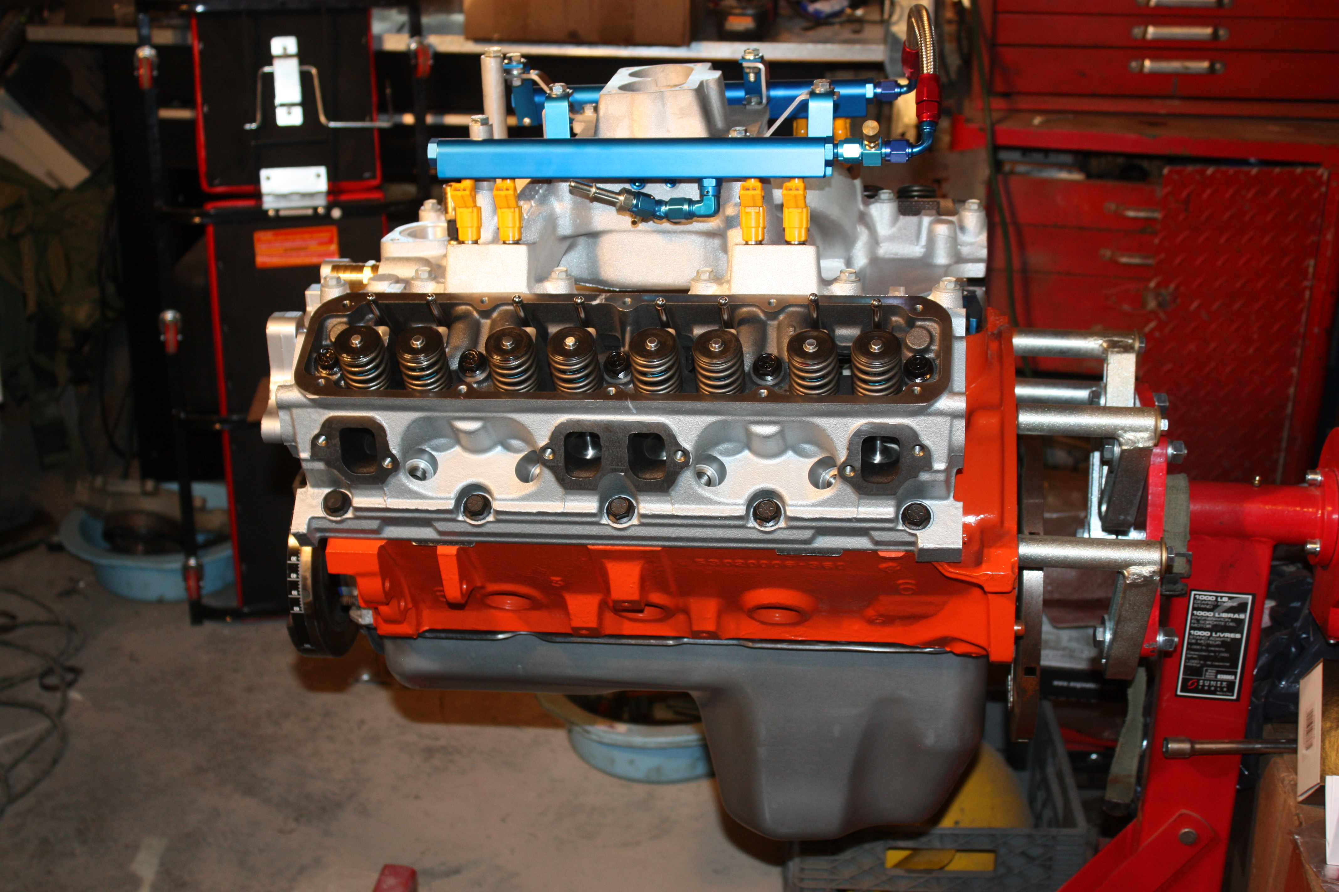

Well not much of an update just finally got to order the rockers, studs and guide plates.

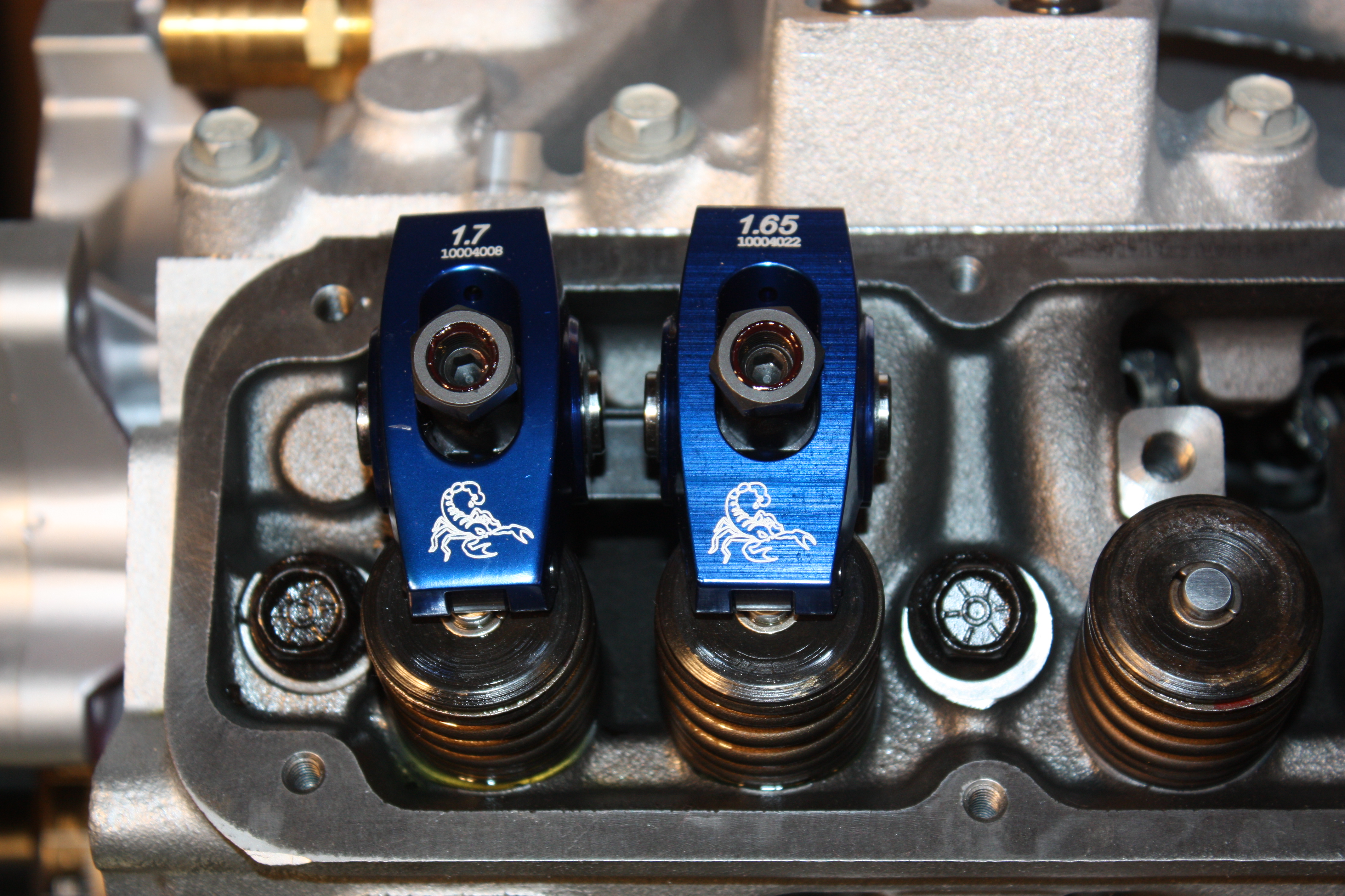

But I did decide to mix it up a little bit and mix and match the rockers. I got Scorpion Endurance Series Roller Rockers. For the intake I went with a 1.65 ratio and for the exhaust I went with a 1.7 ratio. Should help the engine breathe a little more. And I also have a adjustable pushrod coming so I can measure everything and make sure I get the right length ones for it.

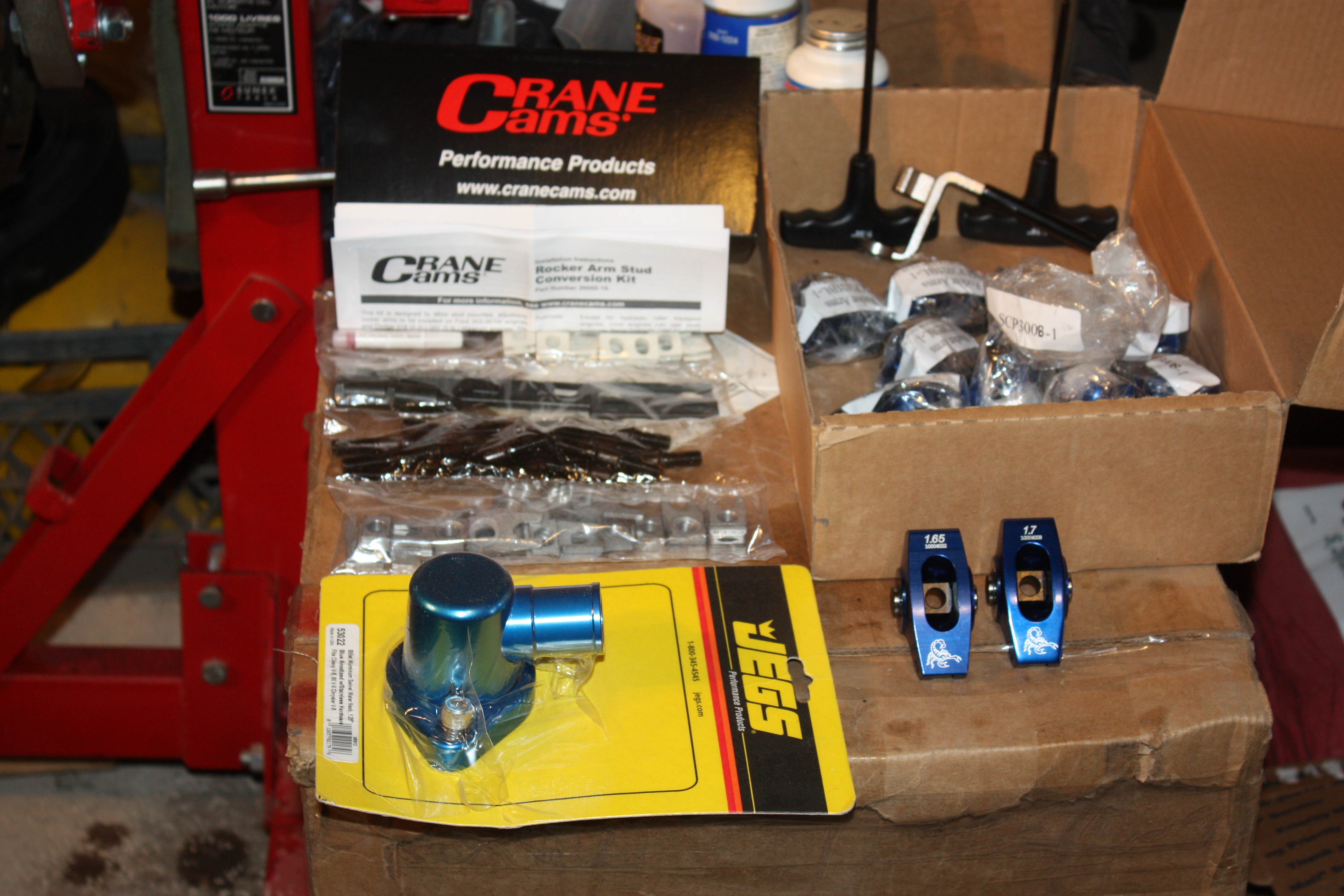

Well I finally got something to report on. While I was gone on my camping trip I ordered some of the parts I needed. Funny thing is some of the parts didn't get here til today and I ordered them on 30 June.
The water neck I ordered must be for an older 360 as my holes are closer together. So no fancy thermostat neck. BUMMER

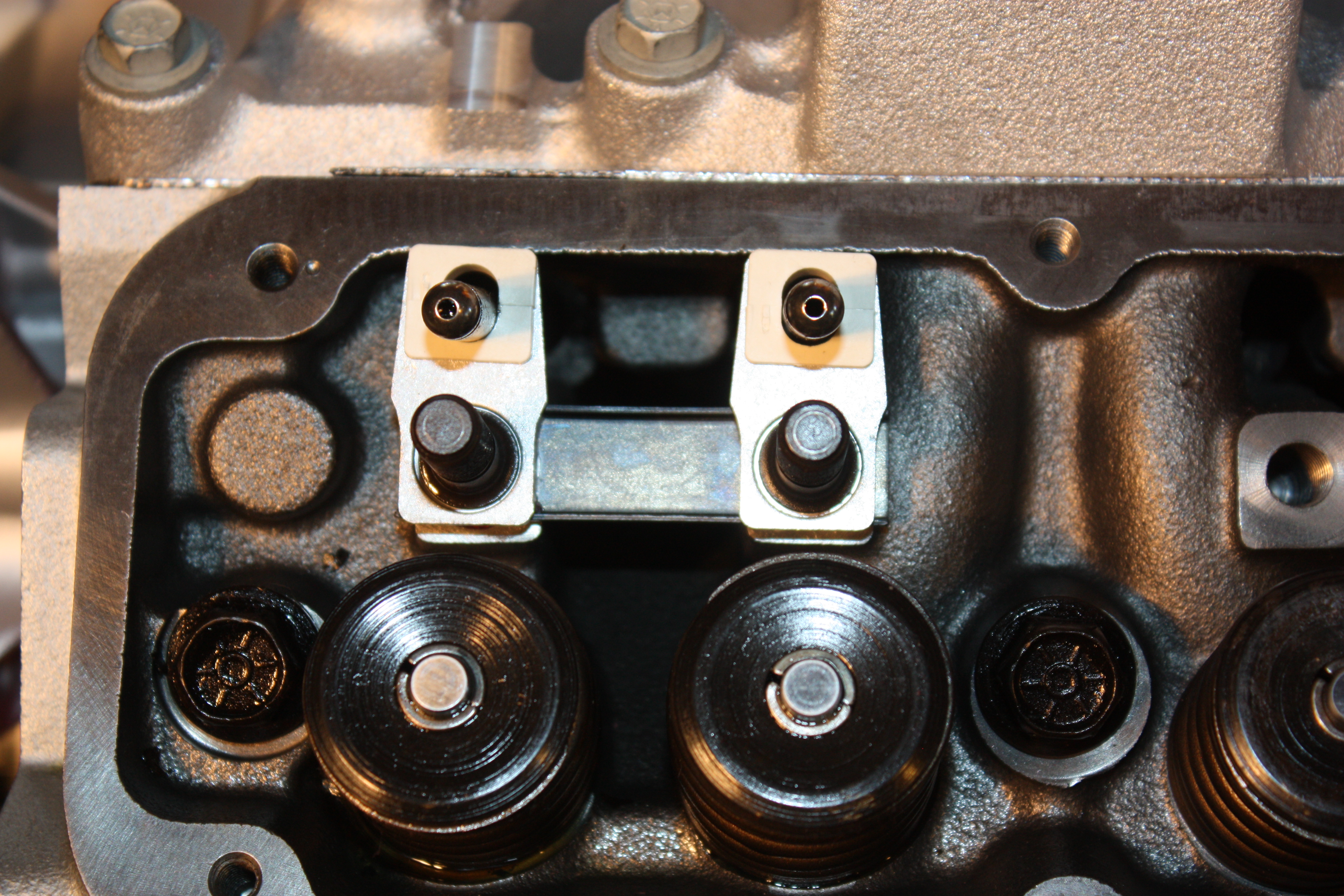

So I got the Number 1 cylinder done first and then used the adjustable push rod I had bought to check for length. I lucked out and the stock push rods were the proper length.

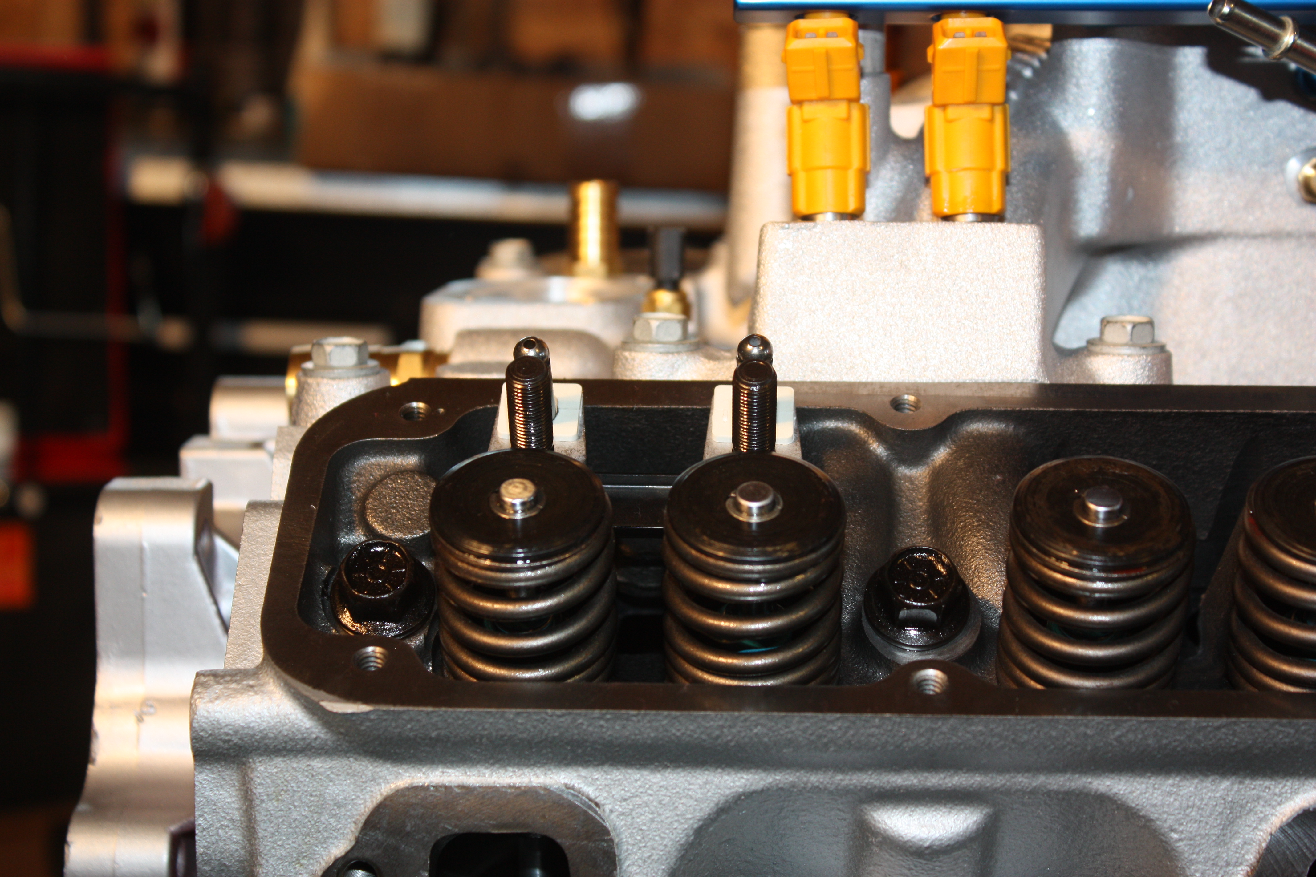

Got a stud conversion kit from Jegs it is made by Crane Cams and has the studs 3/8 top and bottom, guide plate and guide plate insert.
http://www.jegs.com/i/Crane-Cams/271...29#moreDetails

I went with Scorpion Endurance Roller Rockers with the intake in a 1.65 ratio and the exhaust in a 1.7 ratio.

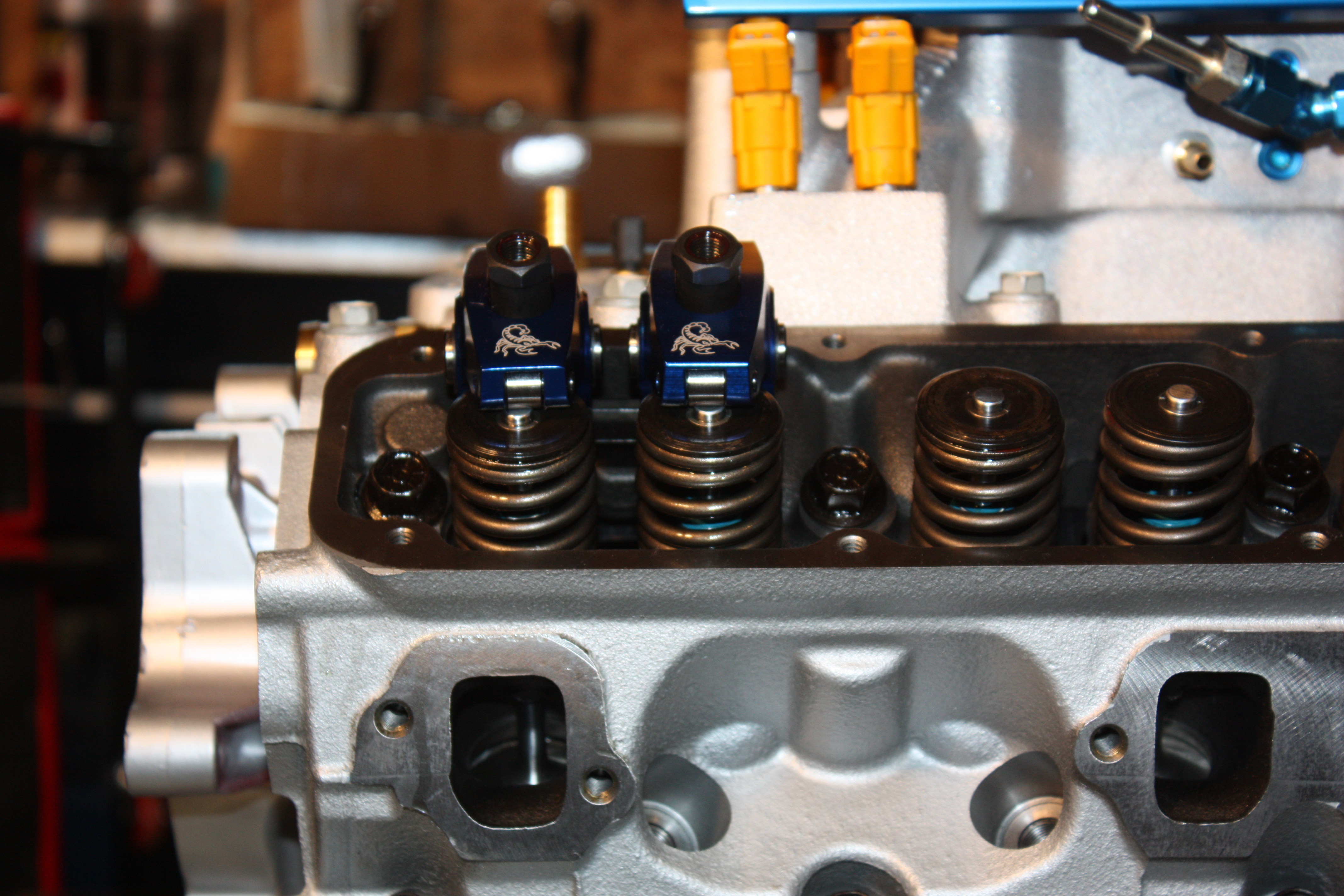

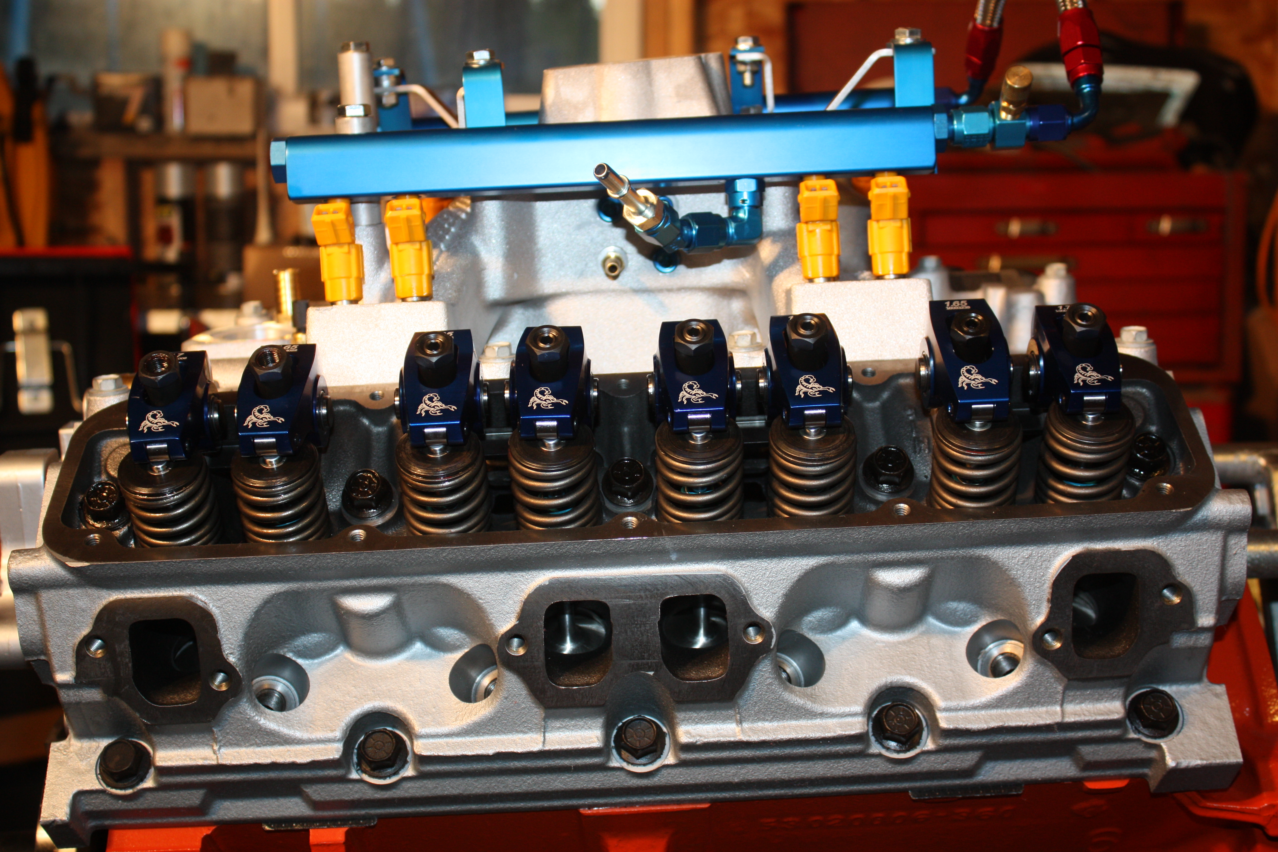

I finished off the left bank tonight with getting all the studs installed. Threw on the rockers just to get a picture. Will get them all adjusted tomorrow and then start on the right side. I am getting closer to having this engine done and ready to install in the Jeep.

I like that fuel rail. Very pretty. Where did that come from?

Looking good there WM, what did you set your valve lash at? I have tried from 0 to one turn and found my best results are about 1/2 turn from 0.
From Richard @ HiPoTek and they come in Red, Blue & Black. I think he also sells a plain uncoated one too. He also sells the ends with the hoses and stuff.
Right now I only have done the #1 cylinder and I did a full turn on it. So you're suggesting I back it off to a half turn? I've got to take it back a part cause I need to oil the push rods.
