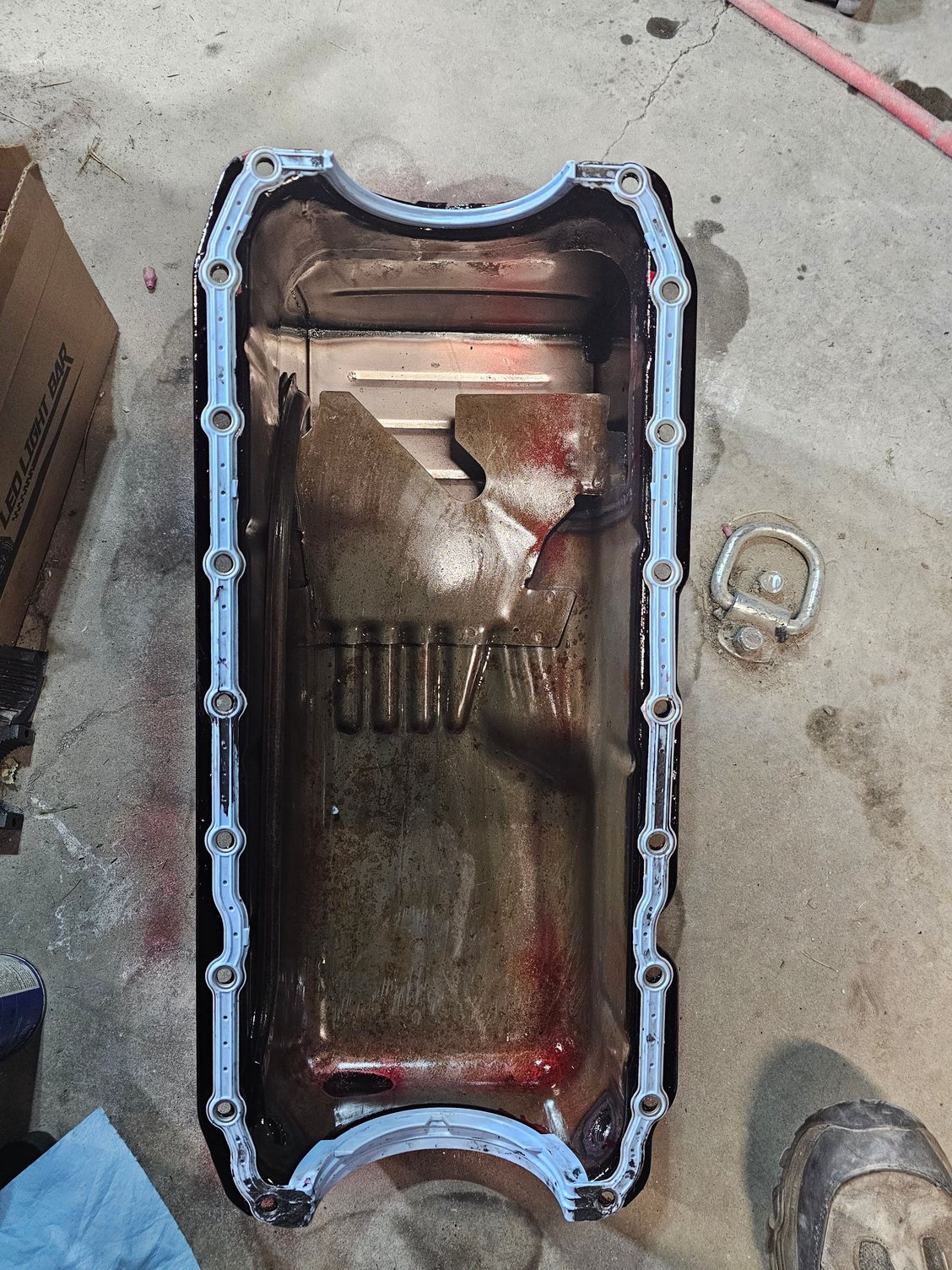

OK I screwed something up when I installed the oil pan. The new gasket has little taps that fit up into the block but every time I would get the gasket up there it would fall back out. So I'd set the gasket on the pan and put it up there. But I must not have gotten something right because I've now got an oil leak when I rev the engine up.
So what did I miss when installing the gasket?

Pulled the oil pan again and HOPEFULLY got the gasket installed correctly this time. Tried to get the gasket to stick to the block but everything I tried didn't work. Tried High Tack first and used a couple of bolts to hold it up but it didn't stick. Then tried some Right Stuff but again no joy. Then I tried to get it to stick to the oil pan and it did somewhat. Then used some aligning pins to help guide the pan & gasket in place. That windage try makes it more of a PITA to get it in place without knocking the gasket off.
It's all back together AGAIN and fingers crossed I got the leak fixed. Won't know until later as the oil I'd just put into it was diluted with fuel from what I think was a bad tune. Right before I'd dropped the pan the first time to change the oil pump I had installed the new tune that FRP had sent me. Then I'd tried to start the engine to warm up the oil so that I could drain it but I could barely get it to run and it was back firing through the exhaust. Then after I'd changed the oil pump and added the new oil I couldn't get it to start & at one point had raw fuel coming out the exhaust. Had to pull the plugs and clean them plus cranked the engine to clean out the cylinders. I'd hoped I'd caught it soon enough that I could reuse the oil but it's got a pretty strong fuel smell.
