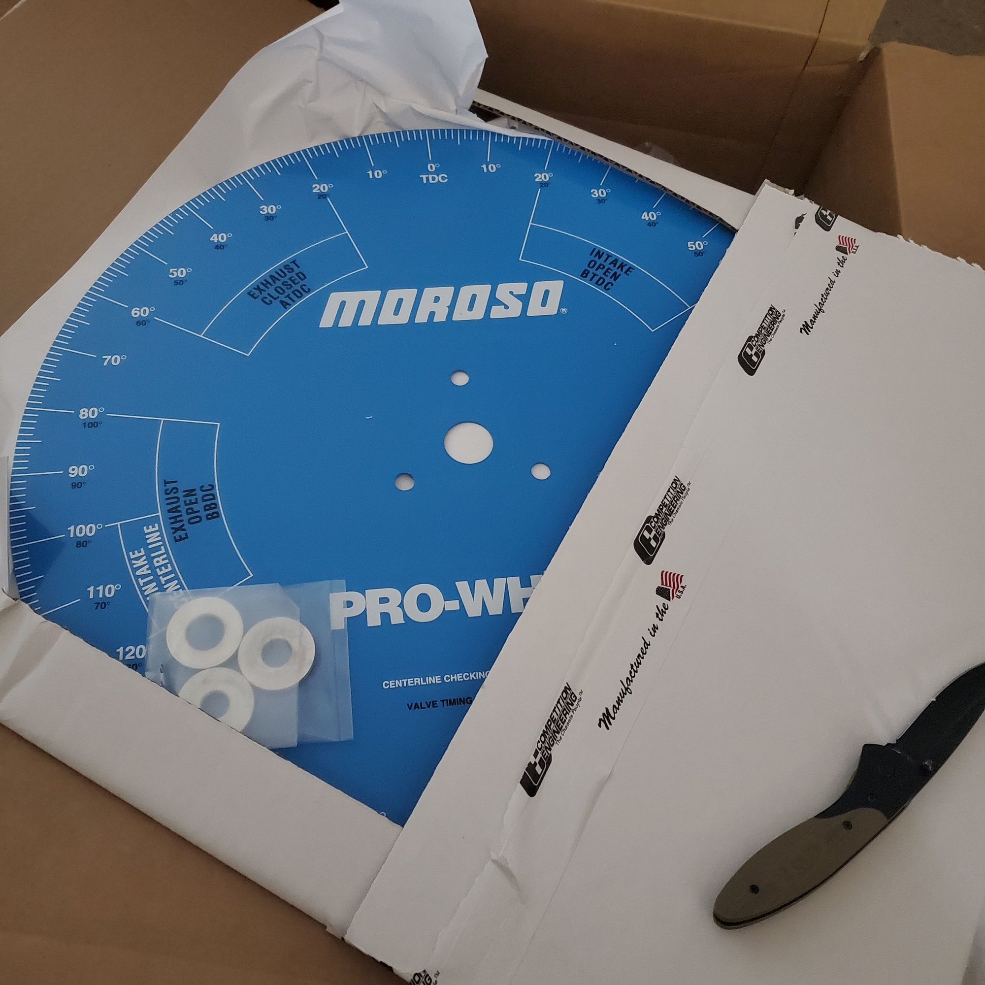

Christmas came a day early to my house today. Brown Santa dropped a bunch of boxes off on my front steps for me to get to open and then play with my new toys.
First on the list was a Moroso 19" Timing Degree Wheel. I have a Summit 11" wheel but for us OLD farts this one is a lot better.

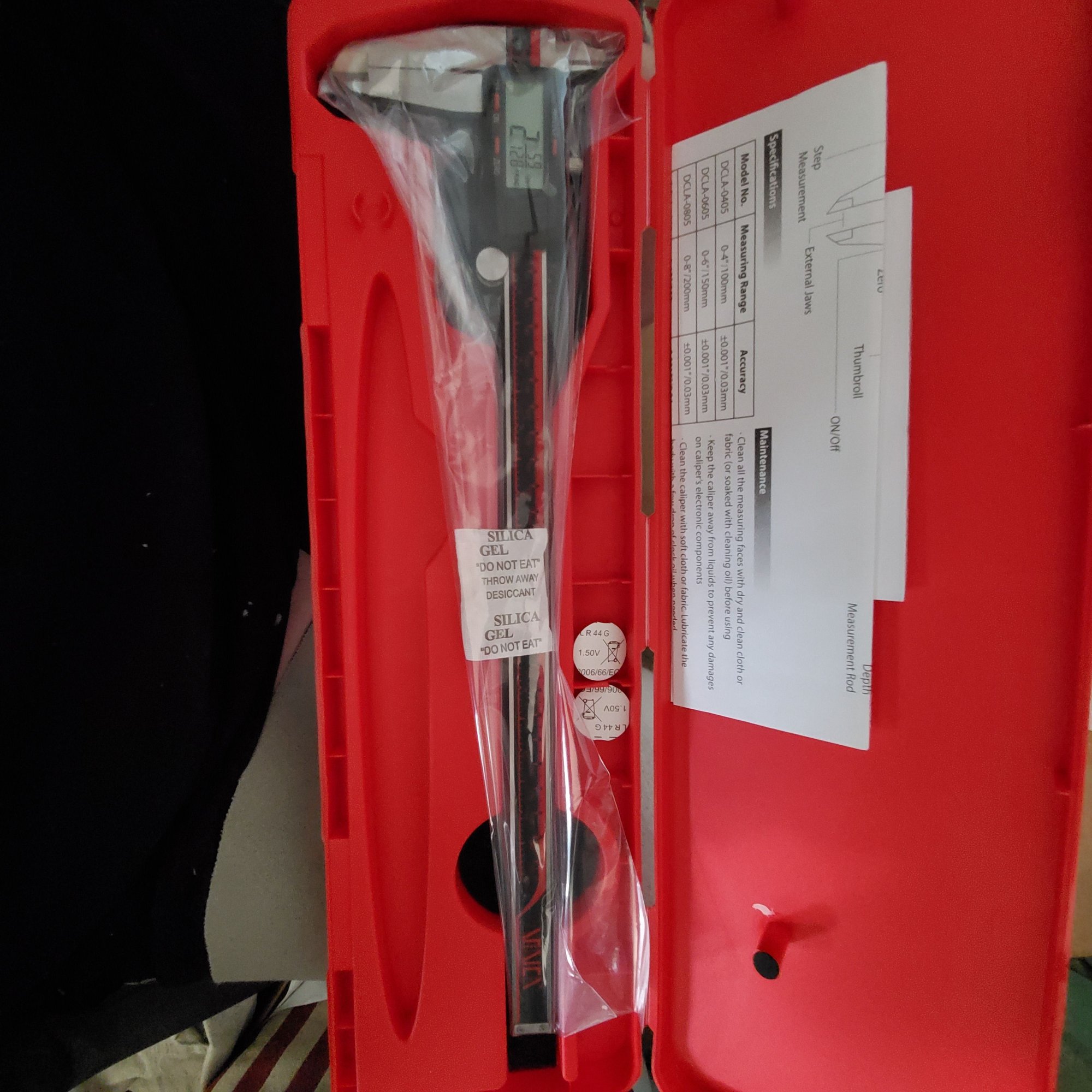

Next was a 12" caliper for measuring the length check push rods. They will be 6.8" or better so my 6" calipers wouldn't work so I got these.

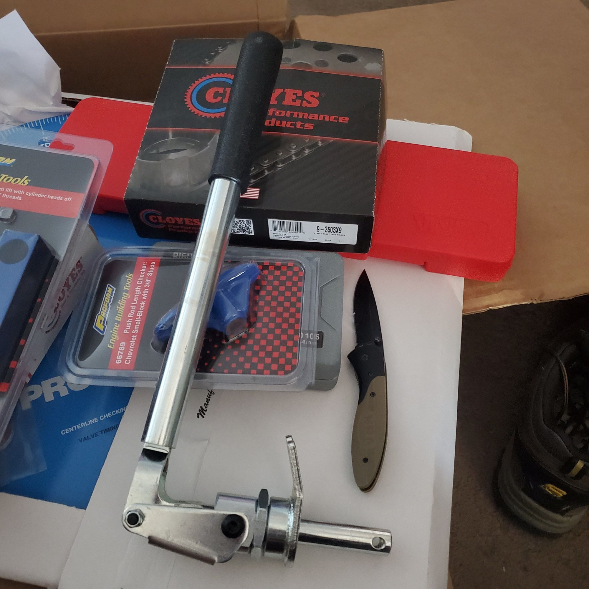

Then a Push Rod Length Checker that should really be called a Rocker Arm/Push Rod Geometry Checker. Just a side note here. Many items that fit/work with a small block Chevy will also work on our engines. And I have 3/8" studs for my rocker arms.

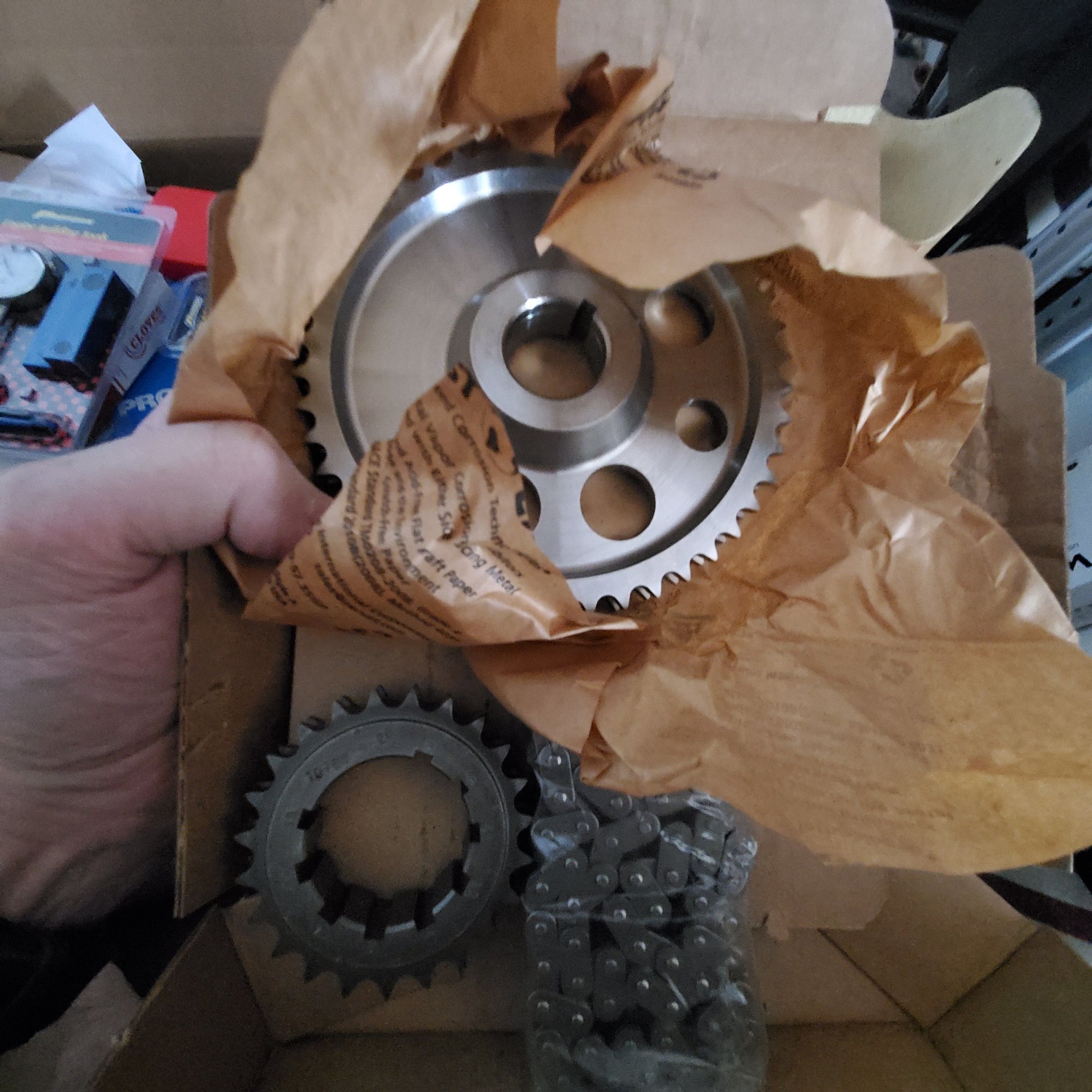

New Cloyes timing chain with 9* of adjustment on the bottom gear.

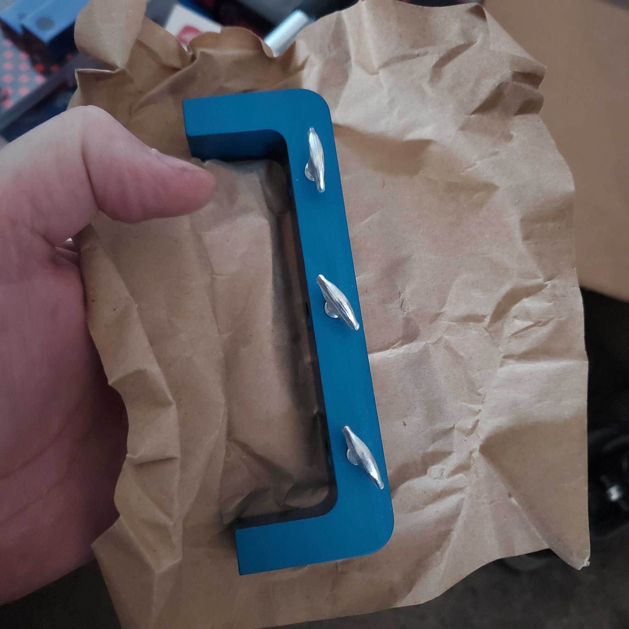

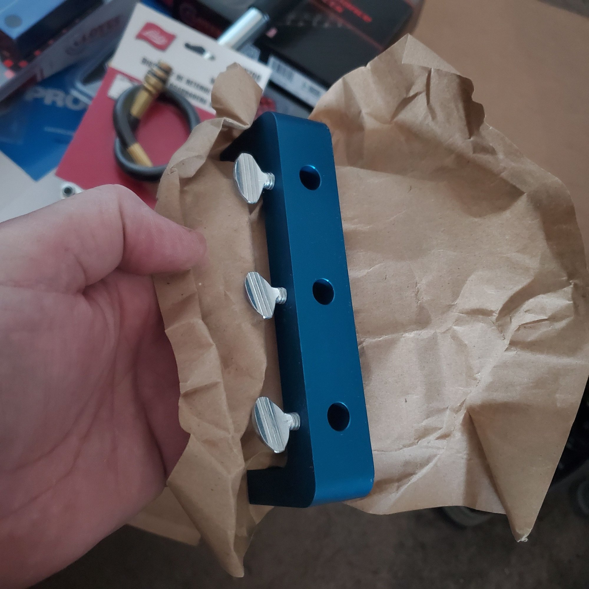

Block Bridge for holding the Dial Indicator when degreeing the cam.
I always enjoy getting new tools to play with and while I don't rebuild engines every day all these tools will be helpful as I rebuild this stroker engine.

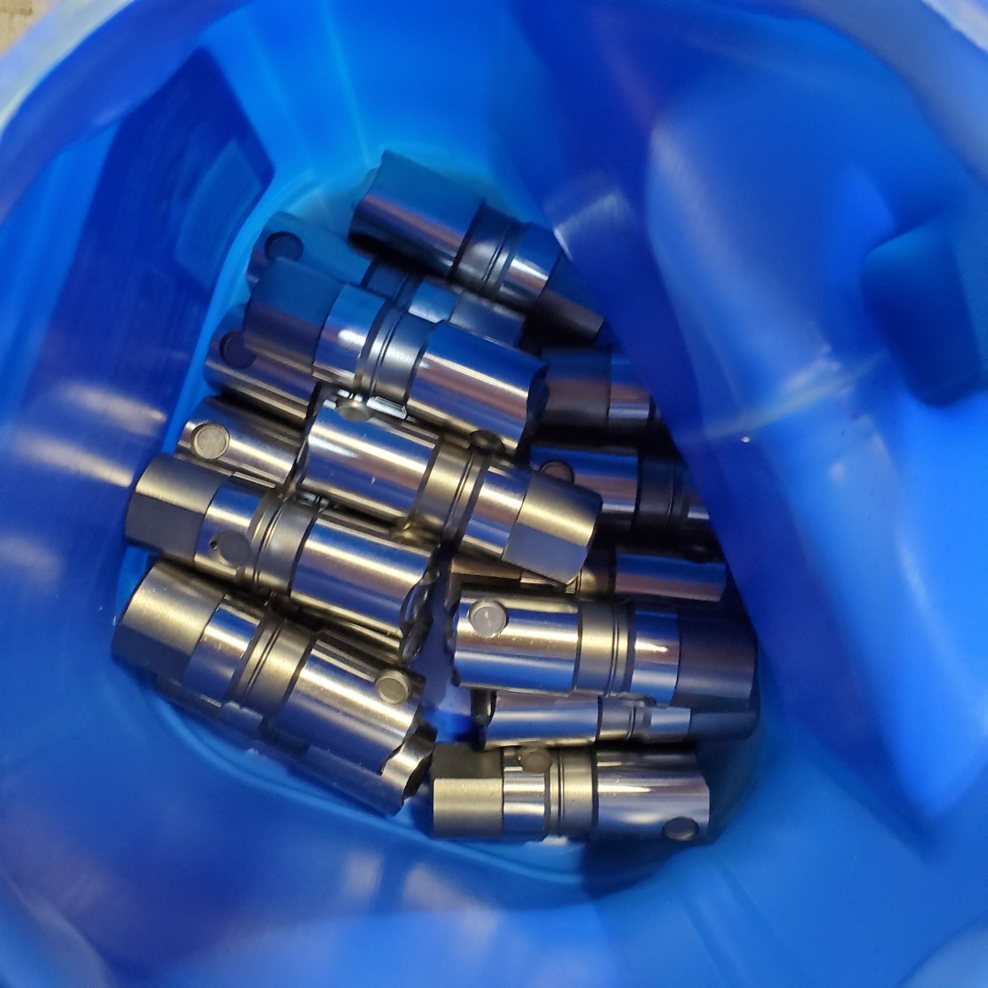

Then I got out the new hydraulic roller lifters and dropped them into the other recycled coffee can.
I forgot to take a pic of oil on the lifters but you all get the idea.

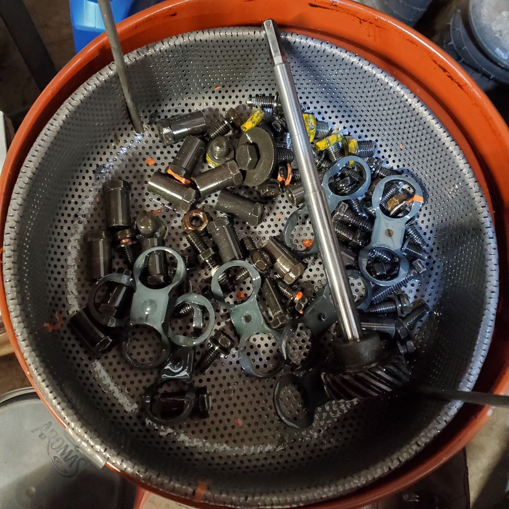

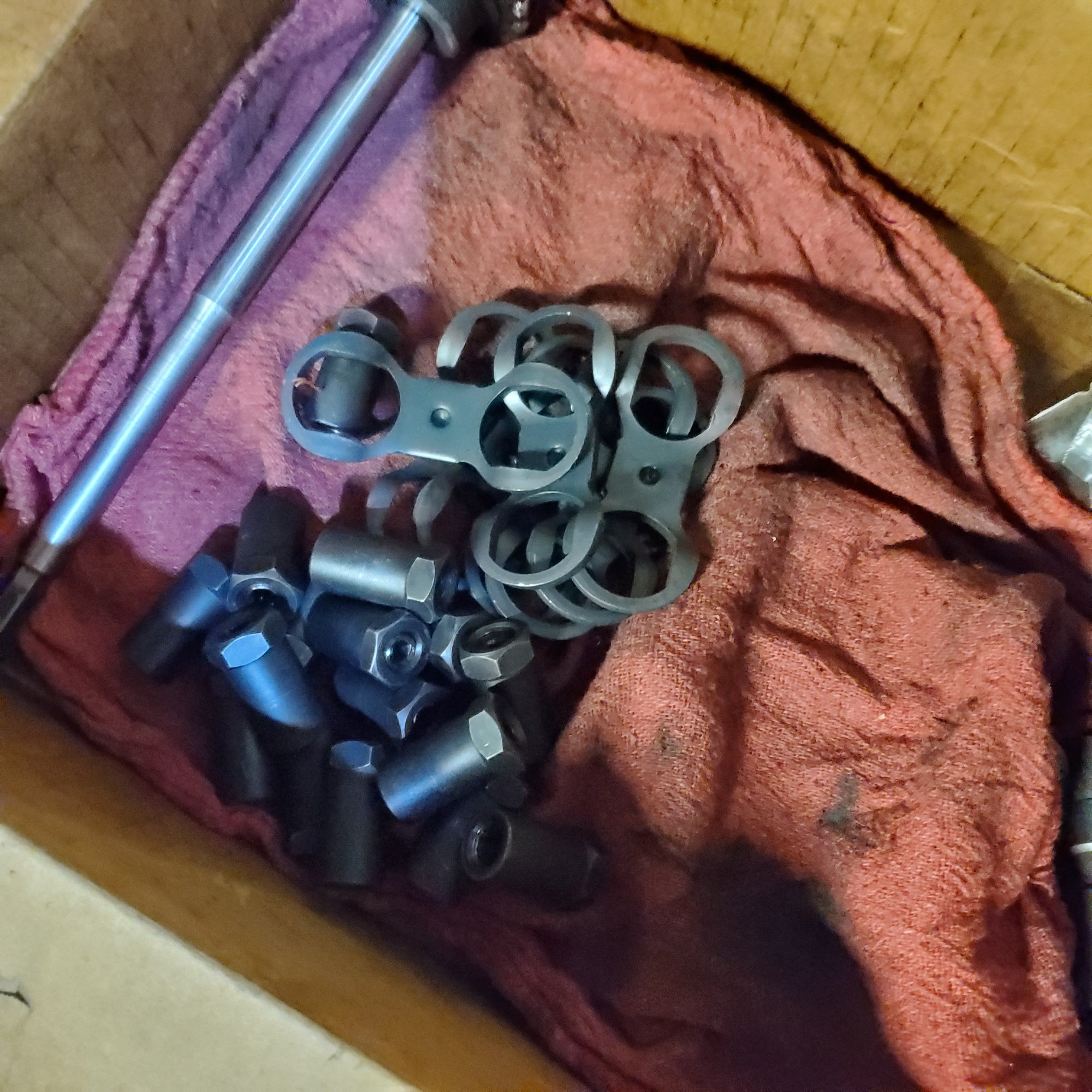

Got more done yesterday but none of it was exciting.
I worked on all the parts & fasteners that I'd put in the carb cleaner the day before. So I pulled them back out and wiped them down. So here is the stuff clean.
And then the next batch of parts and fasteners ready to get soaked again.
The rocker arm lock nuts & lifter straps nice and clean.
All the nice clean bolts.

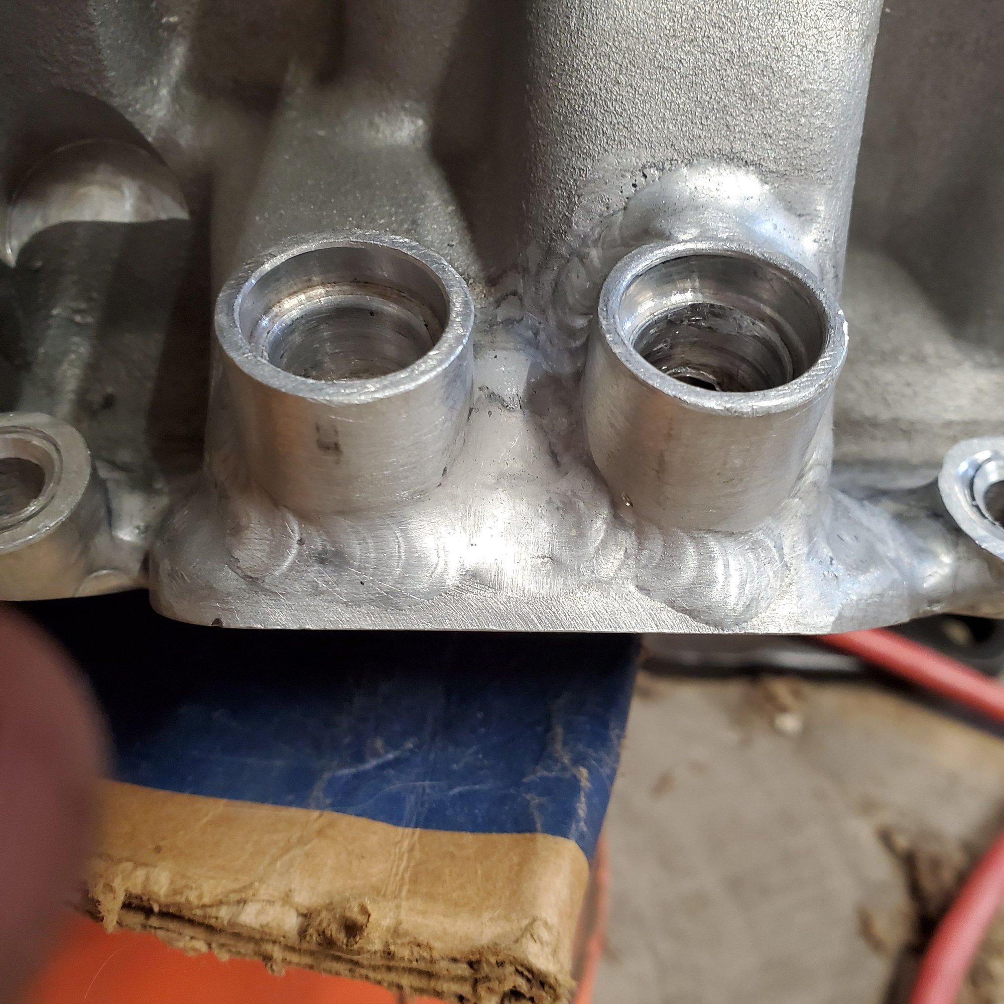

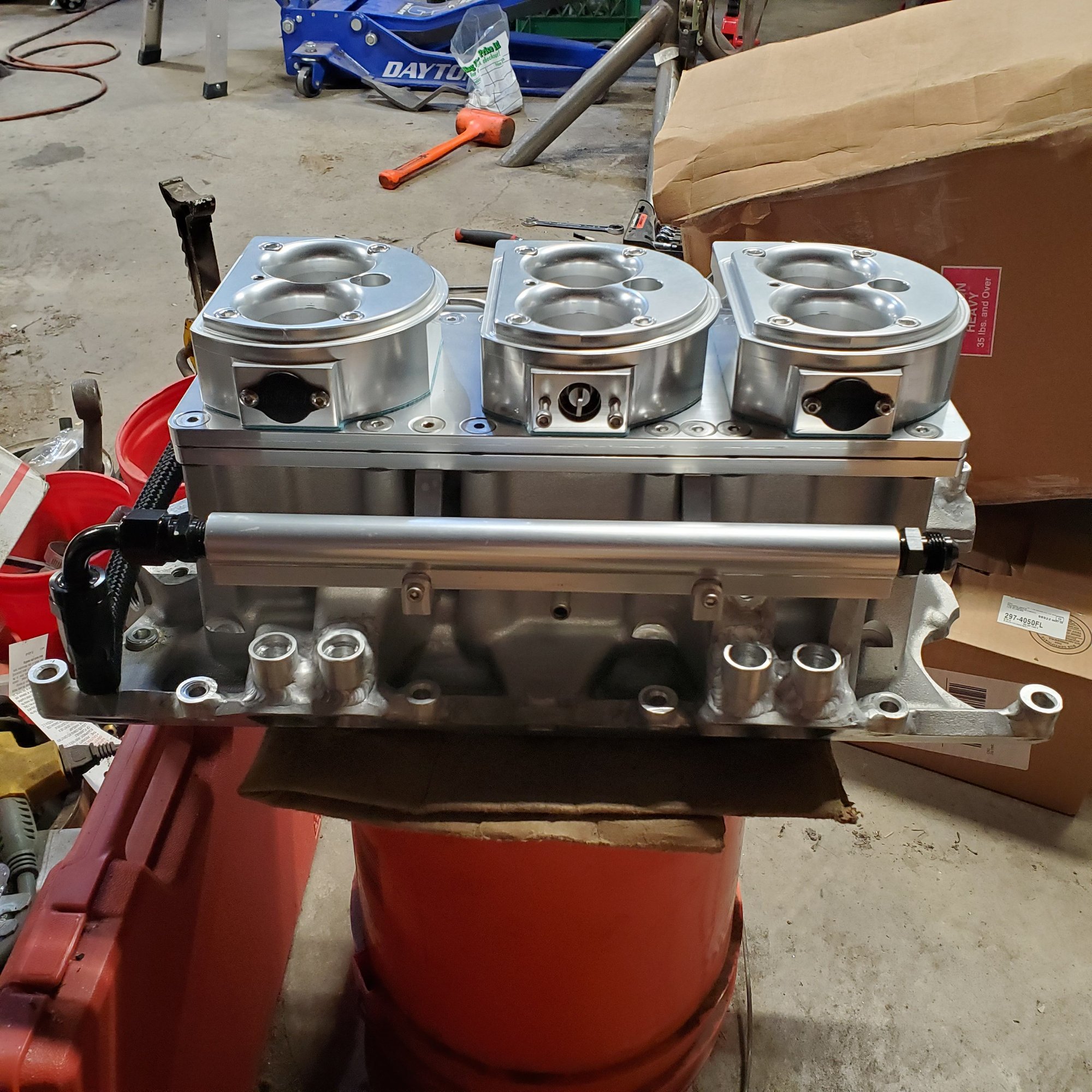

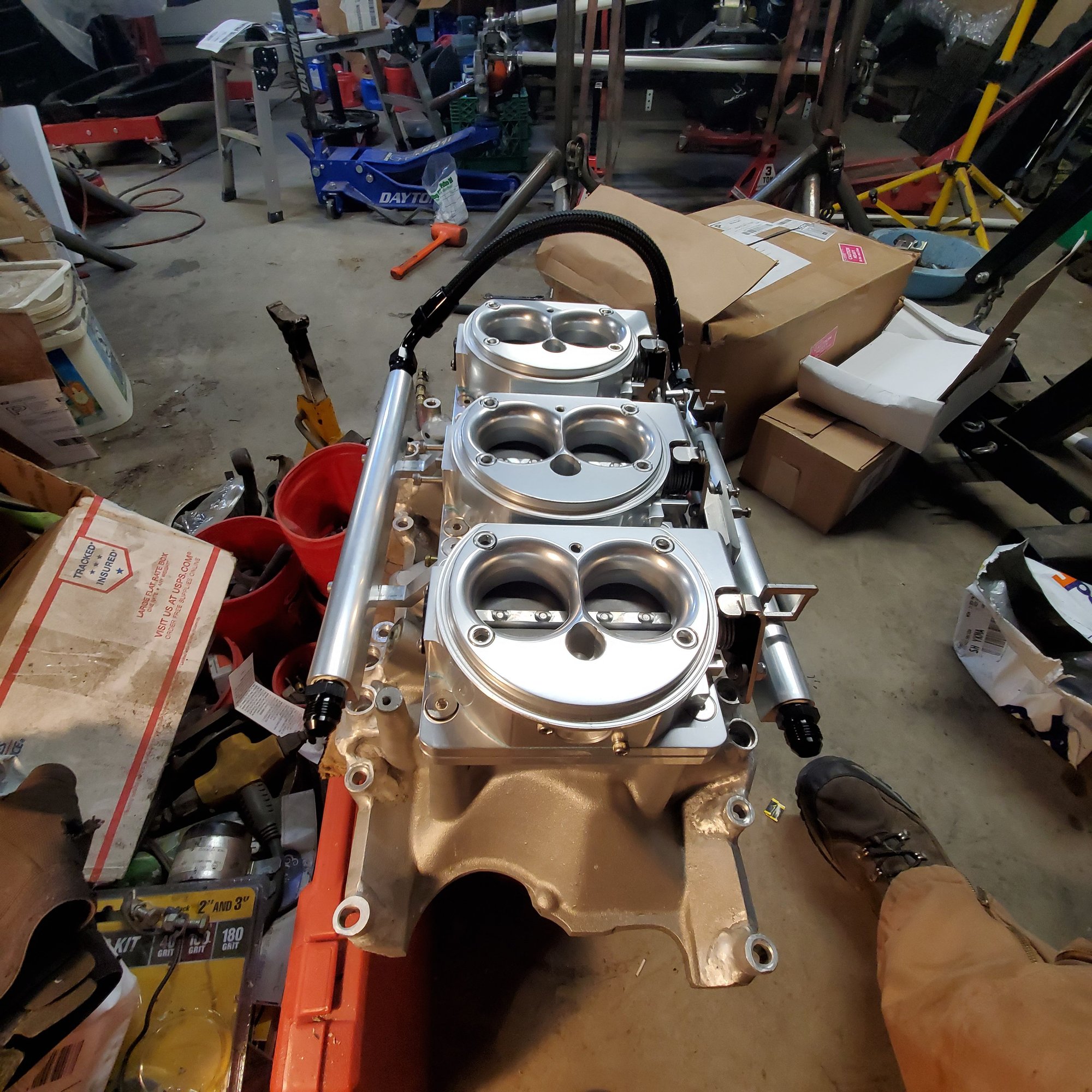

Then for a little inspiration I got my intake out just to look at a few things. Now I don't know about anyone else but that is PURE SEXYNESS.............
I can't wait to get this installed and here that engine purrrr
Then with the air cleaner installed.
Dang Nab that just looks sooooo great.
The intake F&B uses for this is a carbureted intake that they have added the fuel injector bungs to.

Add anymore stuff to that manifold and you’ll need a crane to get on the engine
