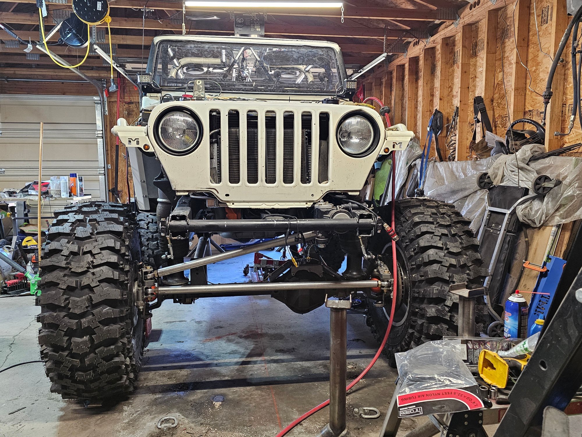

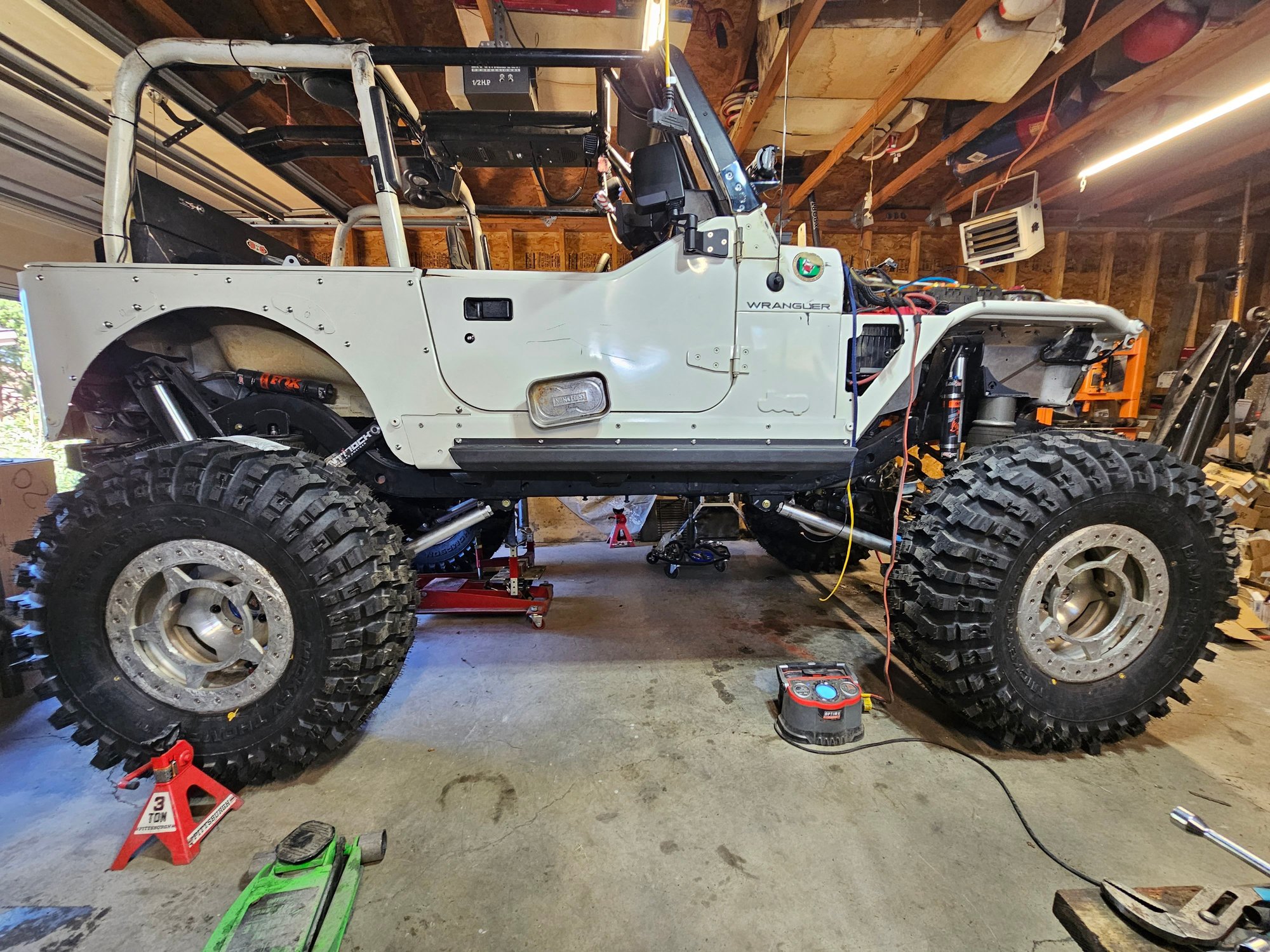

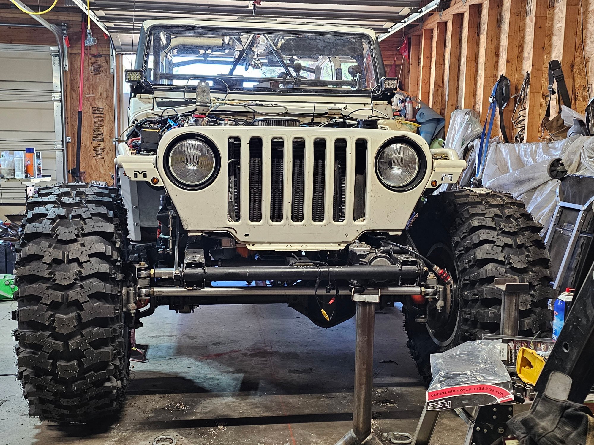

Here' a few pictures of the Jeep. When it's sitting on the bumpstops the frame is 19" off the ground and it has a 101" WB
A view from the front.
Then with the air springs filled up with air & it as high as it'll go the frame is now 28.5" off the ground.
Looks pretty good. Just need that new intake so I can take it out and drive it.

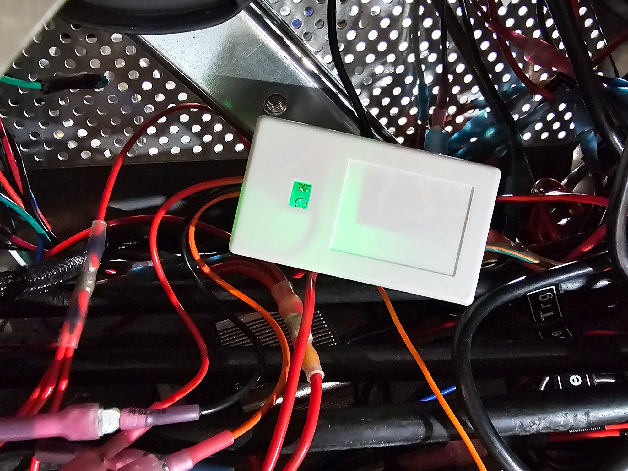

Finally got the box to put the self latching relay into for the O/D light. Got things all wired up and then installed it into the Jeep. It takes 12V supply of power & then the input from the O/D indicator wire off the PDC.
Works nicely.

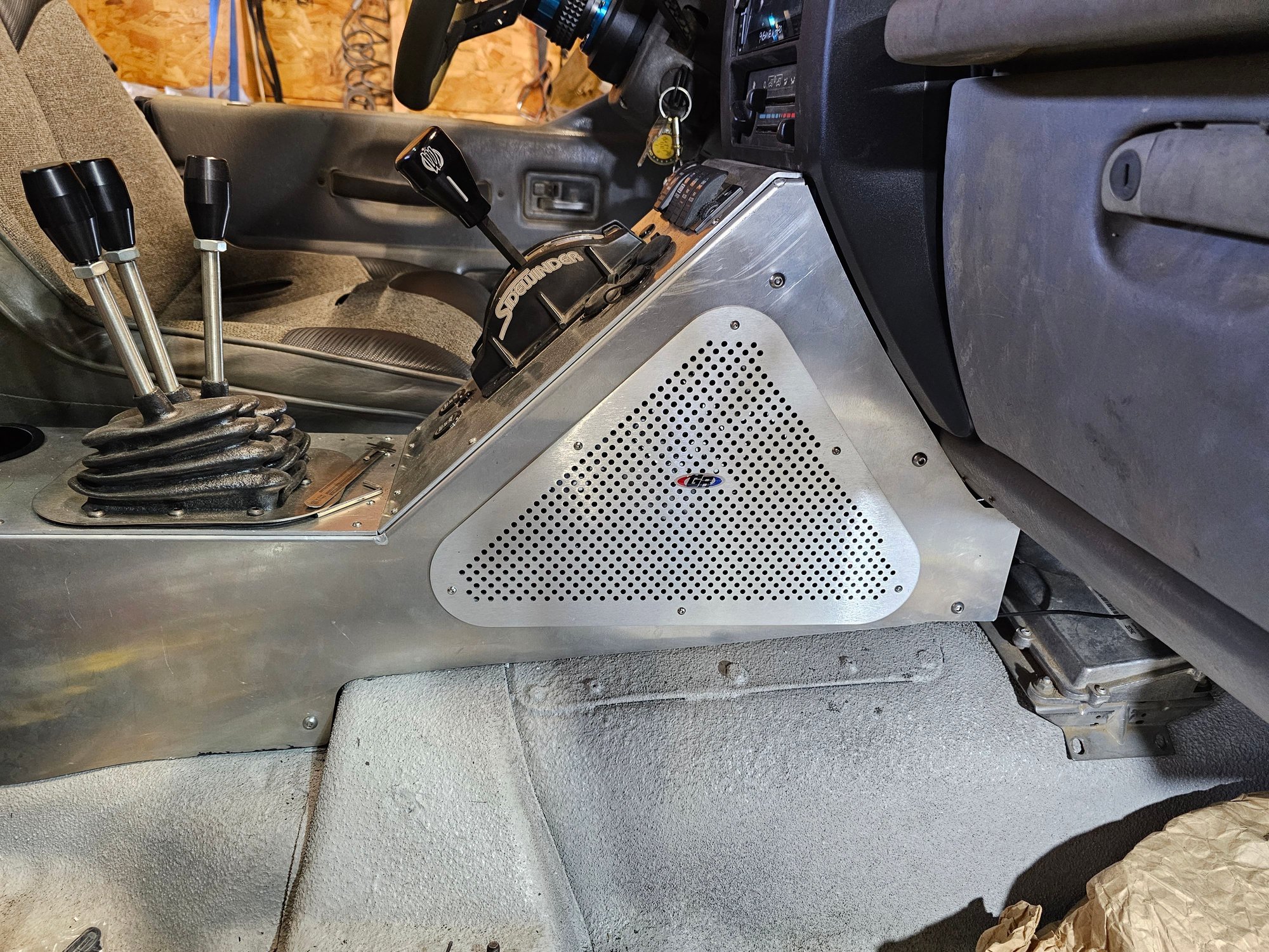

Then I installed the final panel on the center console.
Of course one I got it installed I remembered that I had one more thing that I needed to do inside the console so I'll have to take it back off.
Getting close to where I can install the passenger side seat and will just about be done with the interior.

Love the Winters Sidewinder shifter! I run a similar model Winters shifter in my '69 Dart.
