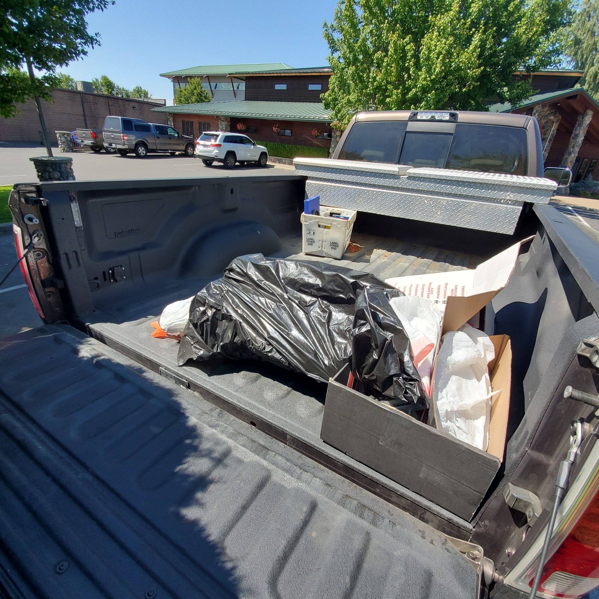

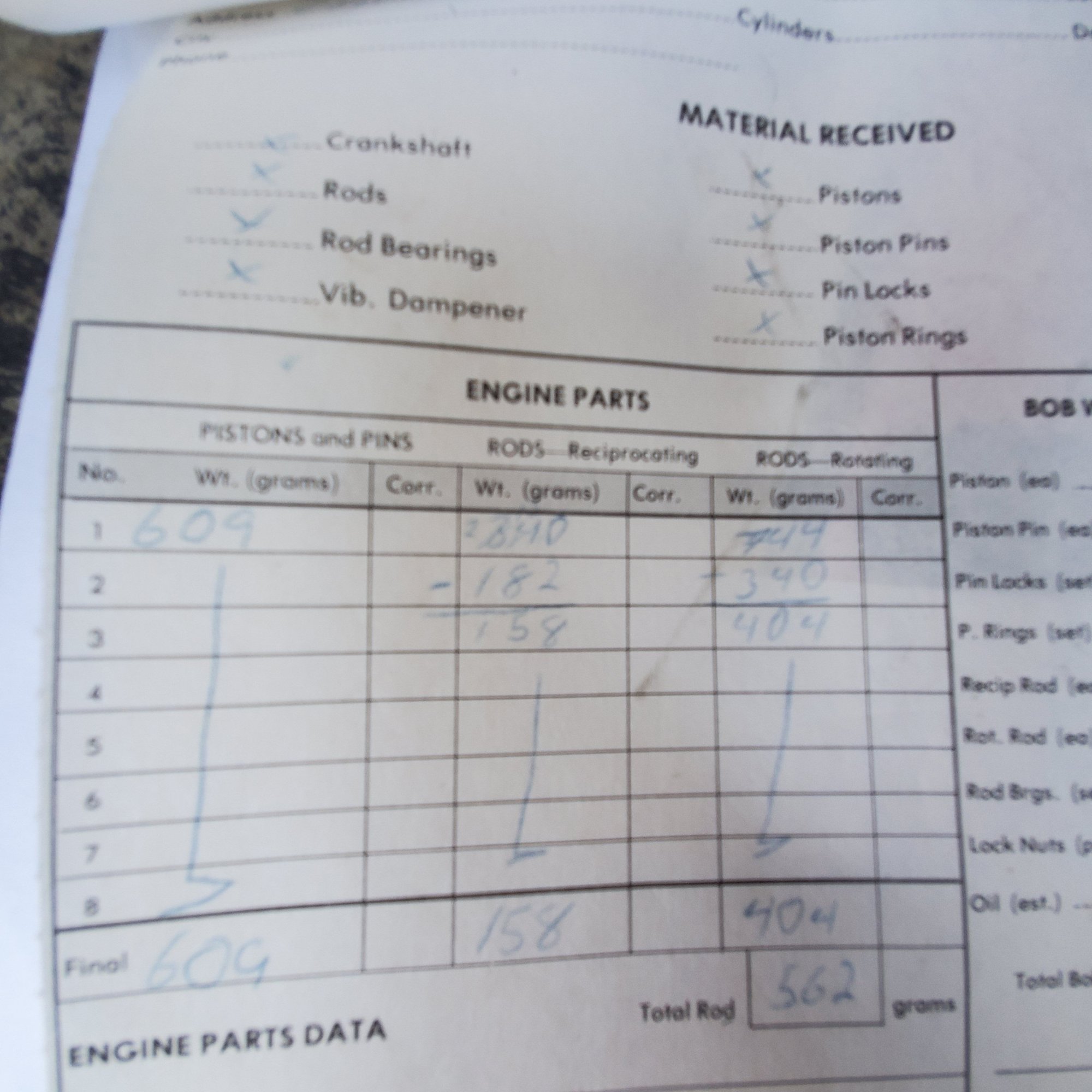

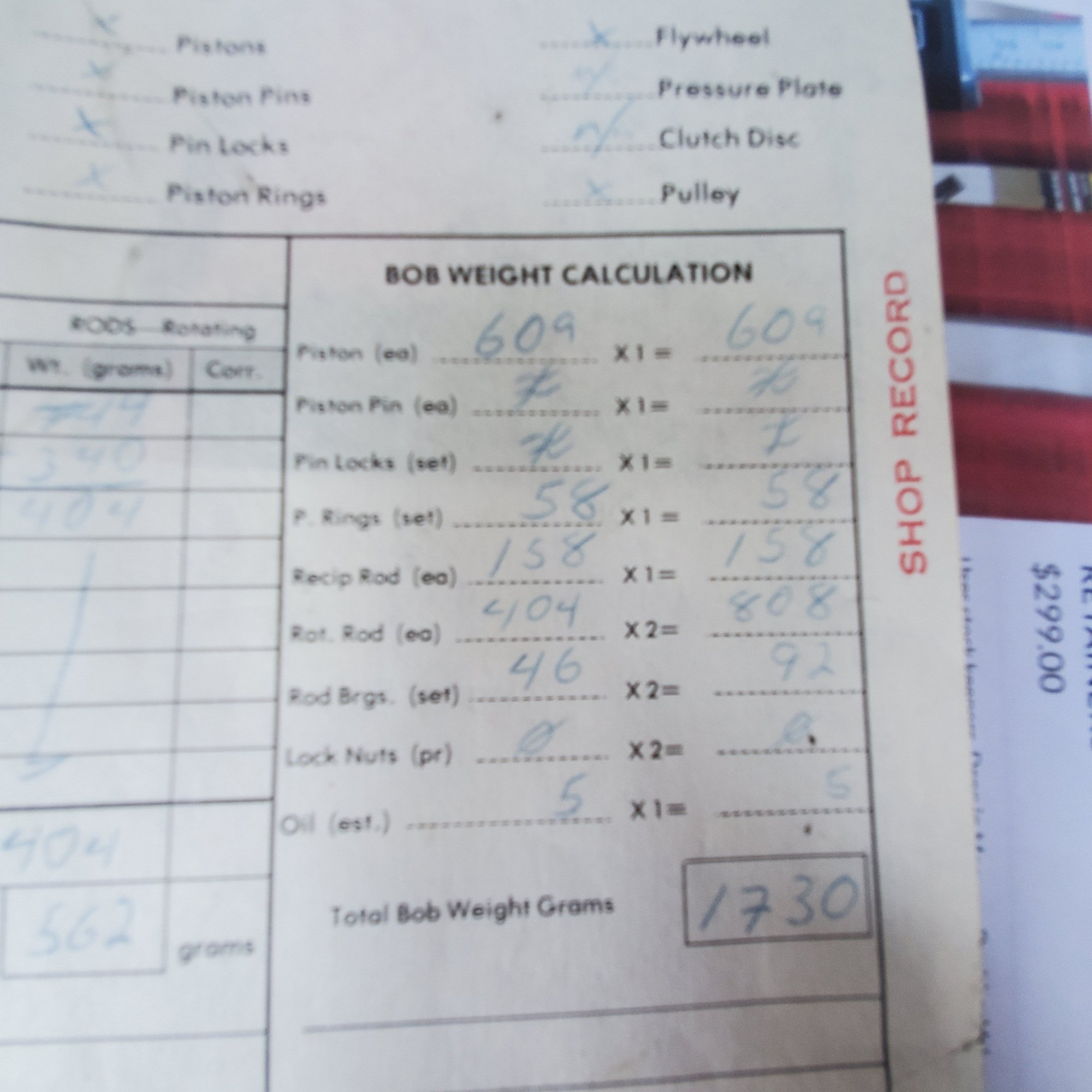

Okay it's time to bring this thread back to life.
I picked the engine up from the machine shop on Monday. I am glad I had the engine gone through as the cylinders were out of round. It seems that the shop that had built the engine prior to this hadn't used torque plates. The next problem was that the pistons showed sign of being overheated. And then the crank was out of balance also. Here are the sheets from the shop showing the balance on the crank.
