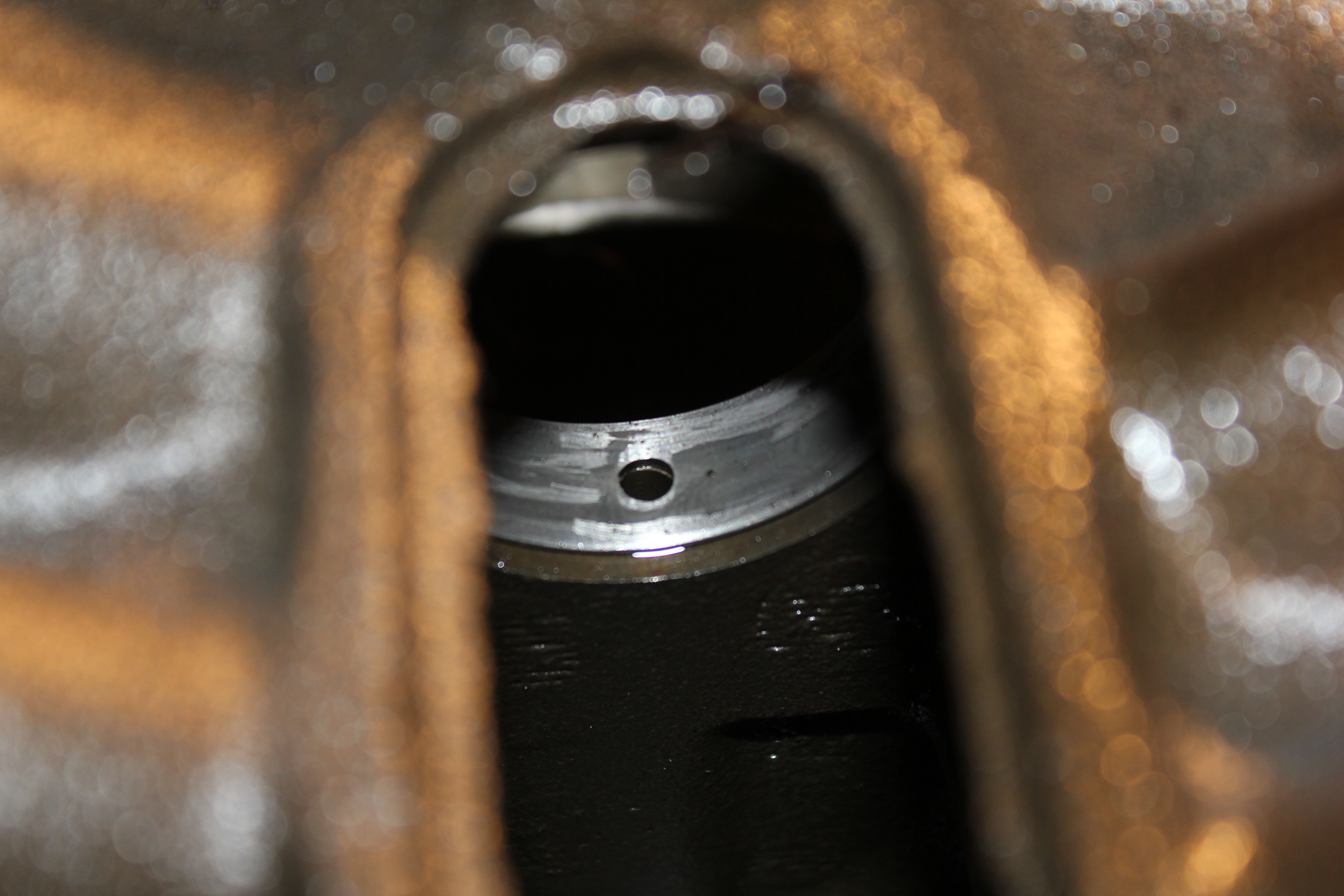

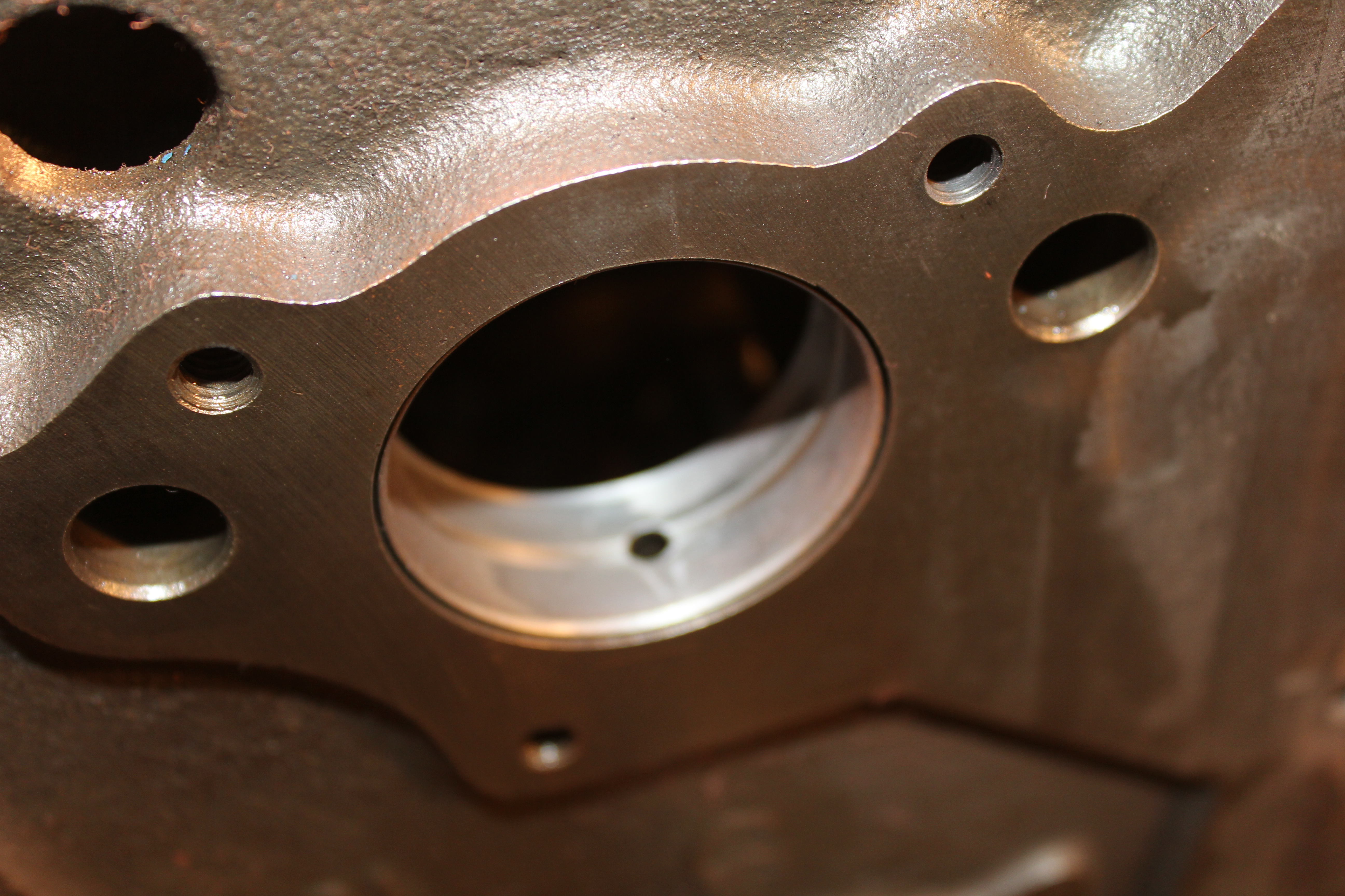

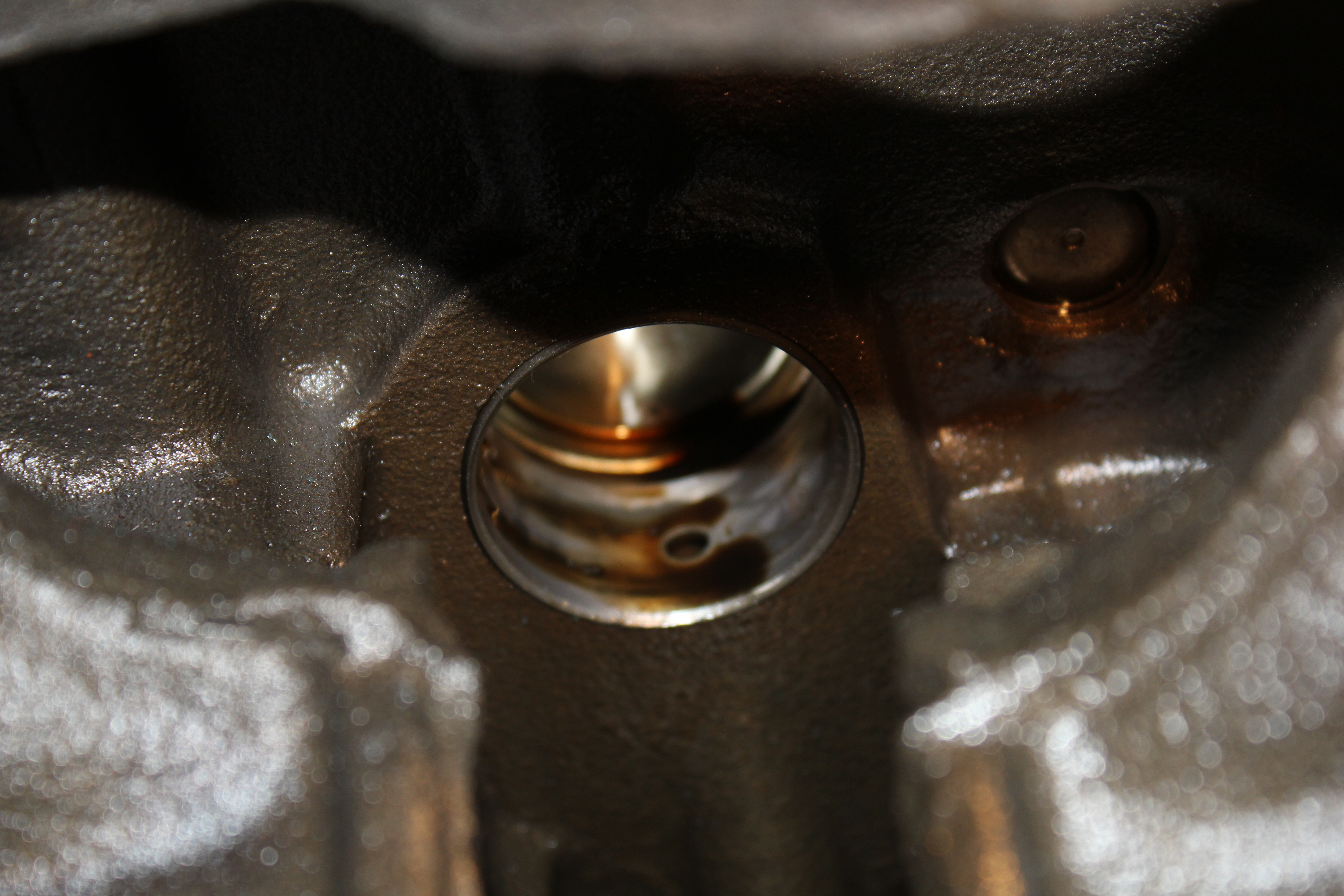

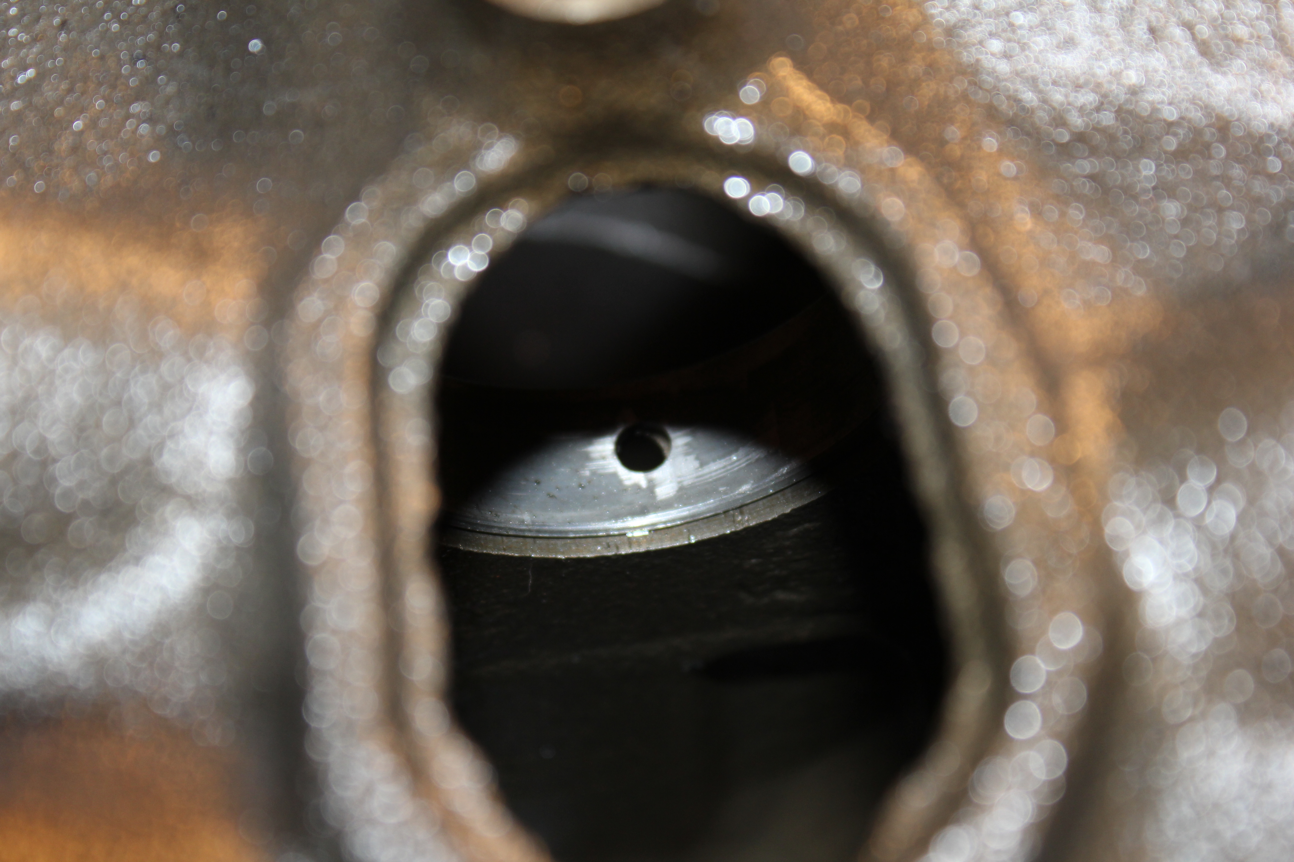

Ok here are the pictures of the cam bearings.

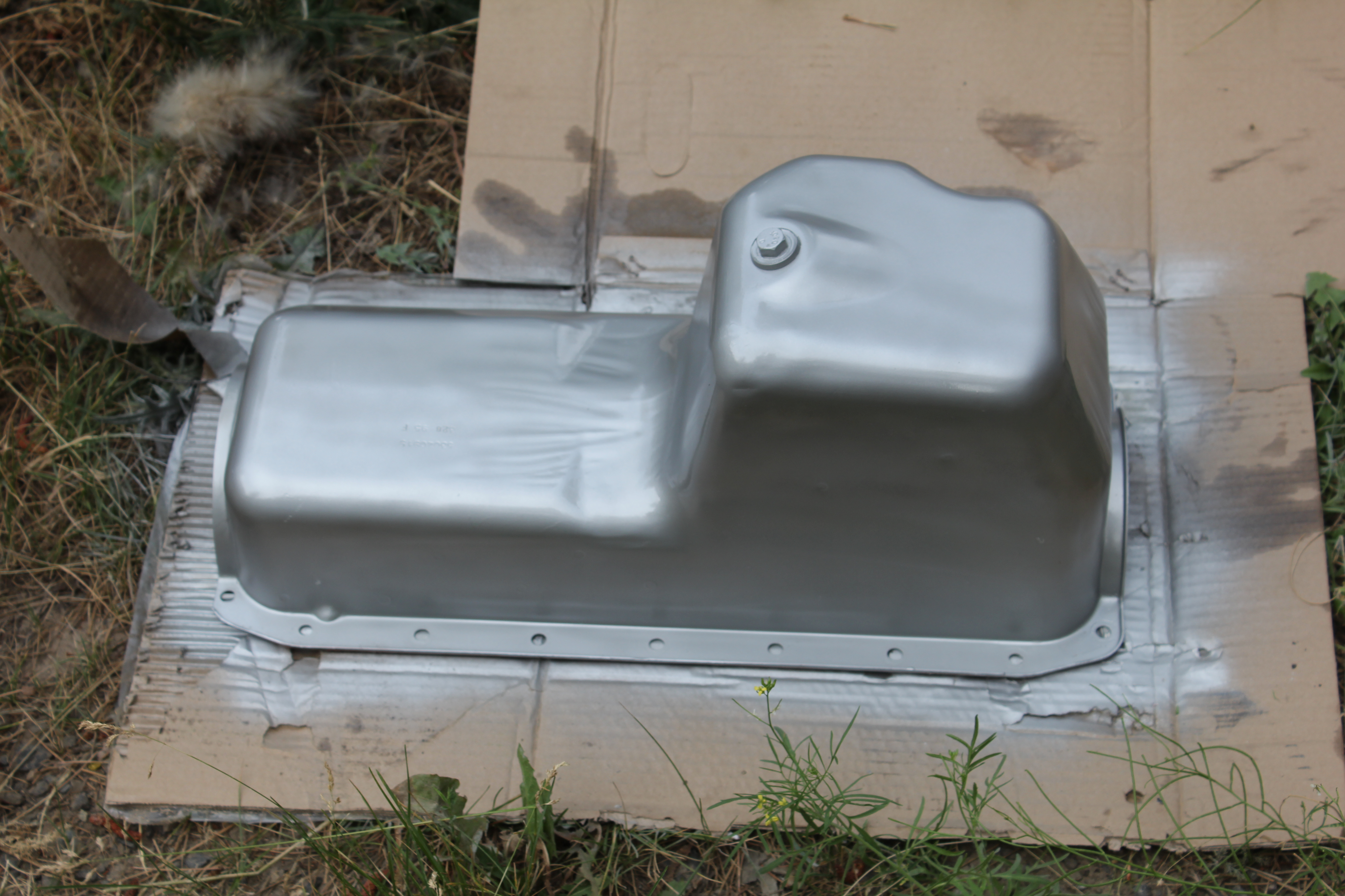

And here is the oil pan repainted after I used it to cover the bottom end of the block.

I think I would replace the bearings just on general principles. In the overall scheme of things, they are not that expensive..... and I would look at it as 'cheap insurance'. Some of the cam bearings appear a bit more scuffed than I would be comfy with......
You have the engine out NOW. You would be seriously bummed if you DON'T change them, and then have an issue in a few thousand miles......

Magnum cam bearings almost always look hosed. But really it's a cam bearing and isn't even close to being as critical as a rod or main. But yeah they're like $20, so why not.

I think I am just going to replace all the bearings except for the cam bearings unless you guys feel strongly about me taking it in and having them replaced also. I also need to buy new rings as I broke one trying to take it off the broken piston. Is there anything I need to do to the cylinder walls before putting new rings on the pistons? I think I need to run my deglazer thru them but can't remember 100%.
