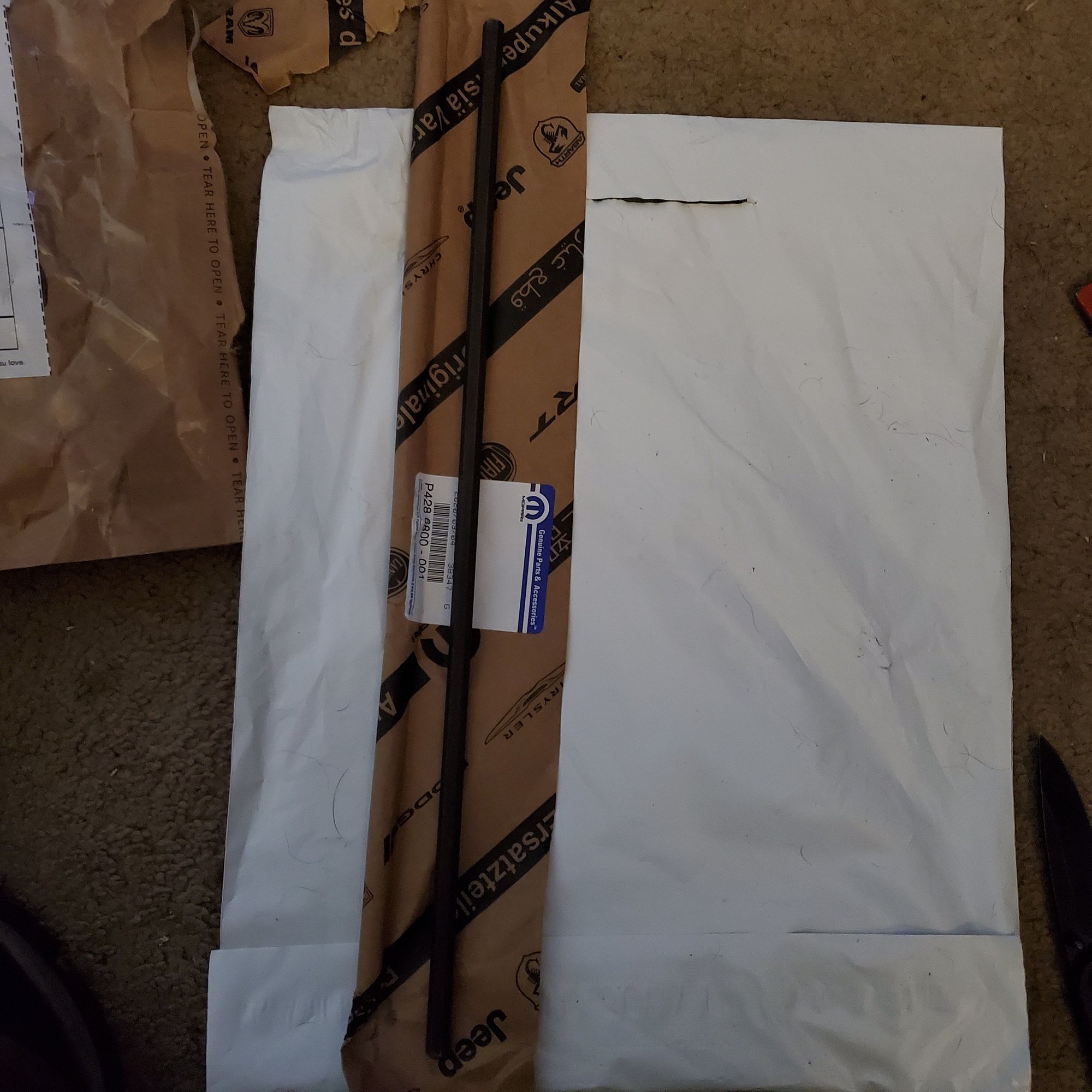

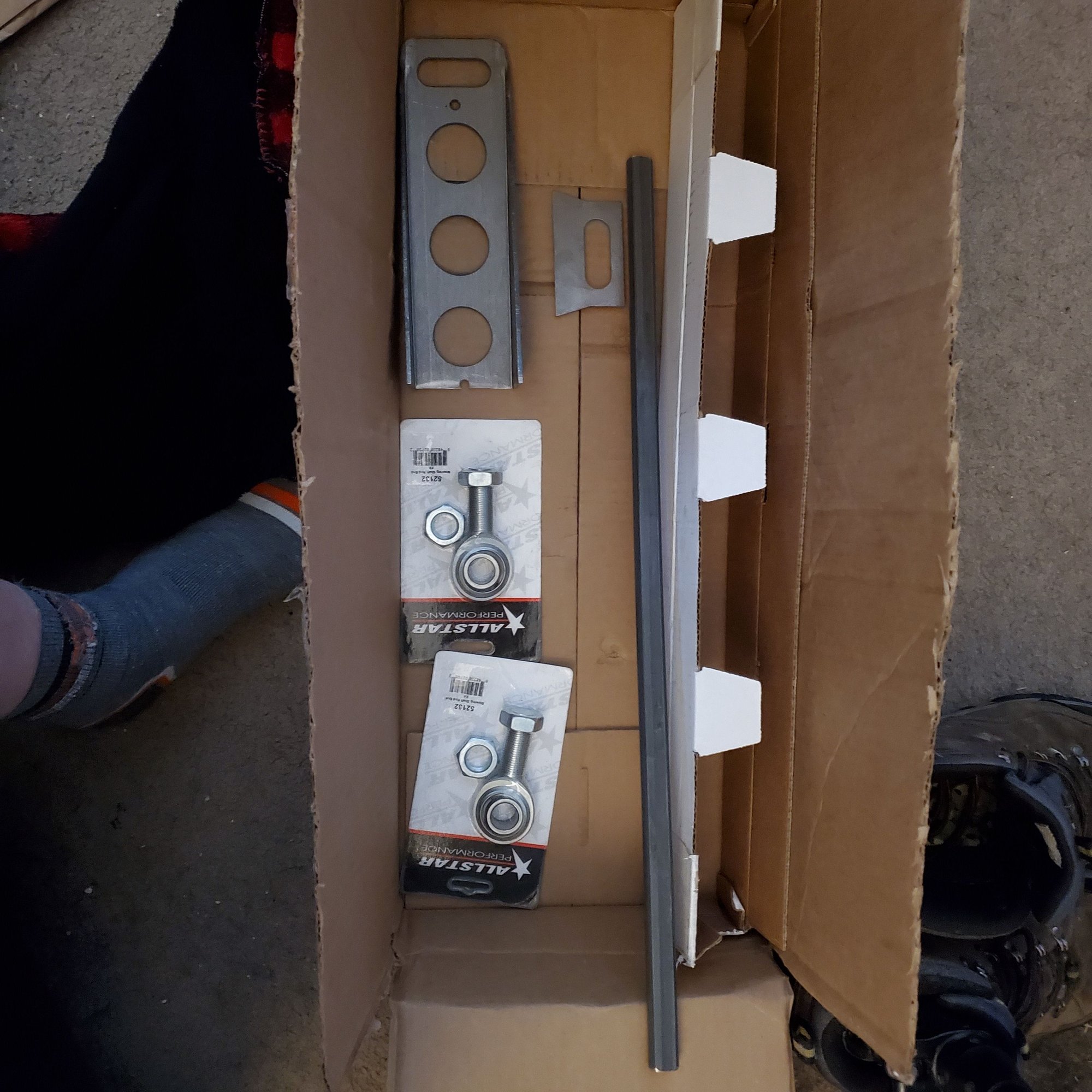

Not Gen 2 Ram related but I also got this steering setup for the Jeep becasue the old stock bushing had melted on my Jeep. A company called Red Rock OffRoad sells this steering shaft kit for their Hemi swaps so I don't see any reason why it won't work for my swap also.

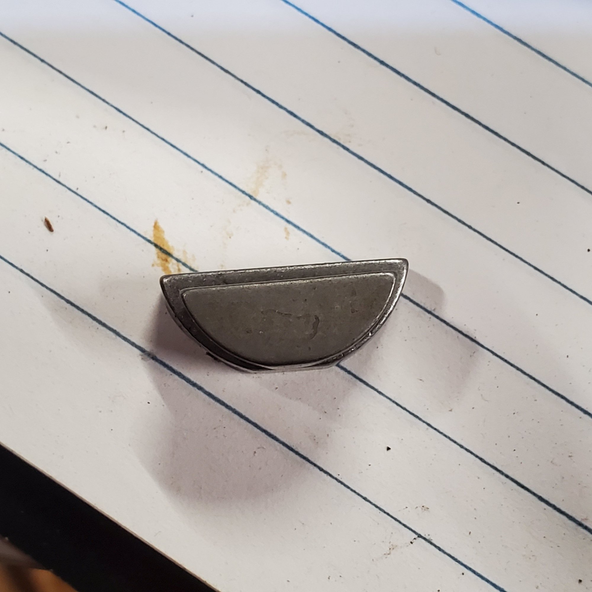

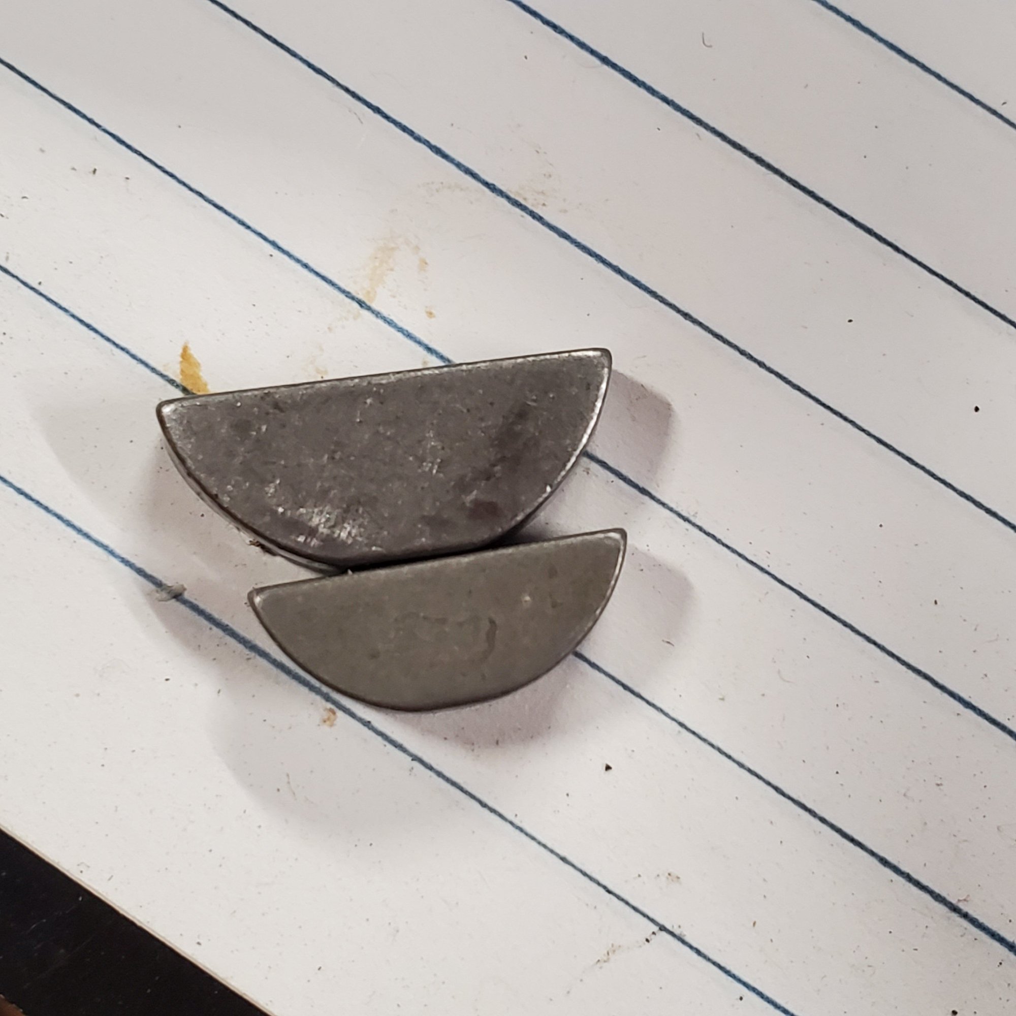

Finally got the woodruff key I need so tomorrow I'll get back to working on assembling the engine.
The one on top is the one I'd found online that was suppose to fit and then the lower one is the actual one I need.
And then the key I needed on top of the one from online that wasn't the correct size.

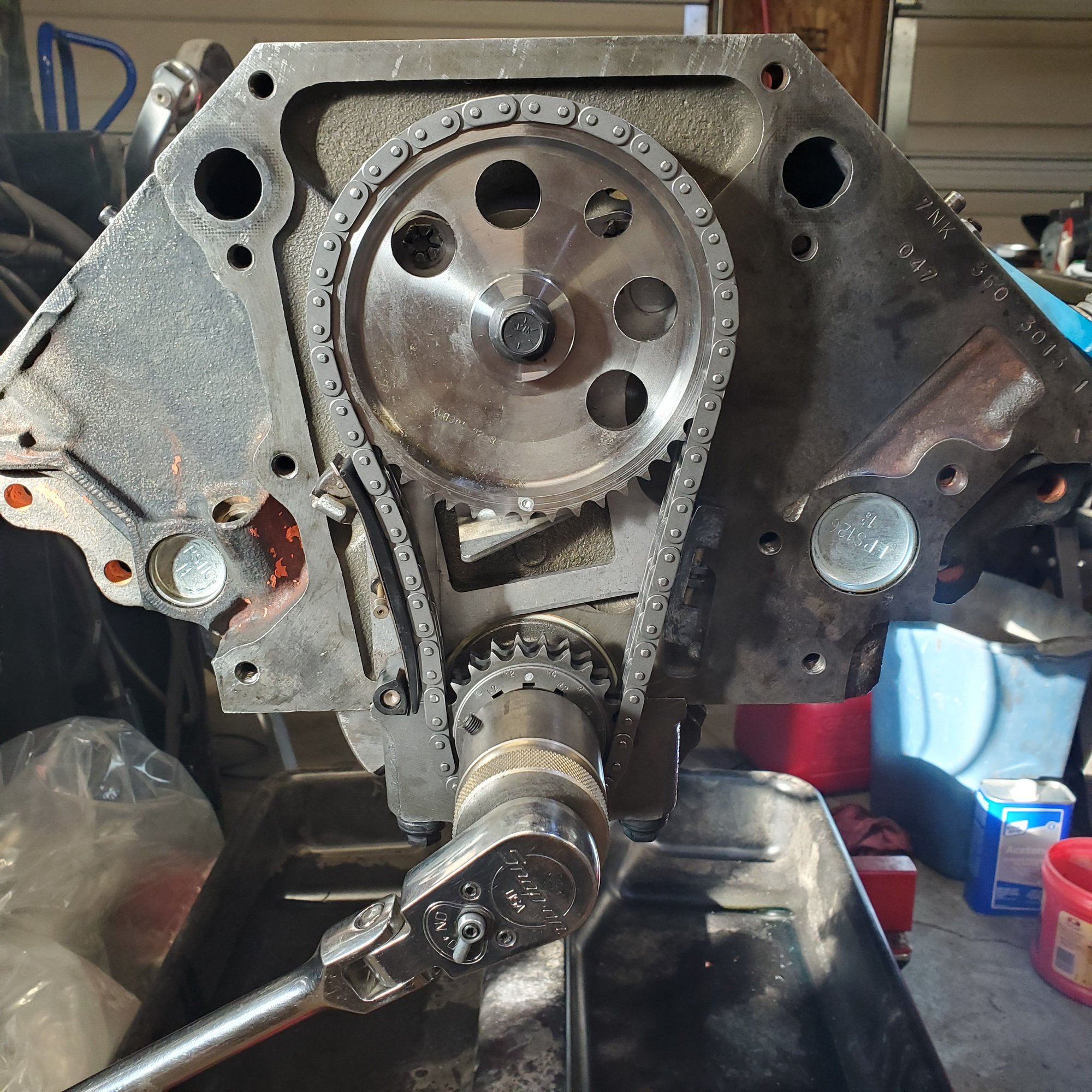

So I started on the engine assembly again today. Cam key got installed first.

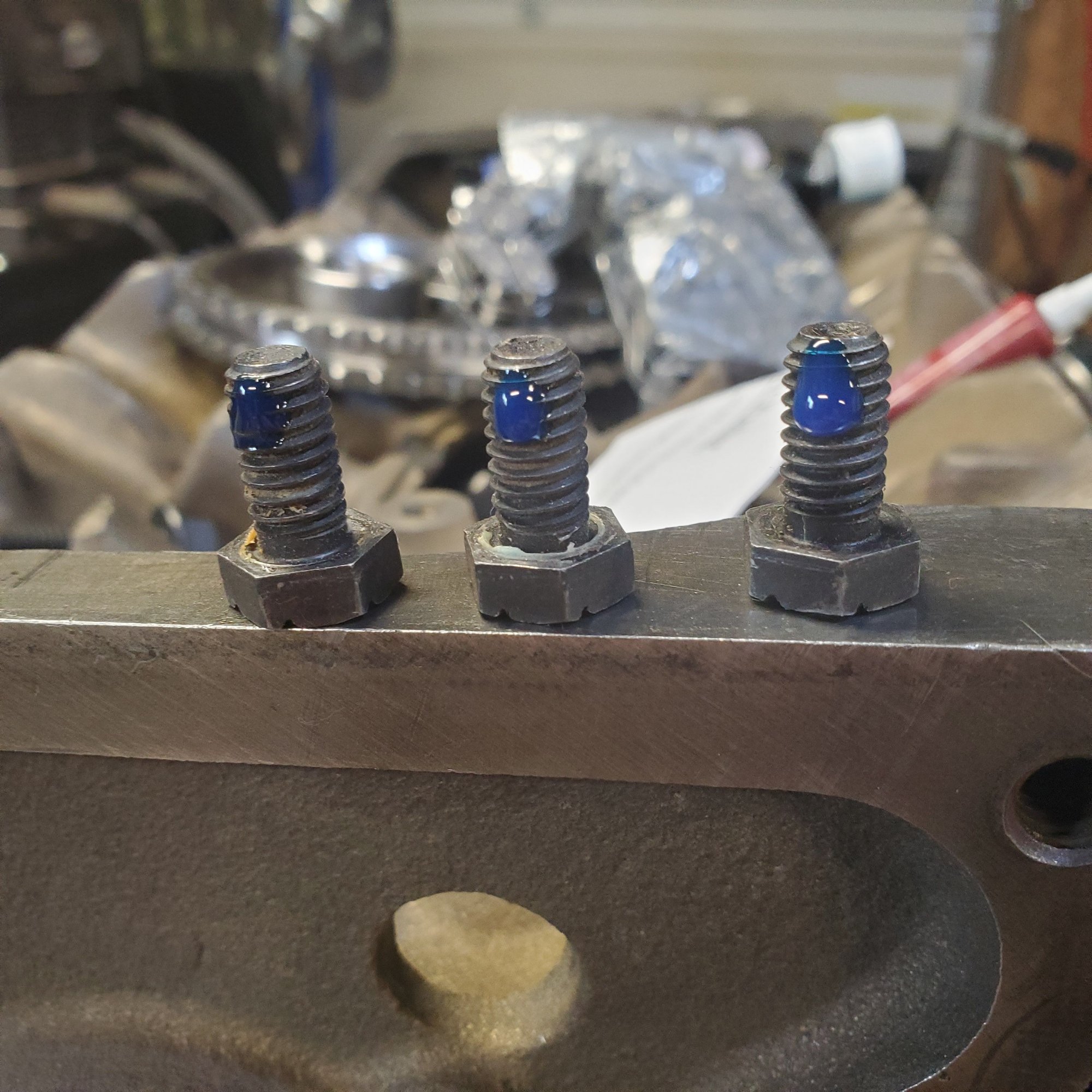

Then a little Lock-tite for the cam thrust plate/tensioner.
Installed the thrust plate/tensioner.

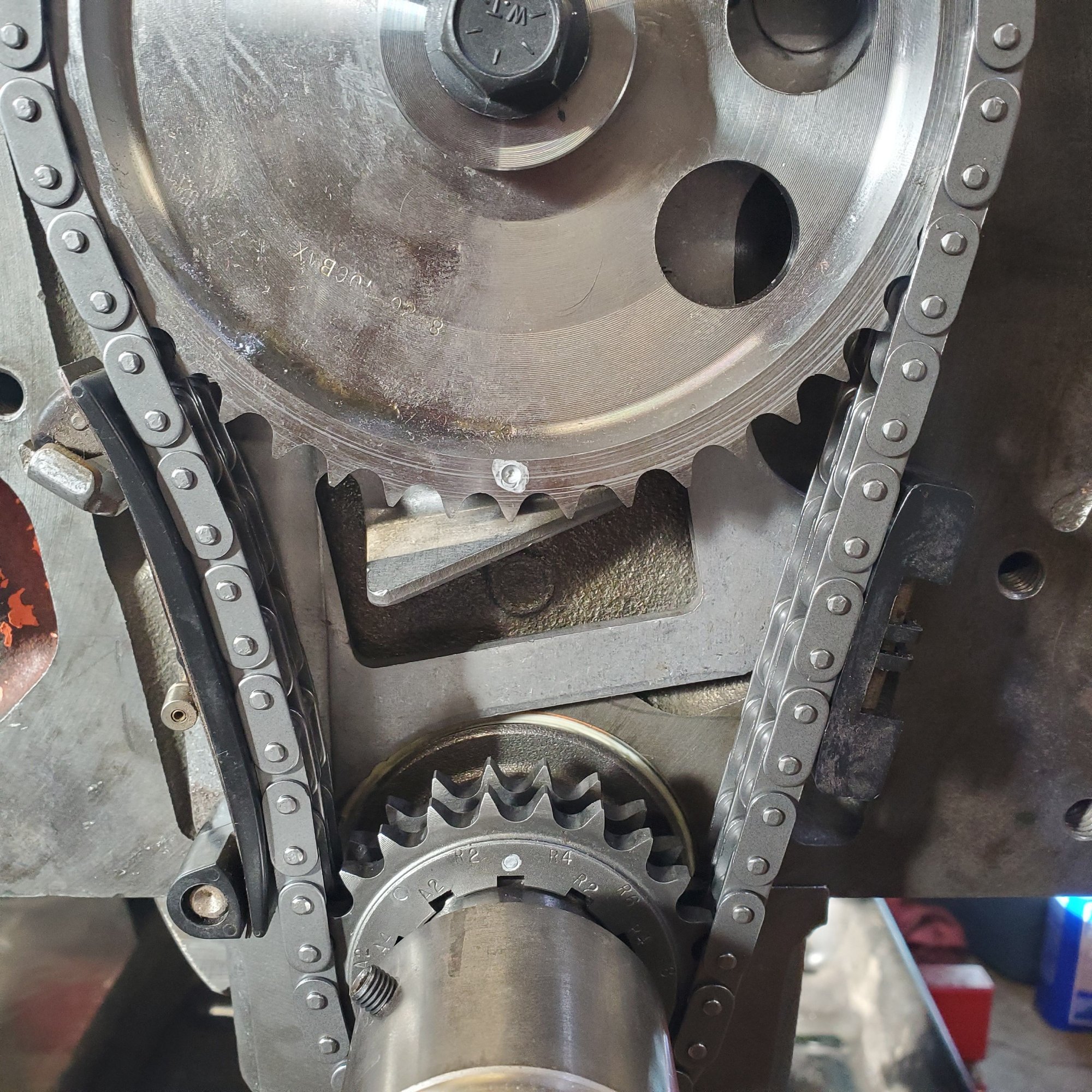

Then the timing gears and chain.
All installed

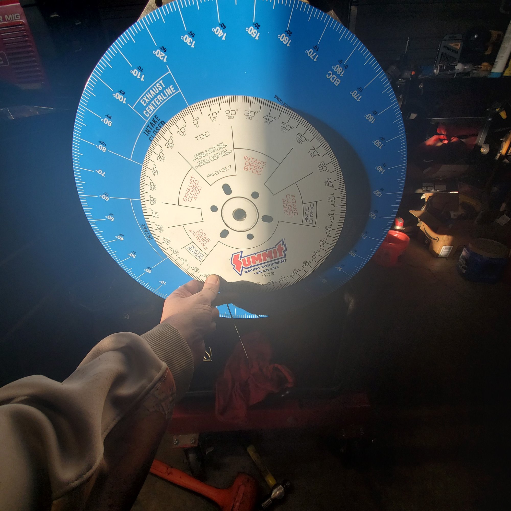

Just to show the difference between my old degree wheel and the new one. Yes the new one is for us OLD GUYS who can't see so good anymore.
Got the degree wheel installed and the pointer setup. The pointer is a old wire clothes hanger.
Ready to find TDC of my #1 cylinder.

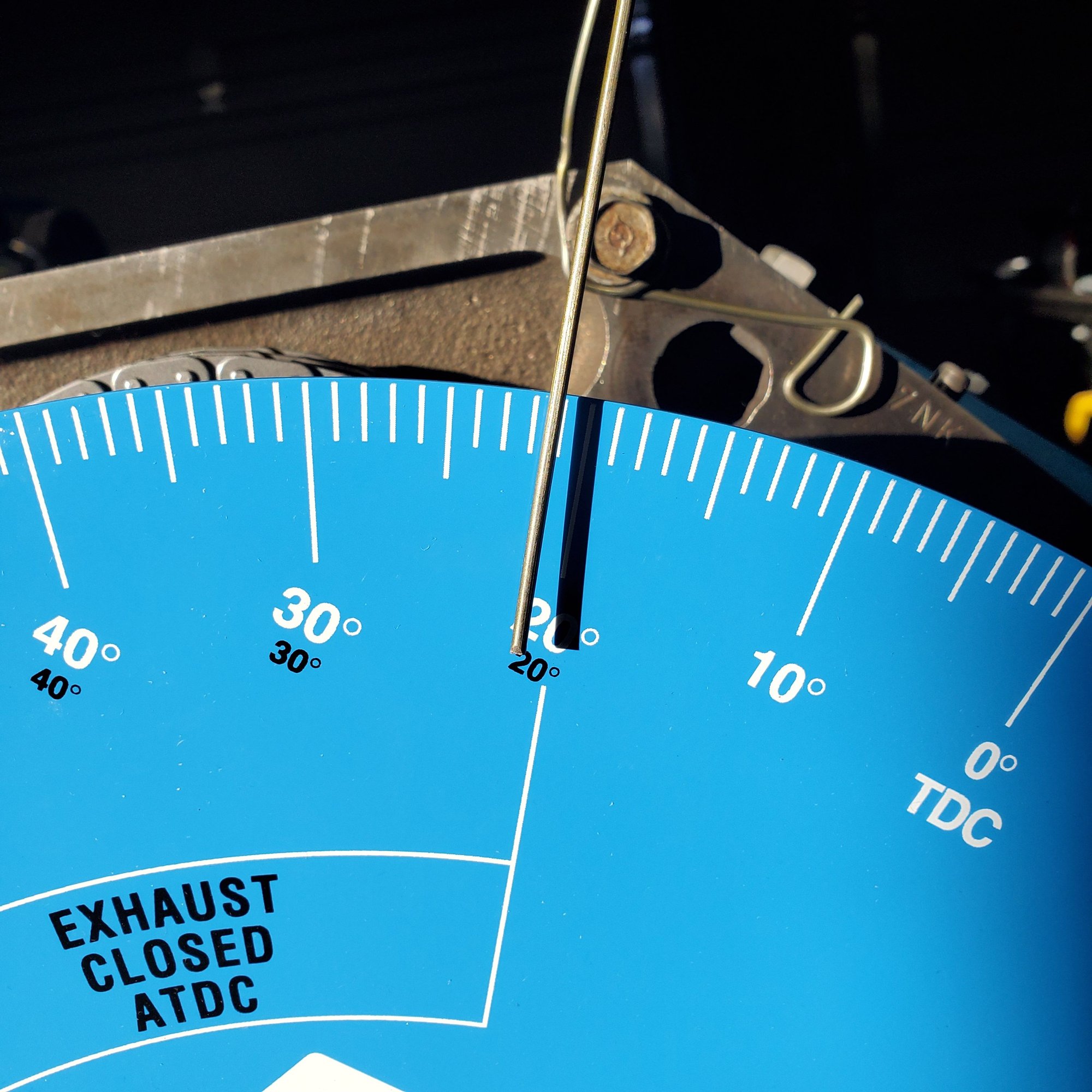

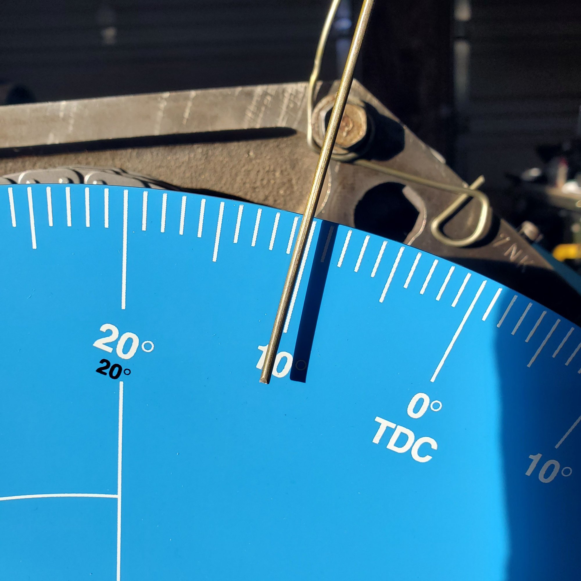

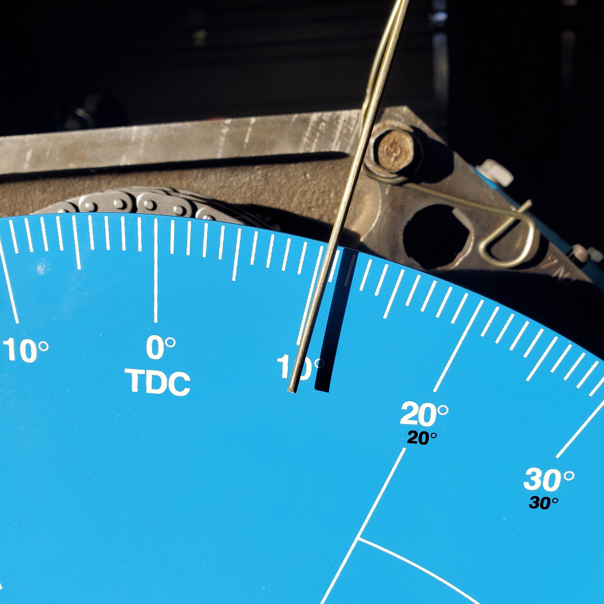

So installed the piston stop.
To start I set the degree wheel at 0* to figure out where my TDC was.
Rotated the engine back the other direction and ended up on 20* so I divided that in half and brought the degree wheel to 10* and rotated the engine back the other direction.
That got me to about 9.5* so rotated the engine back the other direction.
I ended up at 10.5* so I adjusted the degree wheel .05* and had it at 10* both direction. So TDC is right there at 0*.
Tomorrow I'll start in on verifying the cam lobe center and then the other specs just to make sure everything is correct.
