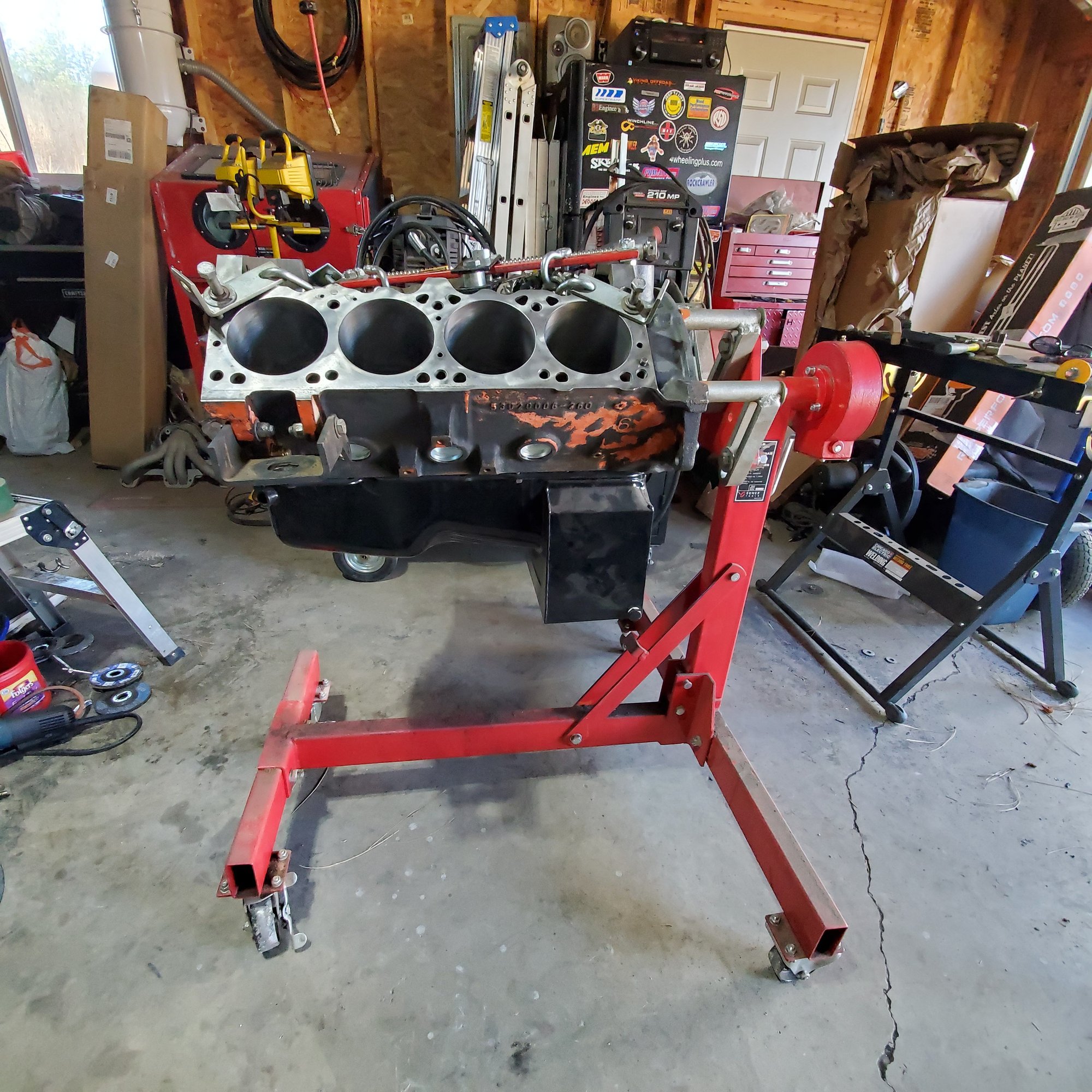

Finally got to the point where it was time to start working on the engine. Still have a lot to do on the Jeep but I need the engine assembled first so I can verify how it will sit in the frame and double check clearance. So I pulled the block back out of the Jeep and installed it onto my engine stand.

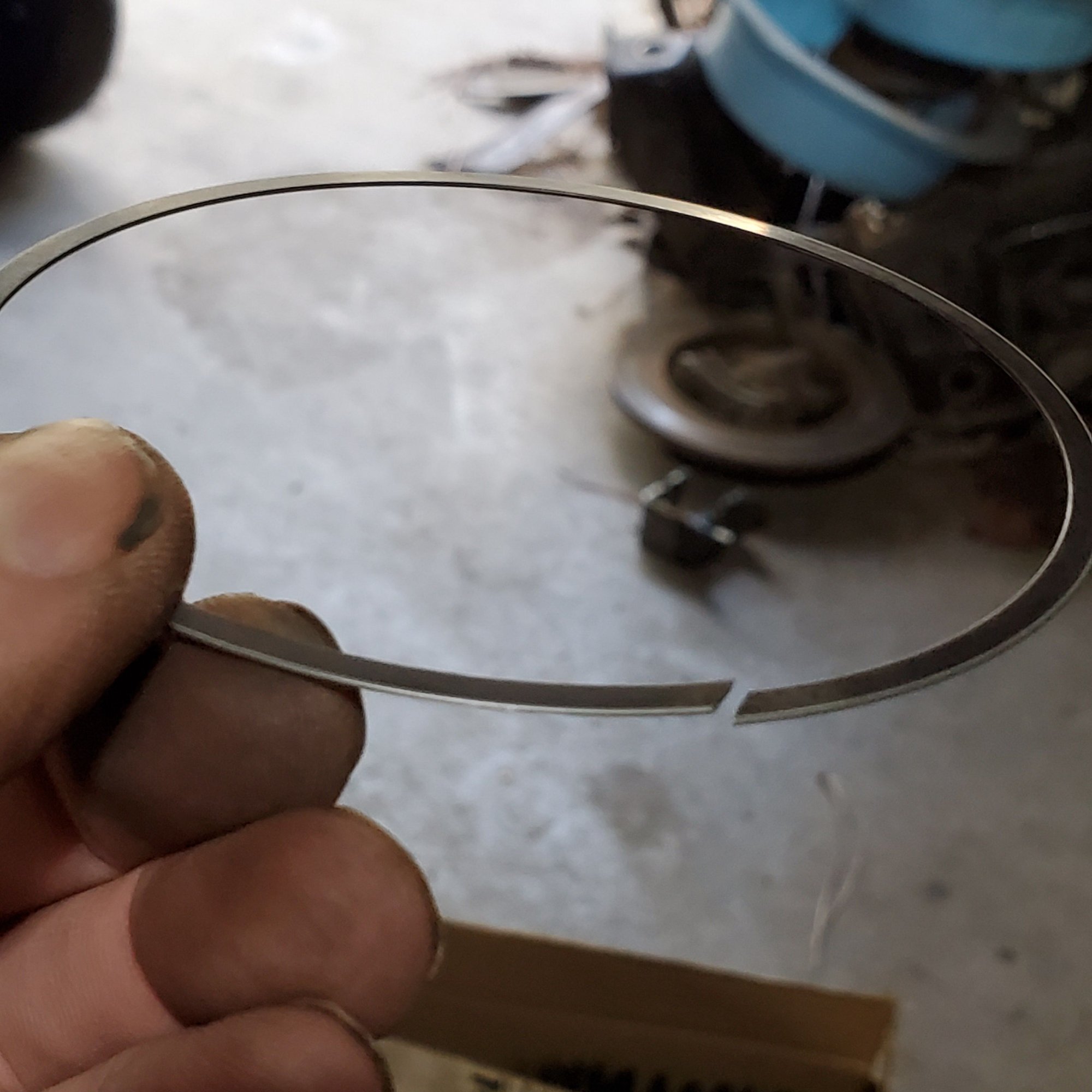

I'm going to be running some Total Seal Gapless rings. The make two types one a gapless ring for the top ring and then a gapless for the 2nd position. I have the top ring as a gapless ring. These are file to fit rings which is a first for me as I have always gotten pre-gap rings before.
I'm also running Keith Black Hyper piston which takes a larger gap that what is standard. I called Total Seal to verify what the end gap needed to be with this combination and I ended up with a 0.036 for the top gapless ring and 0.026 for the second ring and 0.015 for the oil ring.

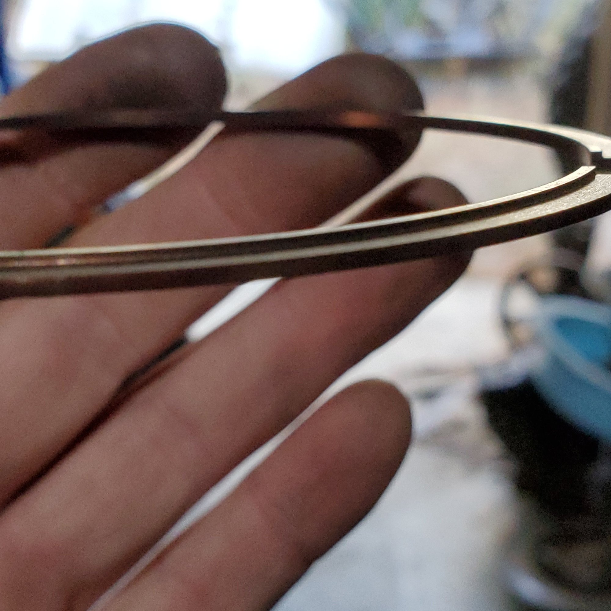

This is what the top ring which is the gapless ring and it has a ridge on it that the other part of the ring fits into a grove. When installed on the piston the ridge is faced in a downward angle.

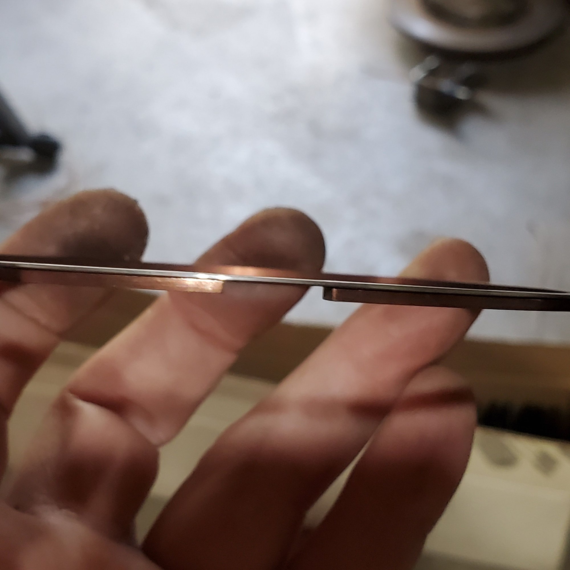

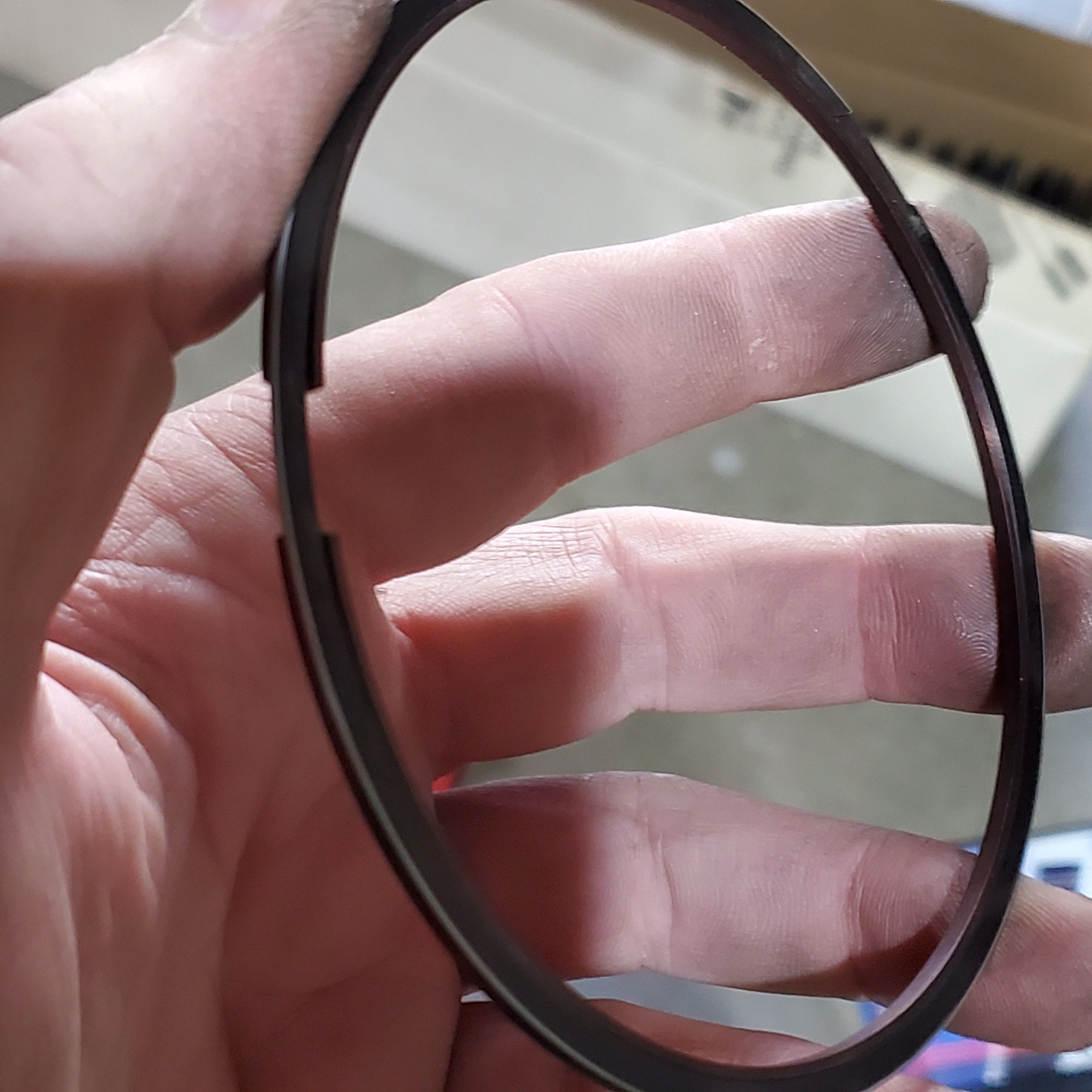

The other part of the ring that makes it a gapless ring fits into the upper part.
This is the part that makes the ring a gapless ring.

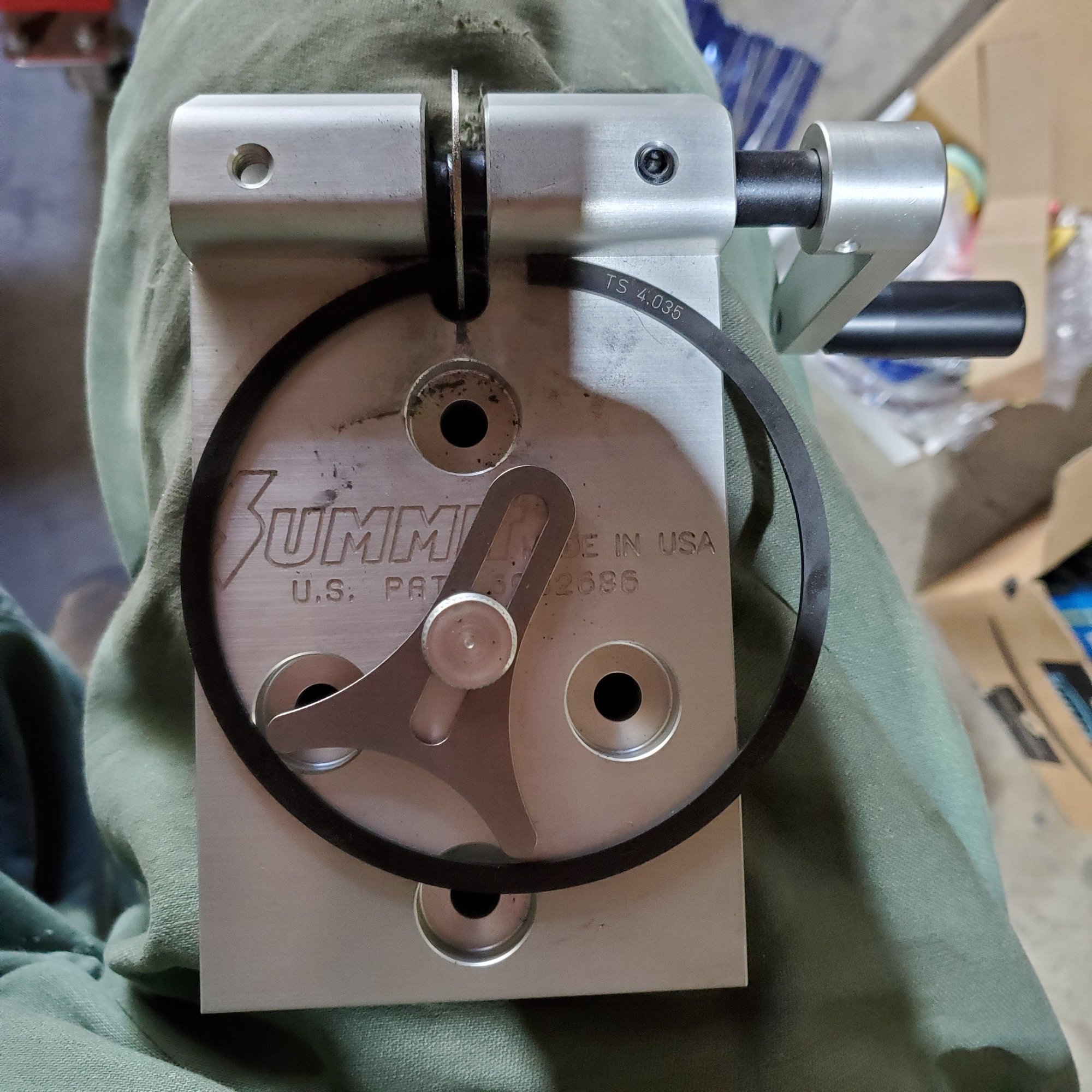

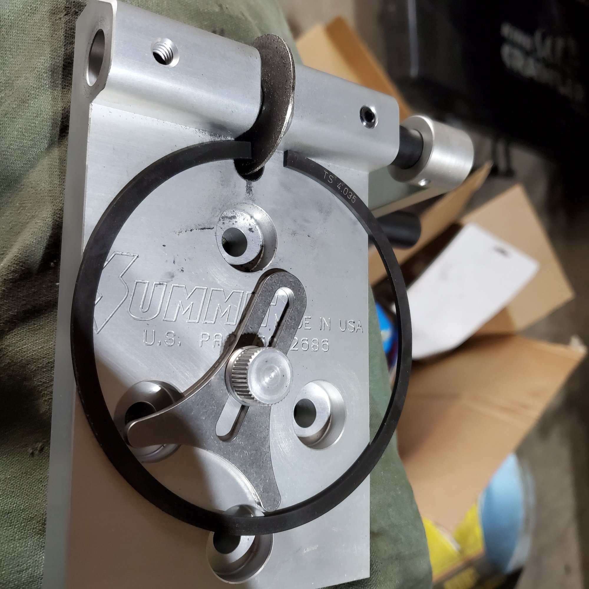

This is the ring filer that I got from Summit Racing. They make powered ones but as I doubt I'll do this much it wasn't worth the additional money.

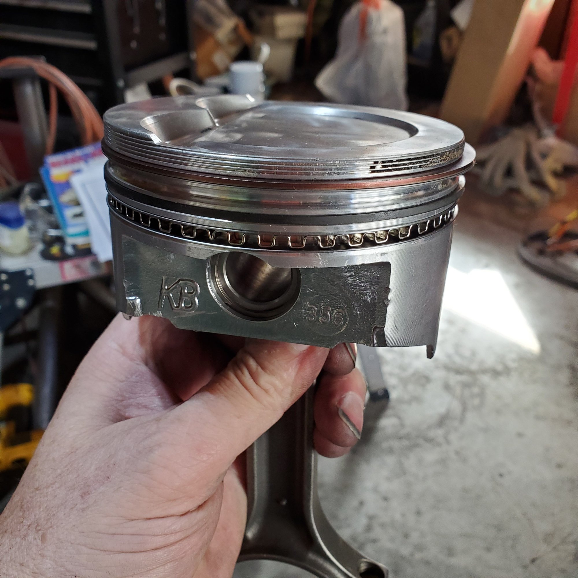

Rings are all installed onto the pistons and now I'll clean the block and get it ready to be painted so that I can assemble it.
