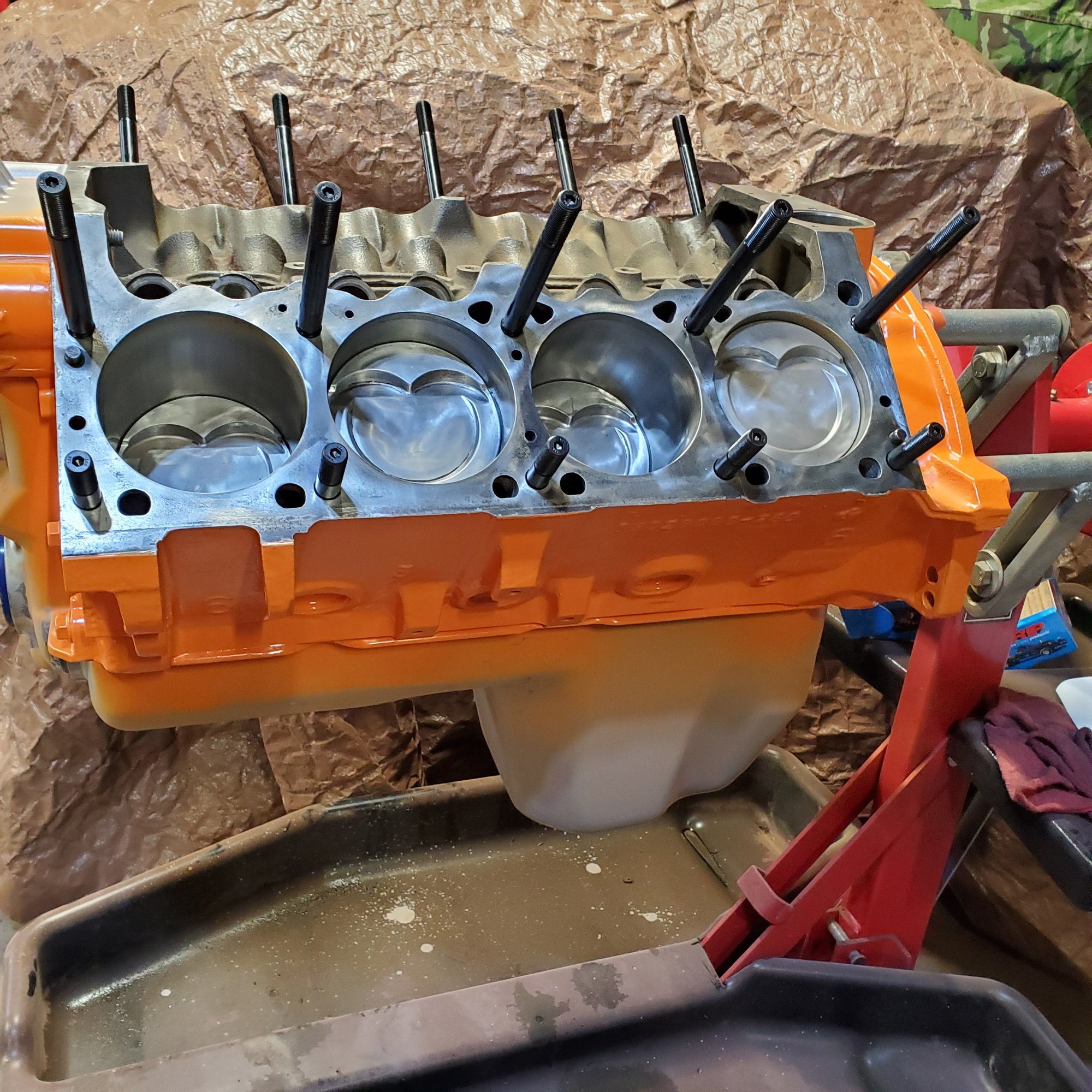

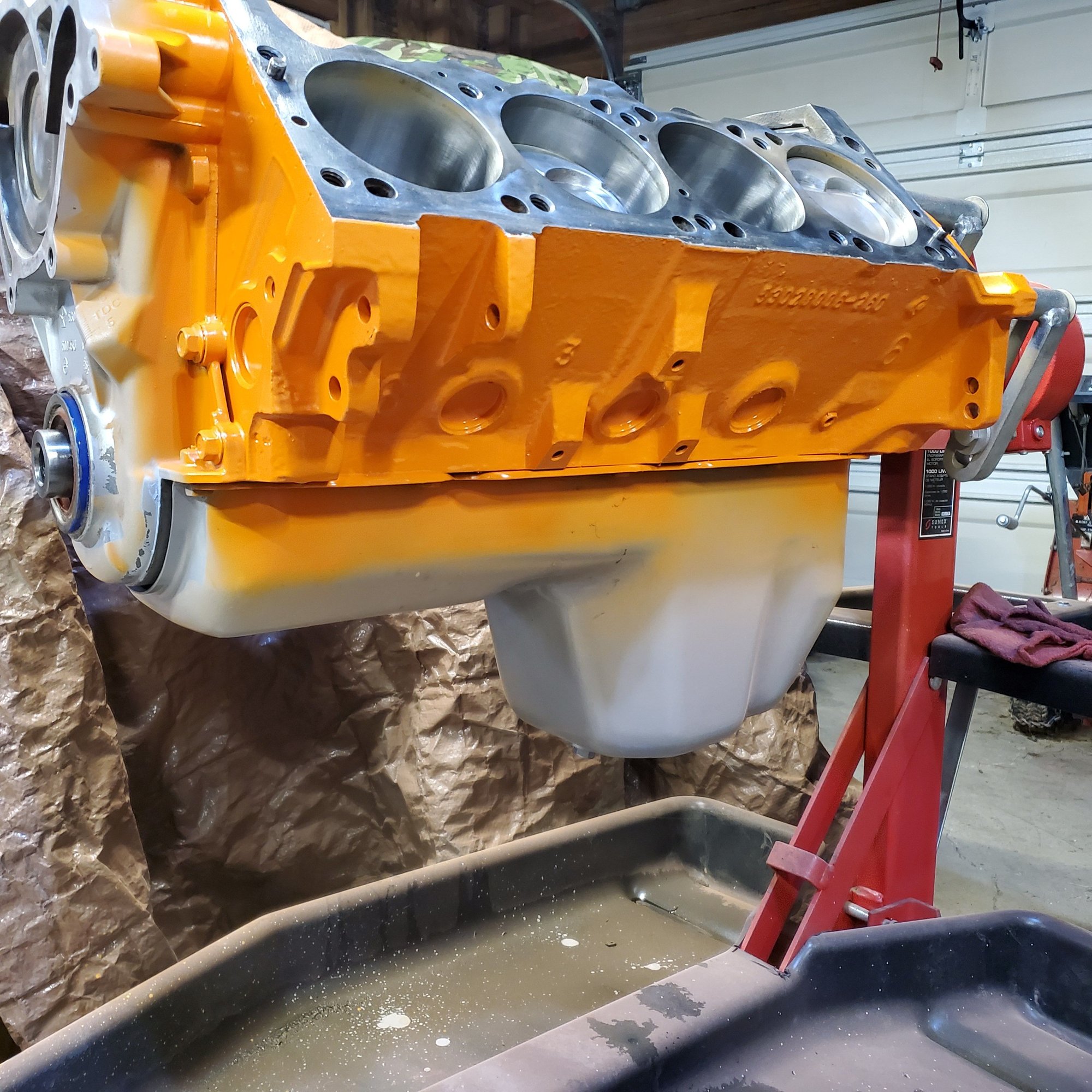

Old Jan 20, 2021 | 01:08 PM
  #649
Wildman4x4nut's Avatar
Wildman4x4nut
Veteran: Army
Joined: Nov 2011
Posts: 1,898
Likes: 162
From: Cle Elum, WA
Got all the tape off and the block is looking really good. Turned out pretty good.
Then ran a tap thru all the head bolt holes in the block and then installed the head studs. Moving forward.
Old Jan 20, 2021 | 01:22 PM
  #650
MoparFanatic21's Avatar
MoparFanatic21
Veteran: Marine Corps
Joined: Nov 2014
Posts: 8,098
Likes: 318
Looks good!
