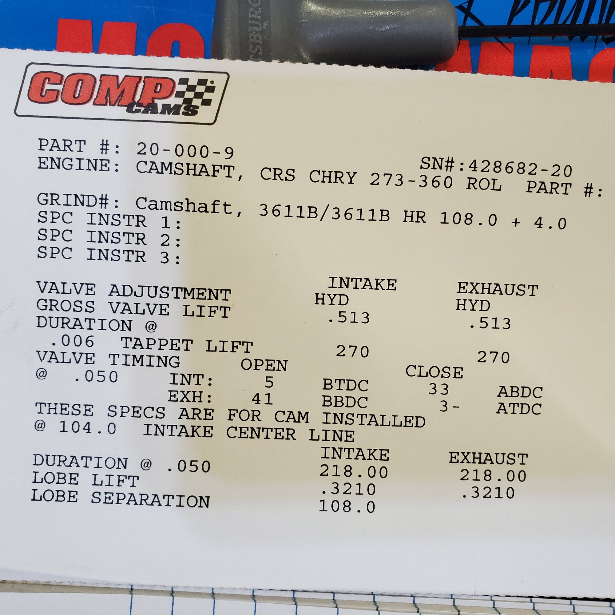

YAHOOOOOO finally got it DONE... I headed out to the garage this morning with some ideas and a positive attitude that I was going to get this done today. First thing I did was take a lifter apart and removed the spring and then shimmed it up with a couple of washers and put it all back together. Then I worked on setting up the dial indicator stand in a way that would hopefully allow me to get a accurate reading. I decided to swap out the analog dial indicator for the digital one I'd bought just to see if it would work any better.
Decided since I was trying a new indicator I'd go back to 0* with the crankshaft sprocket and start over. First reading I got was 105* lobe separation so I pulled the timing chain back off and advanced the crank sprocket 2* which moves the cam 1*. Took readings again and this time I got 103.5*......... HOT Dang... I'll take it.
So to further check everything I rotated the engine until I was on the base circle of the cam and zeroed the dial indicator and then continued to rotate the engine until I was at .050 BTDC on the intake lobe which put the degree wheel at 5* BTDC which is spot on.
Continue to rotate the engine until it reached .050 ABDC and the intake lobe was closing and the degree wheel was at 31.5* ABDC which is close enough for this job.
Timing card where you get all this information from.

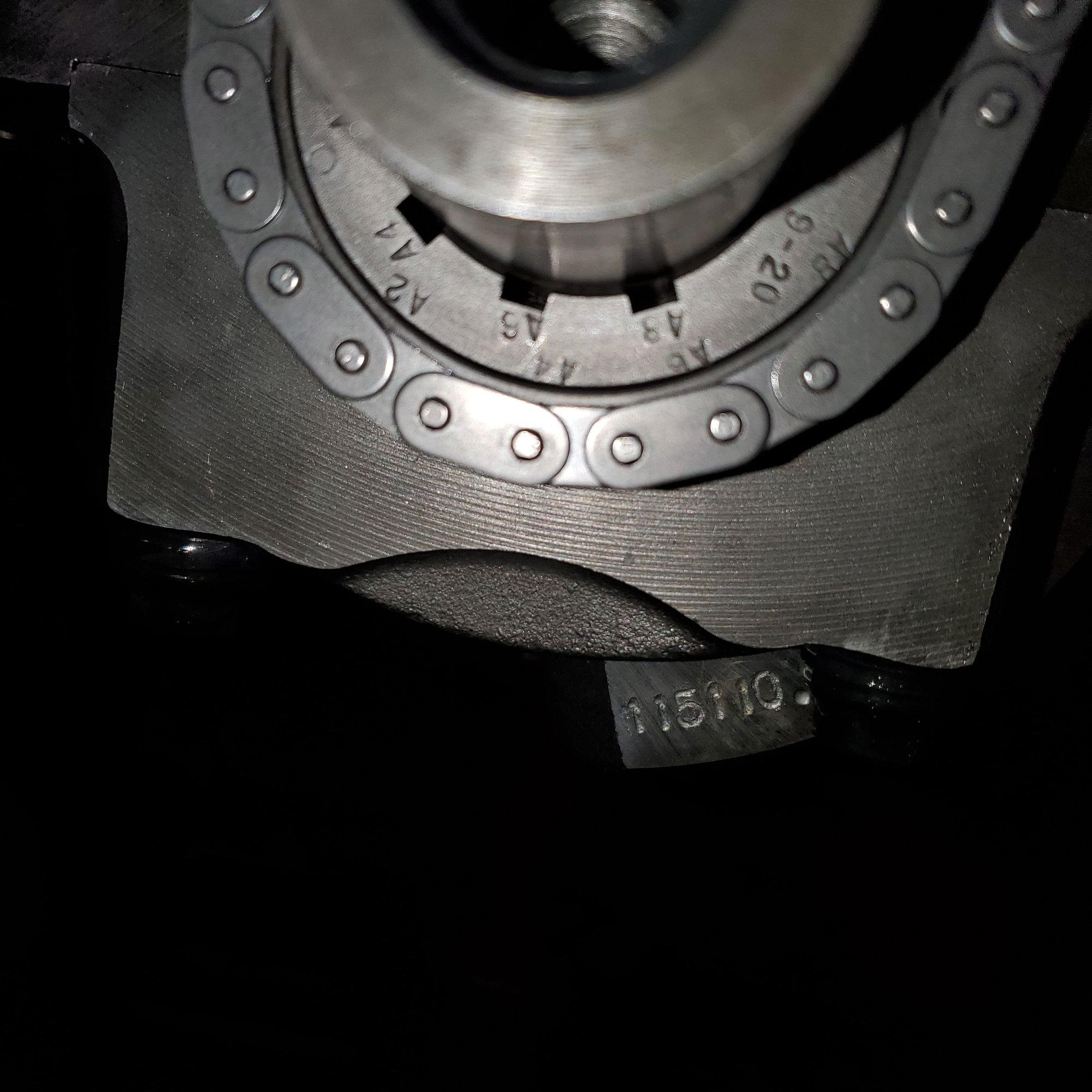

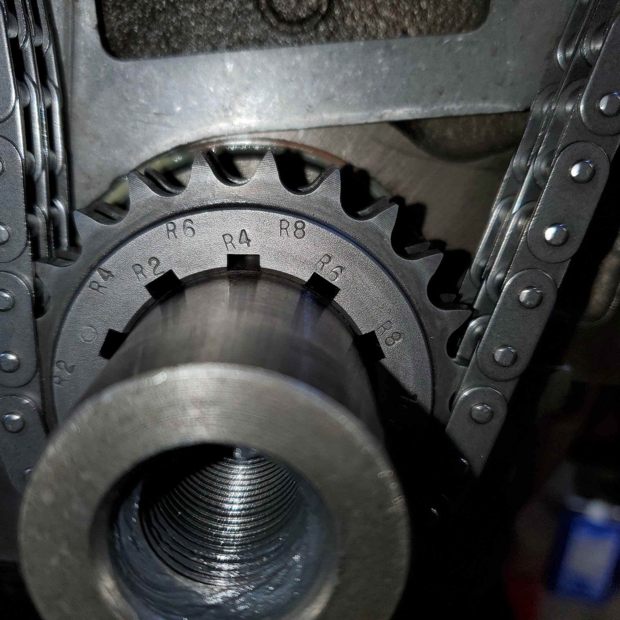

I was asked about the timing chain I am using in this build. The crankshaft sprocket has 9 key ways in it so that you can degree the cam in spot on or DANG NAB close. I'm glad I decided to buy this timing chain set instead of going with the old one I had that only had 3 key ways cut into it. As you can see I am at 2* advanced on the crankshaft sprocket which moved the cam 1* advanced which got me to 103.5*.
They other slots cut into the sprocket.

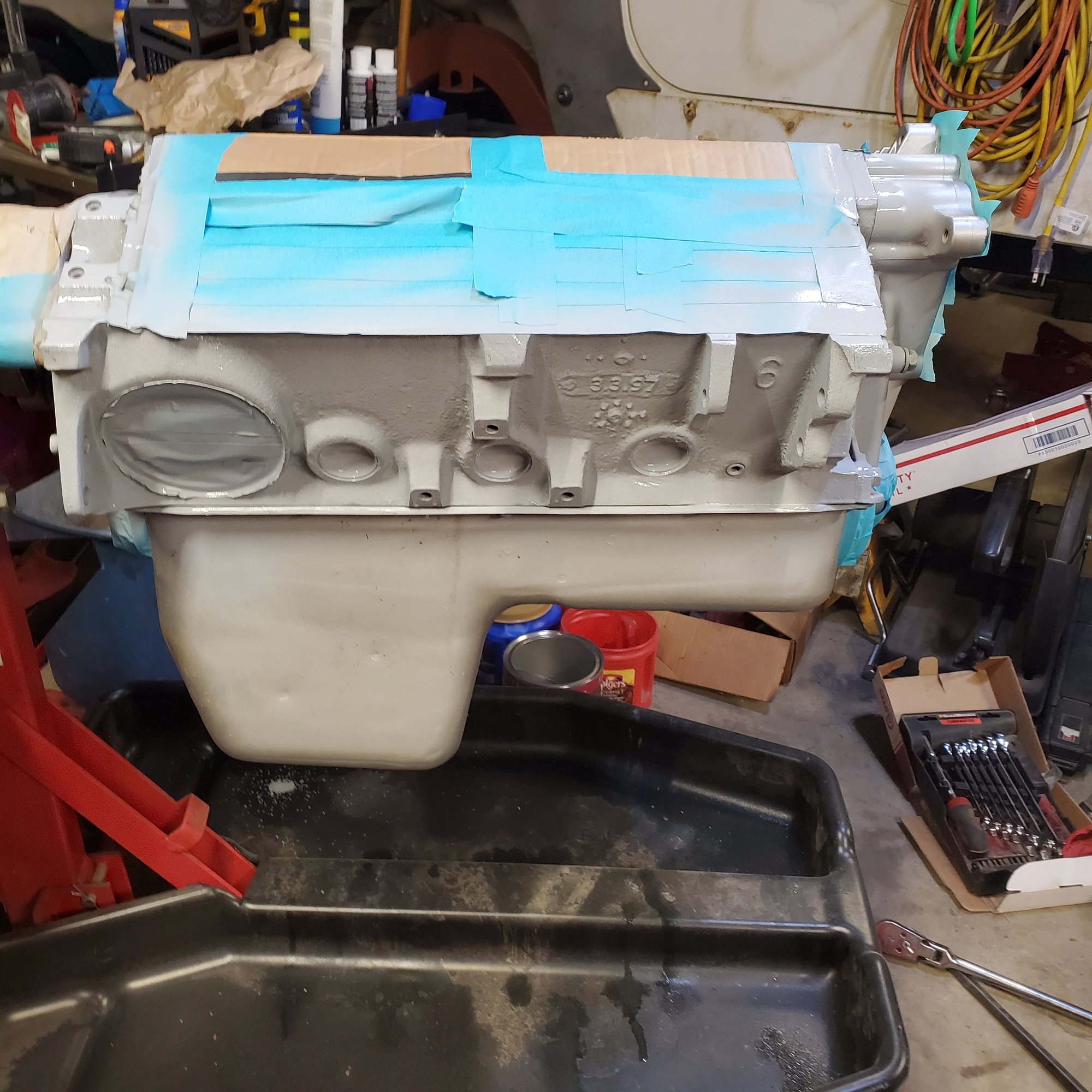

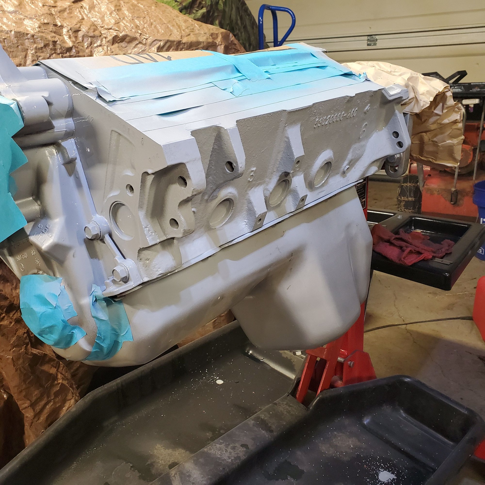

Got all the tools for doing the cam degree but away and then started to get the block ready to be painted. I wiped it all down with acetone and then installed the front cover and oil pan before I taped everything up for painting.
Then I laid down two coats of primer today and will do two more tomorrow before I paint it in the color I've picked out.

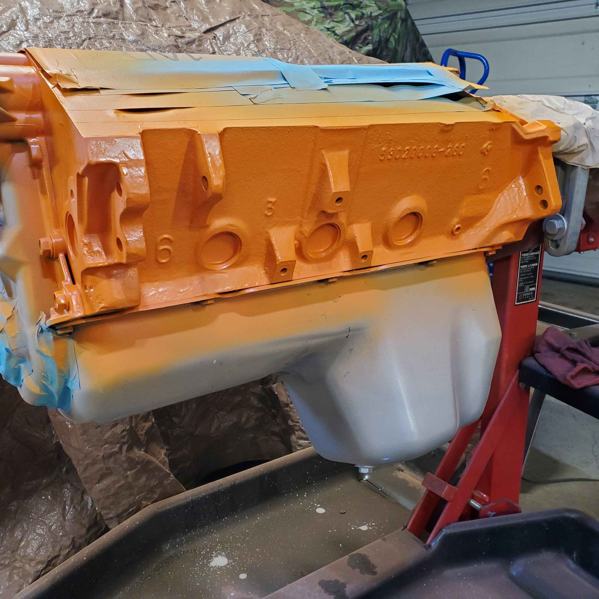

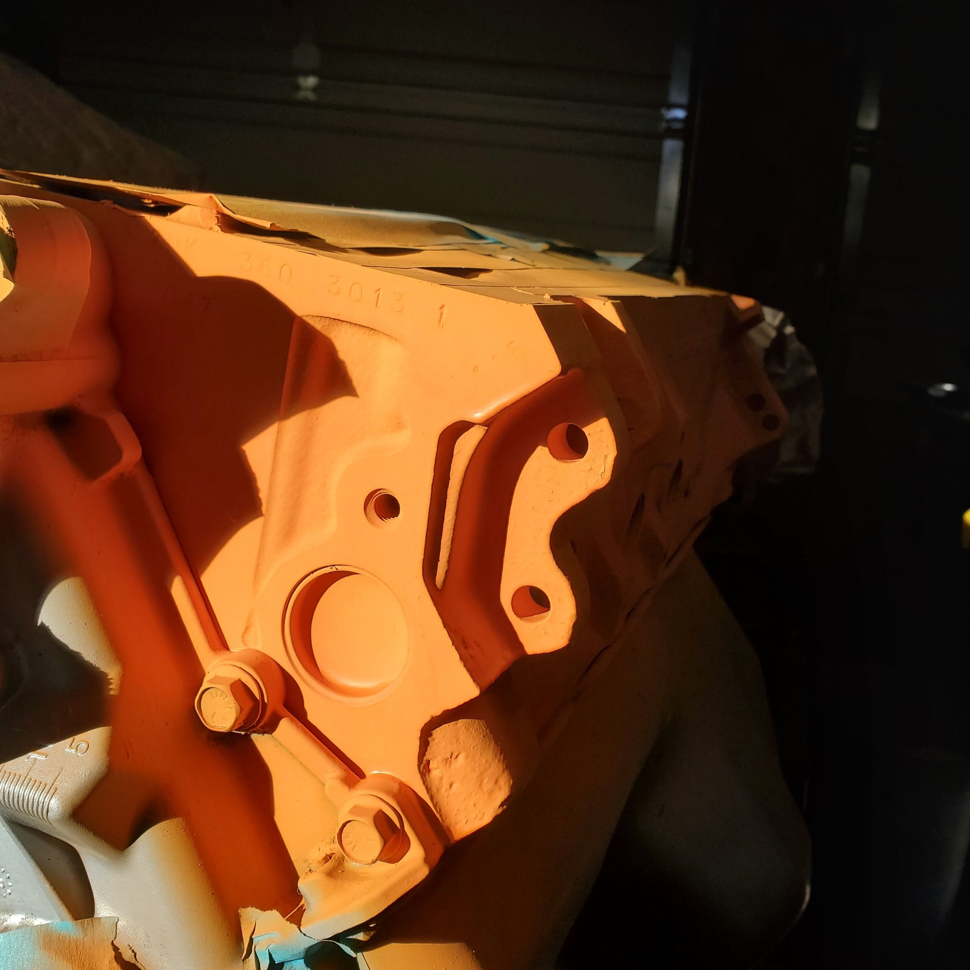

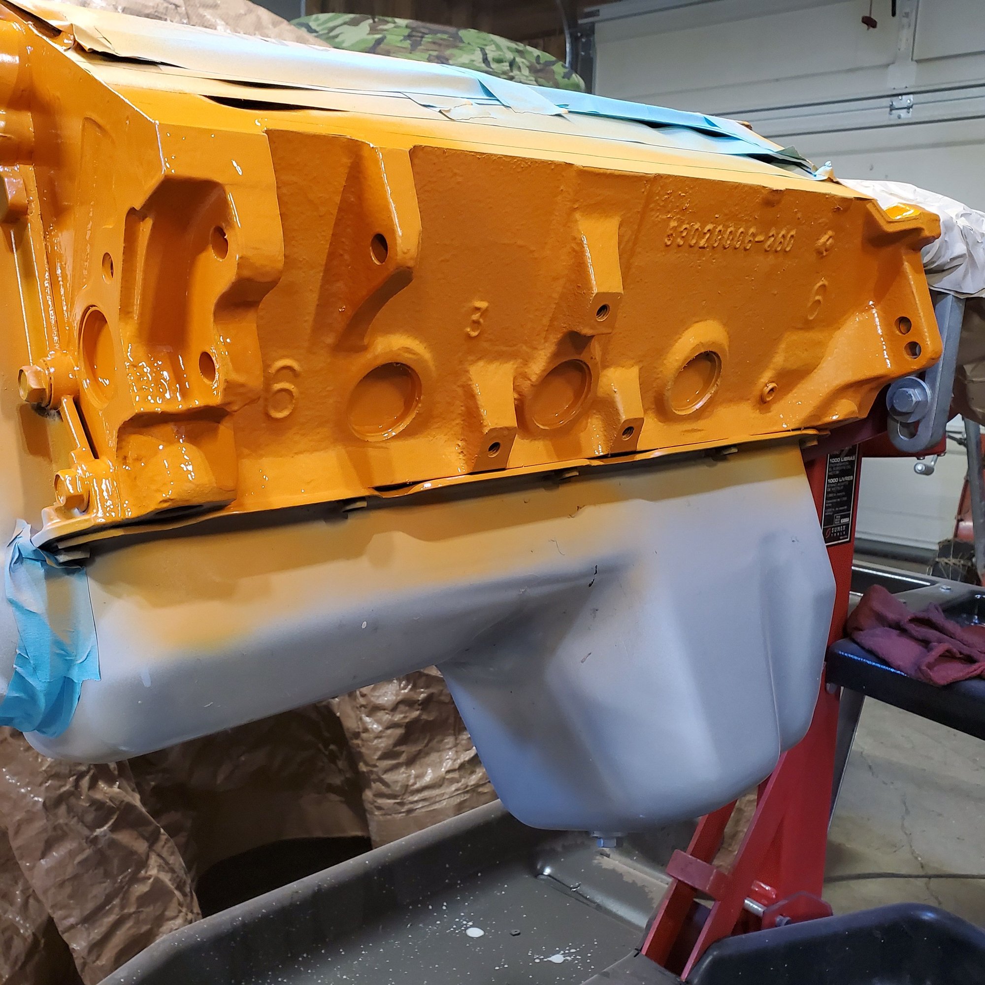

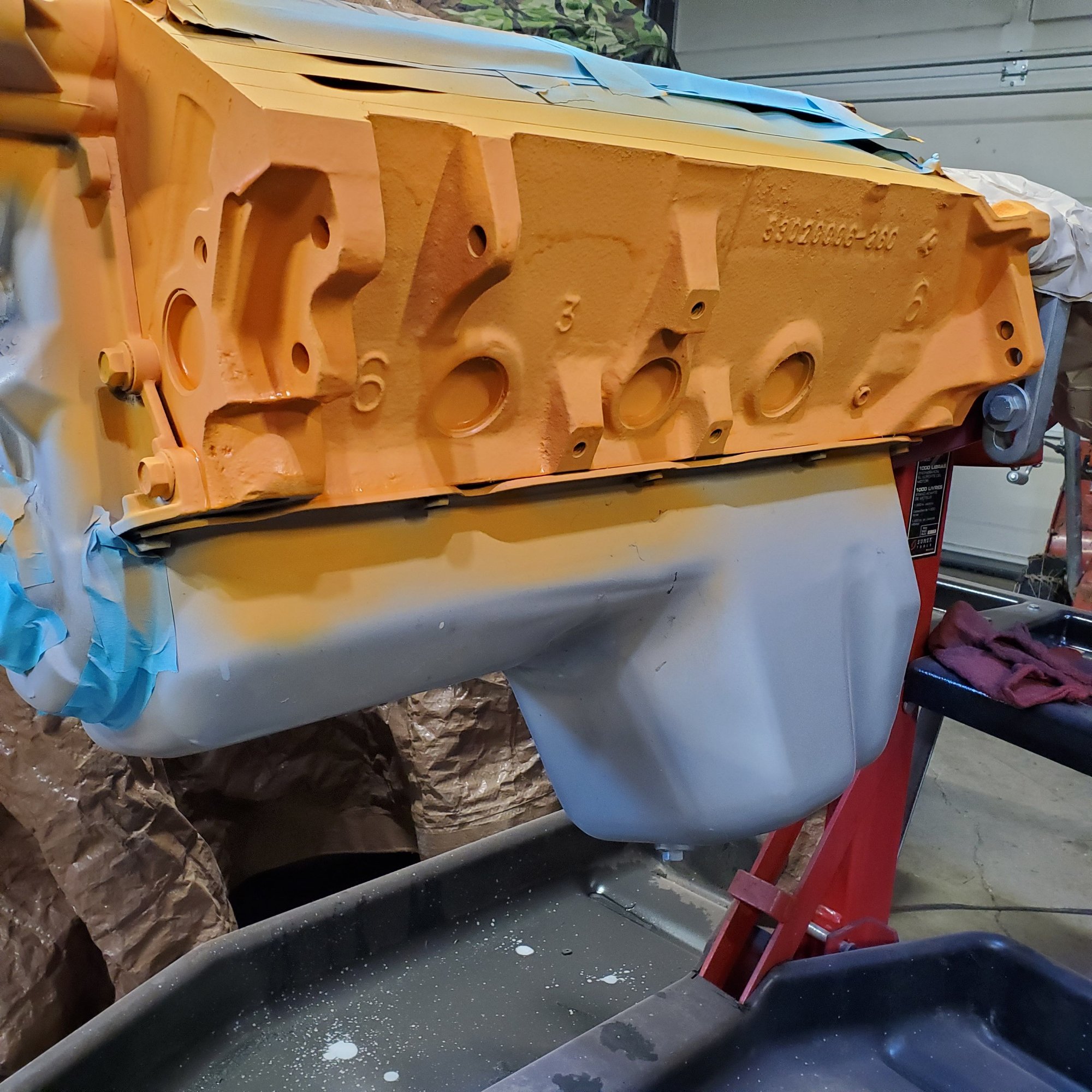

Started laying down the base color today. I have 3 costs of it applied and IMO it's turning out to look really good. I went with a flat color as I am really not a huge fan of shiny paints. Guess it has something to do with being around flat colors for 28 years on vehicles.
This is with it wet but once dries I think it'll look really good.
Here it is dried. I really think I like this flat paint color as opposed to the Hemi Orange.
After 3 costs of the paint I let it dry completely and then sprayed on some flat clear to hopefully protect the paint a little more.
So at this point I think the flat clear doesn't affect the color at all. We'll have to wait a while to see if it does help with cleanup and stuff.
I've got 2 coats of the clear on the block so far and am not sure if that is enough or if I should put 1 or 2 more coats on.
