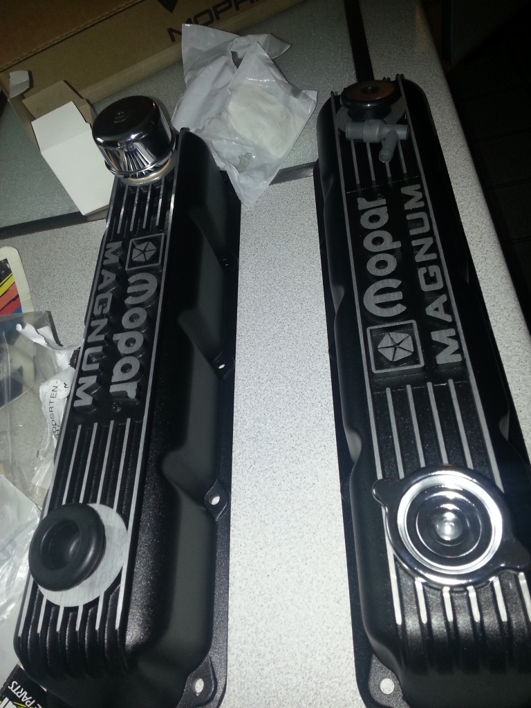

Does this look like an acceptable setup?

Going clockwise from bottom left the whole way around... That is a black plug. It looks as if there is a hole in the middle, but it is more of a recess than anything else. Left back is a Mopar air breather. Right back is the PCV w/grommet and the front left is the oil fill cap. Any issues with this?
InfO.

Looks alight, I went with a chrome Mopar push in breather cap and kept the hose to the air box. If you start to see oil under or around that air breather put back on the org hose and breather set up.
Ack. Thanks. Going to throw on the HS 1.7's now then and then put on the valve covers.

Edit: Keep all the old air breather stuff you will need it for Aircare.
