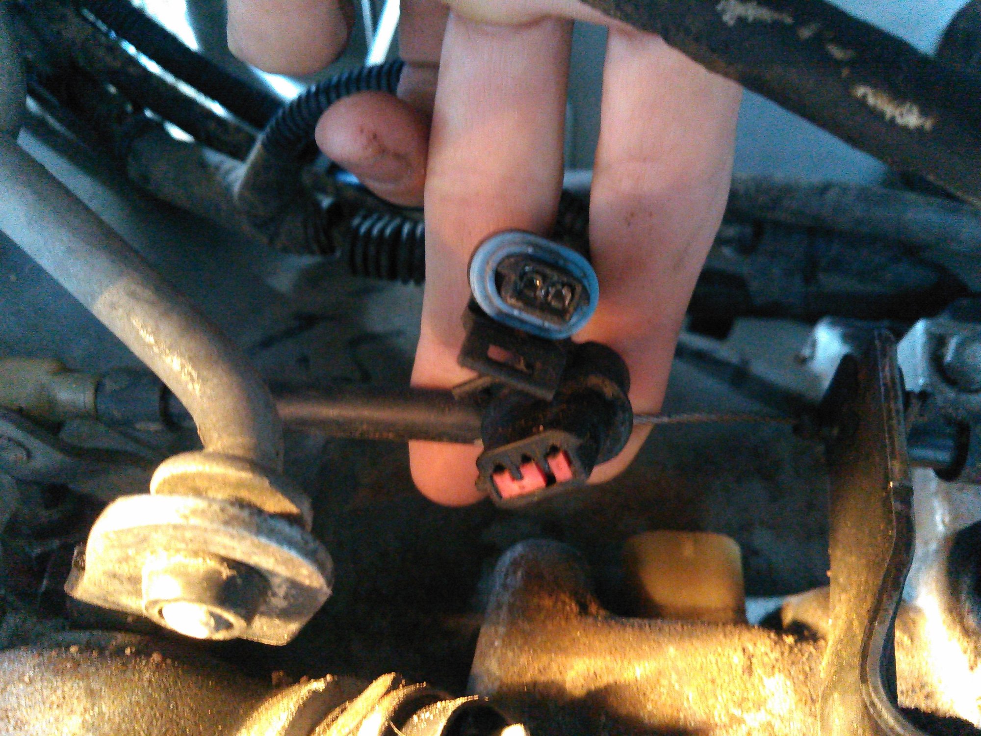

Finding the switch is my issue.
This be it?

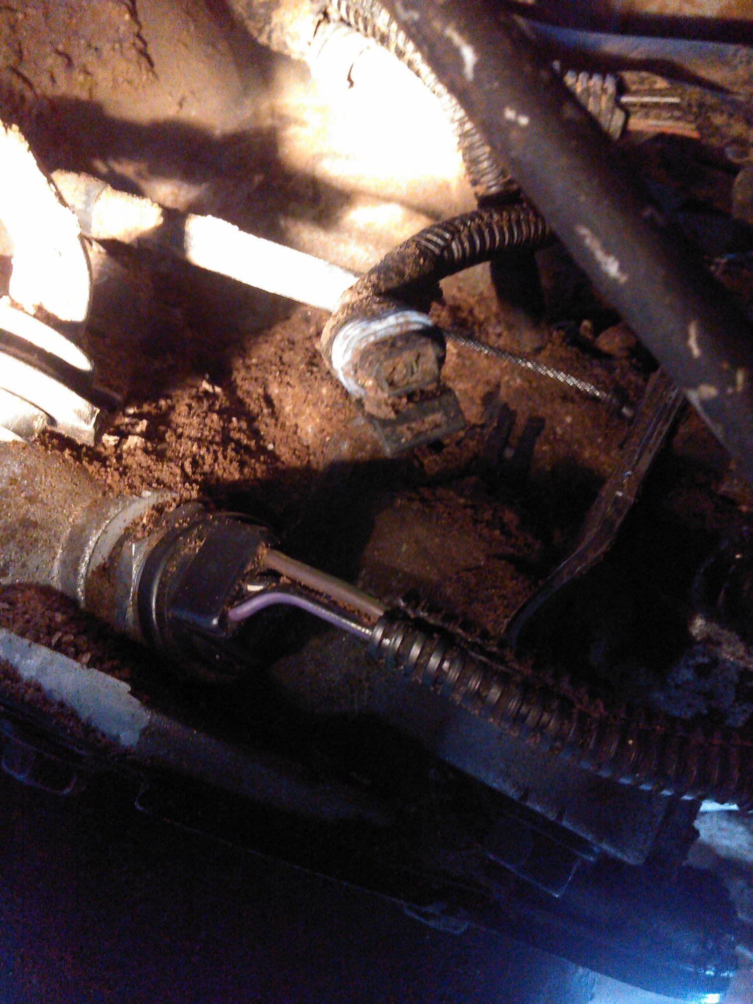

Found this little bugger dangling and full of dirt, Im not 100% sure what was going on but the amount of dirt caked under here is obsene. Have spent the last hour or so gently scraping away this crap. Got it fairly cleaned up but still cannot seem to determine where she might go... Cleaned up the plug i posted in the previous picture inside and out (and around) Truck still wont start in park. Though after removing all this dirt it will go into first gear now(wouldnt before).

Ouch! Looks like you bought someone's mudder. Not sure where that goes, but it probably goes somewhere on the tranny since you are having issues there.

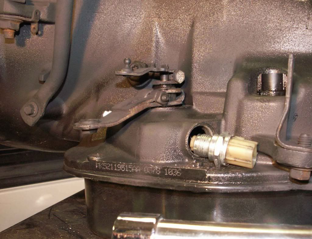

The Park Neutral switch is on the left side of the transmission near where a shaft comes up out of the transmission.
It is the removed switch.
