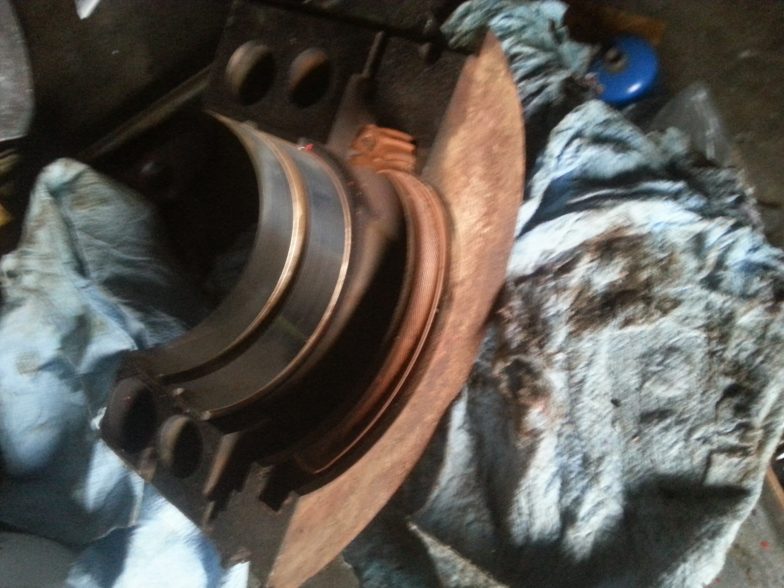

hi i just got the 2 part seal.. now it has different instructions then the book so i wanna verify things as it talks about the big lip book talks about paint well no paint..
also has a shoe horn not sure how to use it
and where do i exactly put which sealants flange antibotic sealant and the black rtv

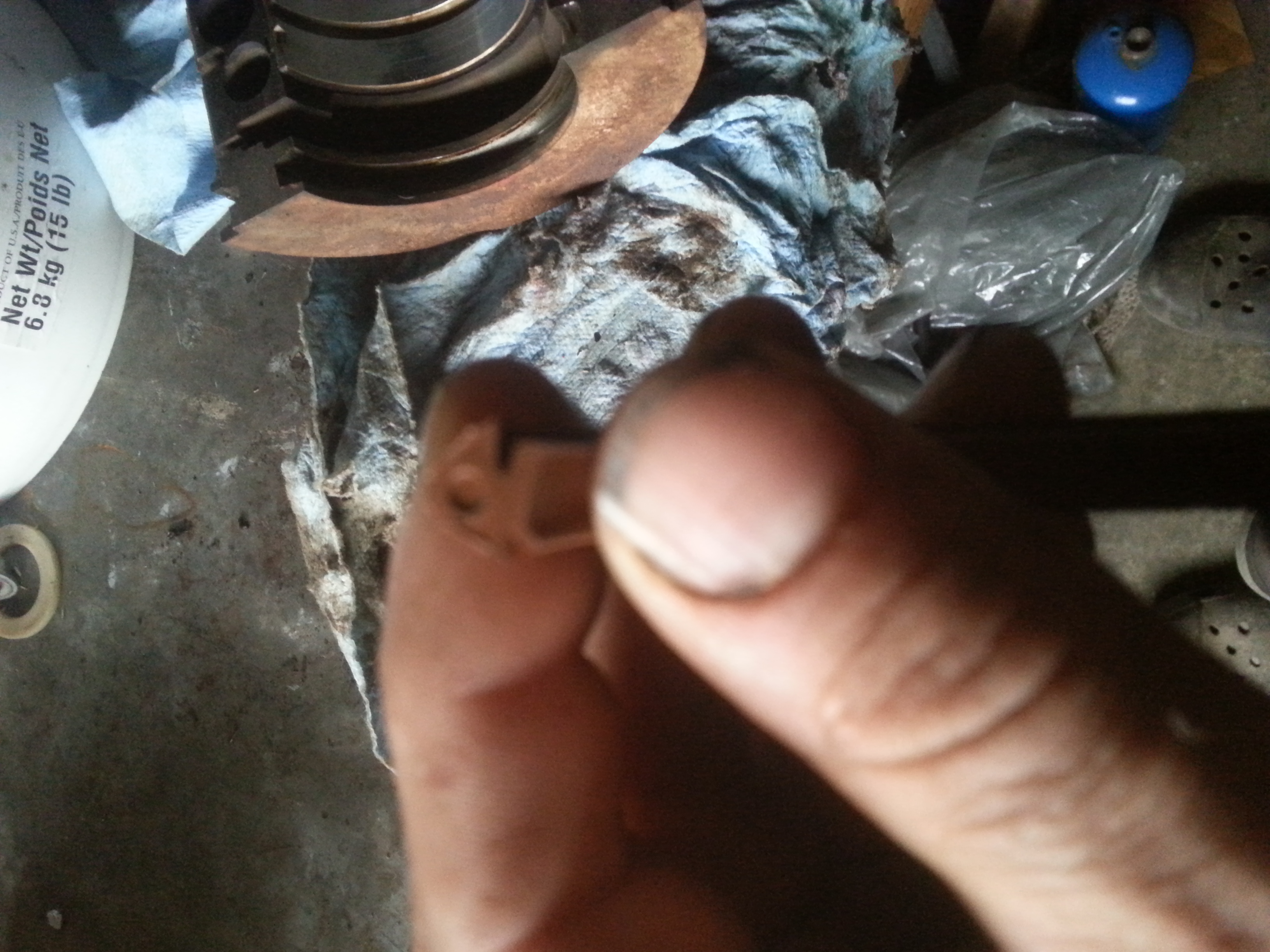

here the pics as i dont wanna do it wrong and do i off set it like this i have in the cap and do i put a dab of flange sealent on the end of the 2 part seal as i read somewhere they recommend that just a dab to make sure it seals
and big lip is on the right in the pic right by my thumb that goes on the inside of the engine and other side faces out

The 'opening' in the seal faces the inside of the motor, that way, internal pressure will help it seal.
A bit of anaerobic sealer goes on the ends of the seal, a dab of RTV goes in the corners where the oil pan seal goes around the main bearing cap.

so i have it the right way in the pic the seal i have it goes right side(thumb side) goes towards inside of engine
and the book is totally different the hayes book on procedures like it talks about half way and then i read clocking it which i guessing like it says on those bag instructions u turn it up so they are off set..
and i guess i torqu the bolts after to 85 pounds i was googling and i think oil pump the same..
and that i lightly oil it... and then i read be easy or ill shave it and another said drop the crank shaft a bit i hoping the oil i can push over top of the crank

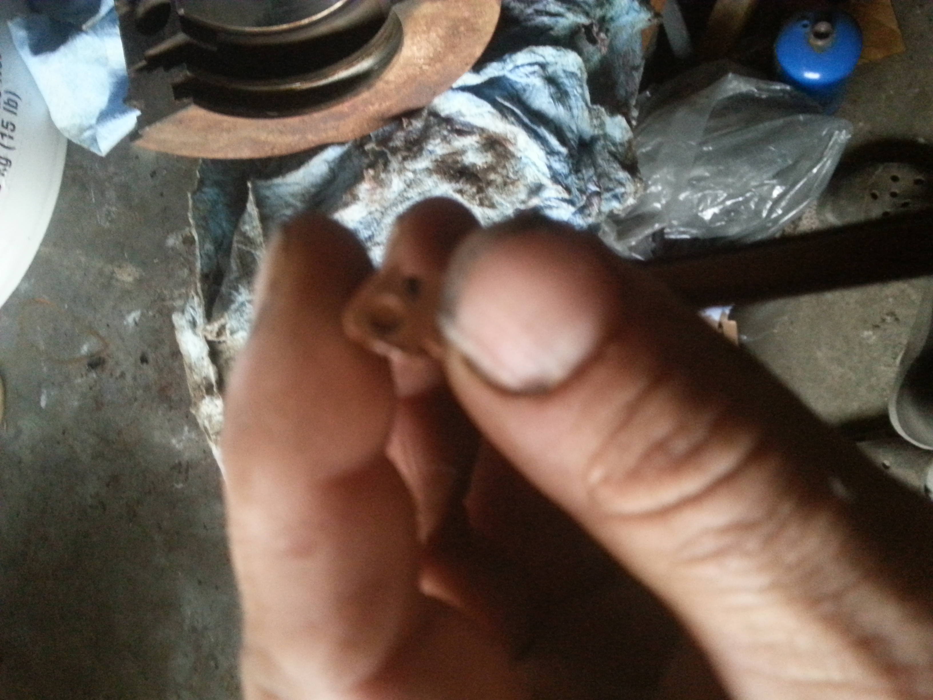

i took a better pic different camera... so i have it that bigger lip that goes on the inside of the thing correct as i going to oil that puppy up so then i can work on getting transmission back in
