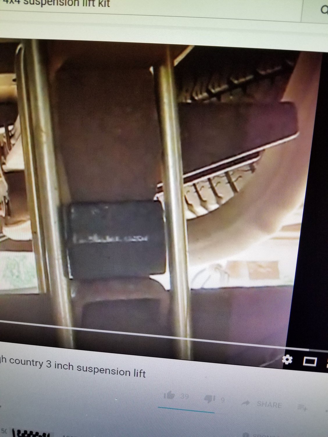

Originally Posted by Rammit82
When I first got it. The 3" block in the back was there with a 2" helper spring. The front had stock springs with a 2.5" in spacer. So I tool out the stock spring and spacer and put a 3" lifted coil spring and took the helper spring out and now the *** end sags 3/4" lower.
I'll take pics off the setup tomorrow and send em to u so u know what the deal is. I just want to have the 3" lift and body leveled out
this is what I found online. Apparently i still do have stock rear suspension and need to get the 3" rear lift kit. The top block with the bump stop arm is all I have under there. So I'm assuming with that and the 3" springs in the front everything should level out then.....
That is a route people go. Some say stacking blocks in that picture is bad as it CAN cause the u bolts to break. Nobody that I know had that happen, but the "proper" way is to add leafs. That what I am going to do plus it won't say when weight is put into the rear/towing. Only downside to add a leafs is more rough riding. But that why you bought not just a truck but the best truck off them all a Ram
