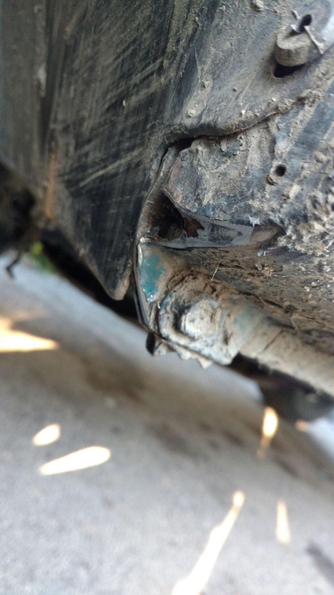

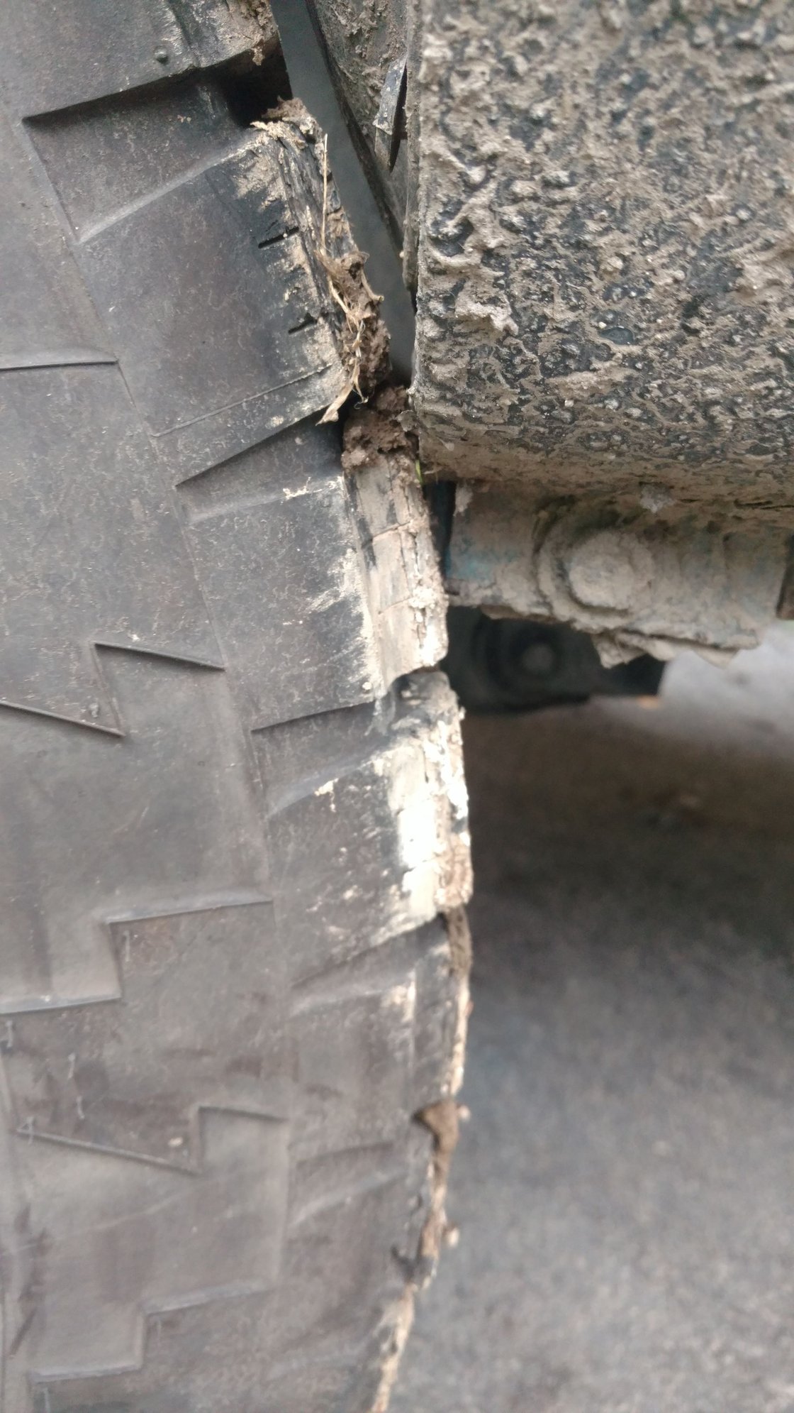

Here is the rubbing on the driver's side. These tires aren't even full tread maybe 30% left but they were free so I took them. Going to make a template so I can cut each side evenly.
Old Sep 13, 2018 | 06:07 PM
Posts: 87,468
Likes: 4,220
Probably have some inner sheet metal you will have to move outta the way as well. Maybe after you wash it..... it will be more apparent.

Here is what I had to remove on both sides . What is this "wash" you speak off?!?
Before
What I removed
After, It barely clears when you are flexing.
Old Sep 13, 2018 | 06:29 PM
Posts: 87,468
Likes: 4,220
Wash, you know, soap, water, scrub brush? It should happen to your truck at least once a year.... or so......
Didn't have to take off much.
