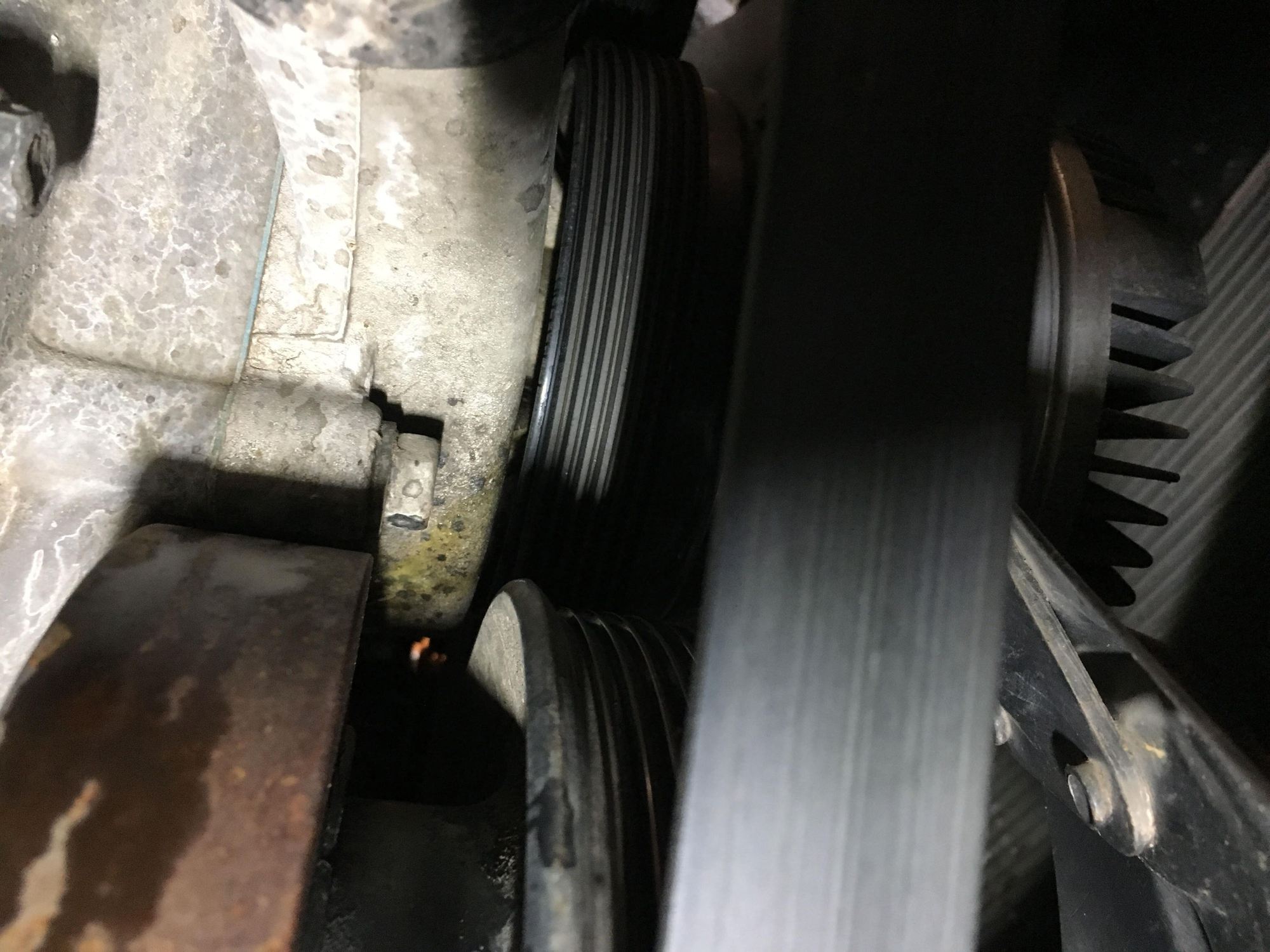

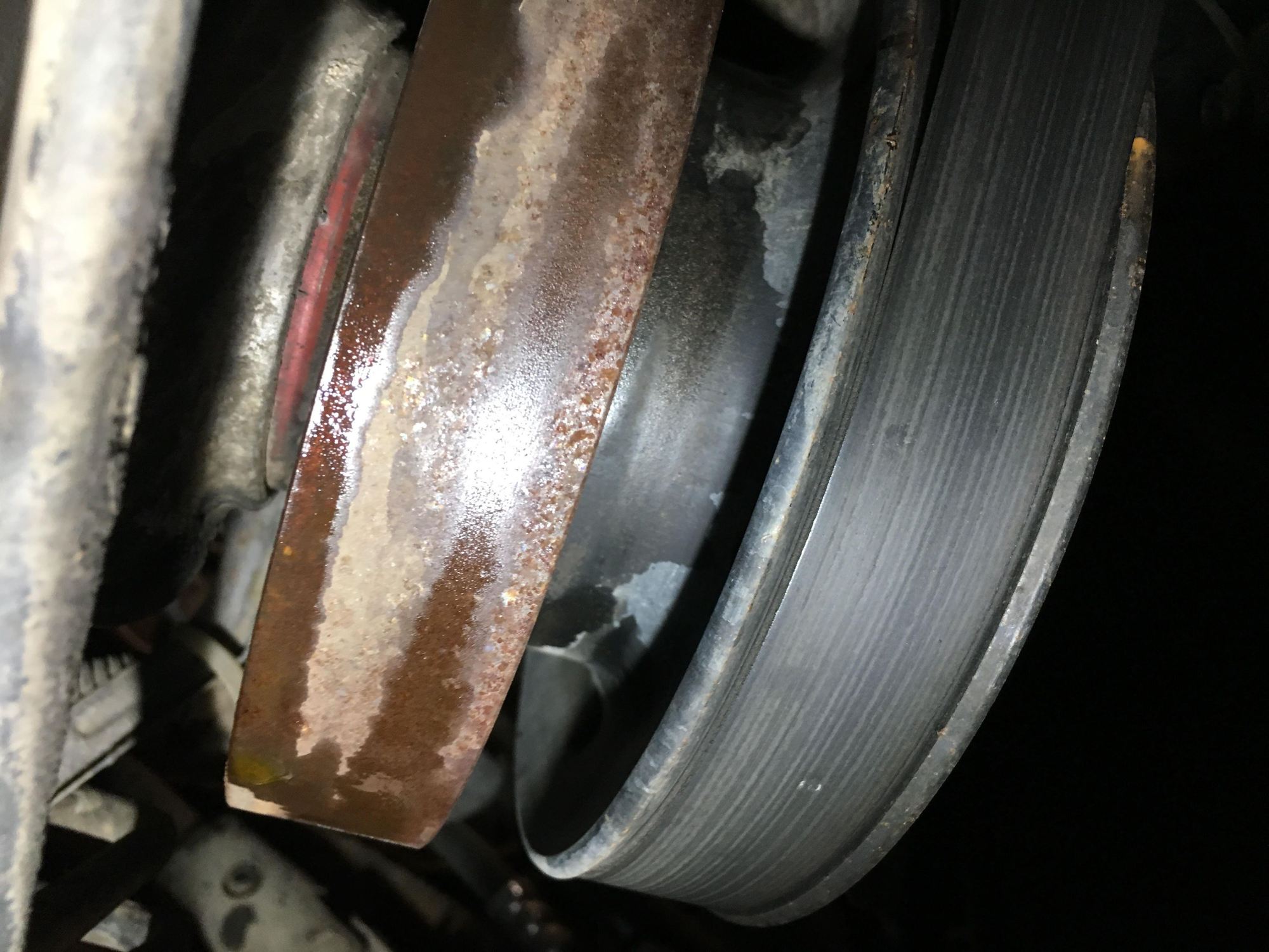

Hey everyone. Changing my oil yesterday and found that i had a good amount of water on my harmonic balancer. Looking further up I found it on the bottom of the water pump. Looks like shes starting to weep right behind the pulley. When I did my plenum (back in 2011?) I replaced the water pump with a brand new, not reman'd, water pump from napa. I only got 40,000 miles out of it. Pretty disappointed in that but I know sometimes it happens.
Is there a better water pump out there I can buy? Ones to stay away from? Also I think I used Fel-pro gasket last time, any reason not to buy fel pro again?
Here's some pics for the heck of it.
Balancer
Drip forming on bottom side of pump

I've had Mopar water pumps and I had the cheap ones from advance with the cheap gasket. Both lasted until I sold the truck. Is there a warranty on the pump? If so get another one. You could have got one that was just poorly built. Try to avoid ones built on a Monday or Friday as they are usually the ones that are of crappy quality.
