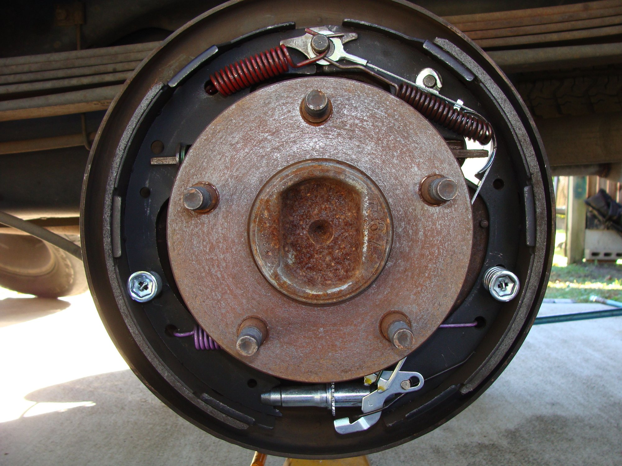

Ok. I just replaced my rear wheel cylinders, brake shoes and all new hardware. Cleaned everything. Lubed up the friction points. I did not replace the drums. And I did not have it checked for the maximum wear limit. I have some tools but not an 11 to 12 inch mic. When driving, especially by a fence, wall, curb ect....., I hear a squealing noise on the drivers rear. when I hit the brakes the noise stops. ???????? Possible bad new spring? It all looked and went together like it should. So I pulled it off again tonight. This will be my fourth try. I can not figure this out. I said screw it and came in to post this thread. Realizing I needed help again. Thanks for any advise!!

Yes. I did perform some break in stops. Even a couple in reverse. While looking at them this morning they appear to look real shiny already ( the shoe surface). like they are glazed over already. Now I'm thinking cheap *** break shoes. Problem is with that is these are the same brand I have used since buying the truck new. The adjuster was screwed all the way in so the drums go off and on very easy. I also just noticed that the adjuster stop is not engaging with the teeth on the adjuster. Almost like the e brake cable that runs from the adjuster stop to the top post is too long. Still confused. Thanks again.

Can you post a pic of what things look like?

Adjuster all the way in, sounds unusual. You need to adjust your shoes so that they are just slightly skimming the drum when you spin it.

Default Some pics

Anywhere nearby you could get those turned?

Trying that again. Can't seem to post only one at a time.
