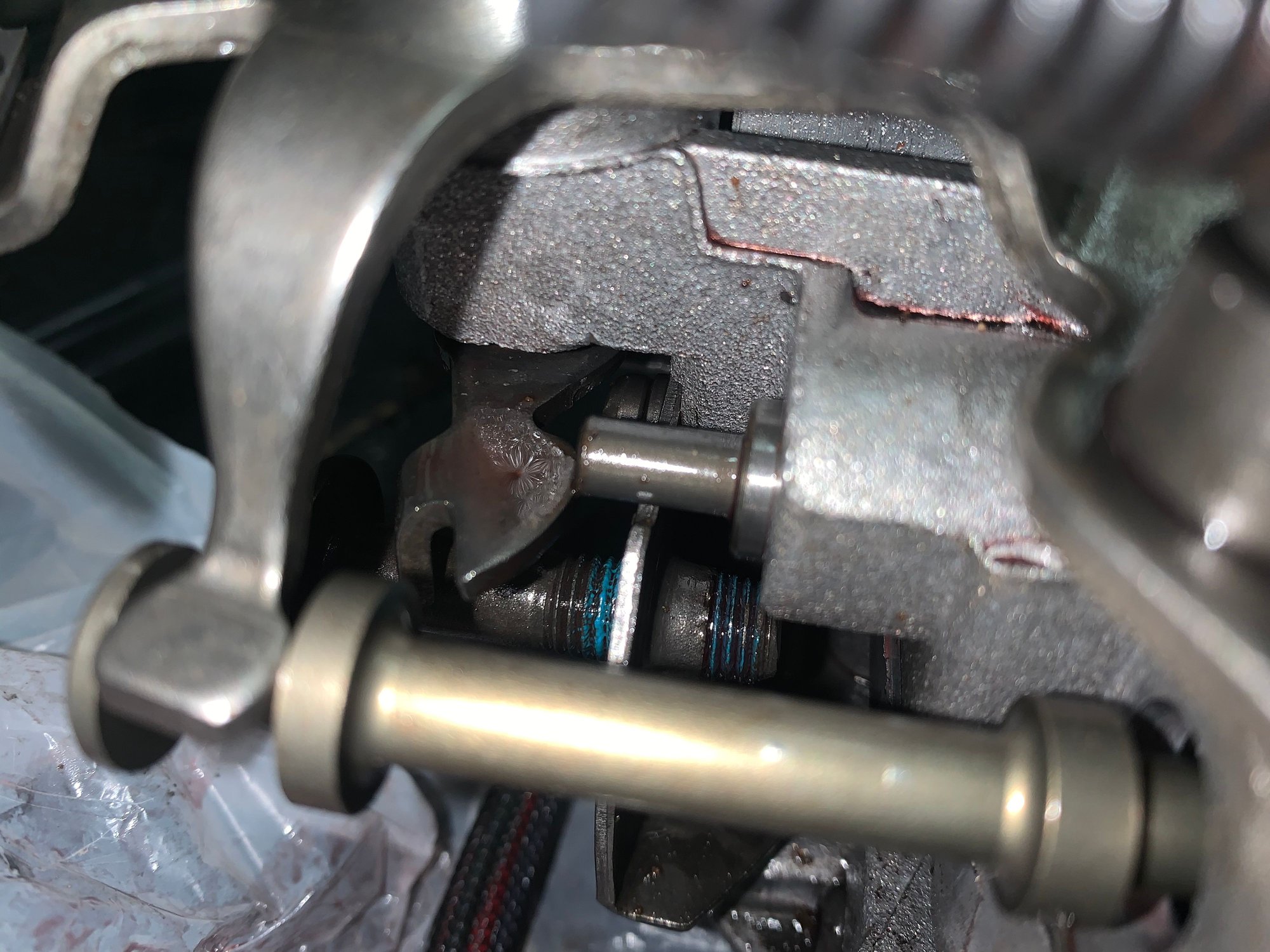

Probably more going on in there than meets the eye. I would take a very close look at the mechanism for the TV cable, I don't think there is supposed to be any slack there at all. When you have the pan off, see what things look like.
OK, so this is my donor trans valve body. It also has slight play in it. Here’s a picture and in the background you can see a lever stops from a screw going back and also stops going forward from a plunger? So I believe the slacks there for a reason?

Don't see a pic......
Check thru the service manual, and see what it has to say. Might also check out some of the transmission bench vids on youtube, for the assembly part of the job. They may have some insight on how much slack there should be.

ok so I watched transmission bench and it seems he just takes the bracket off that’s over the plunger nothing about actually torque specs.... here are pics from above
