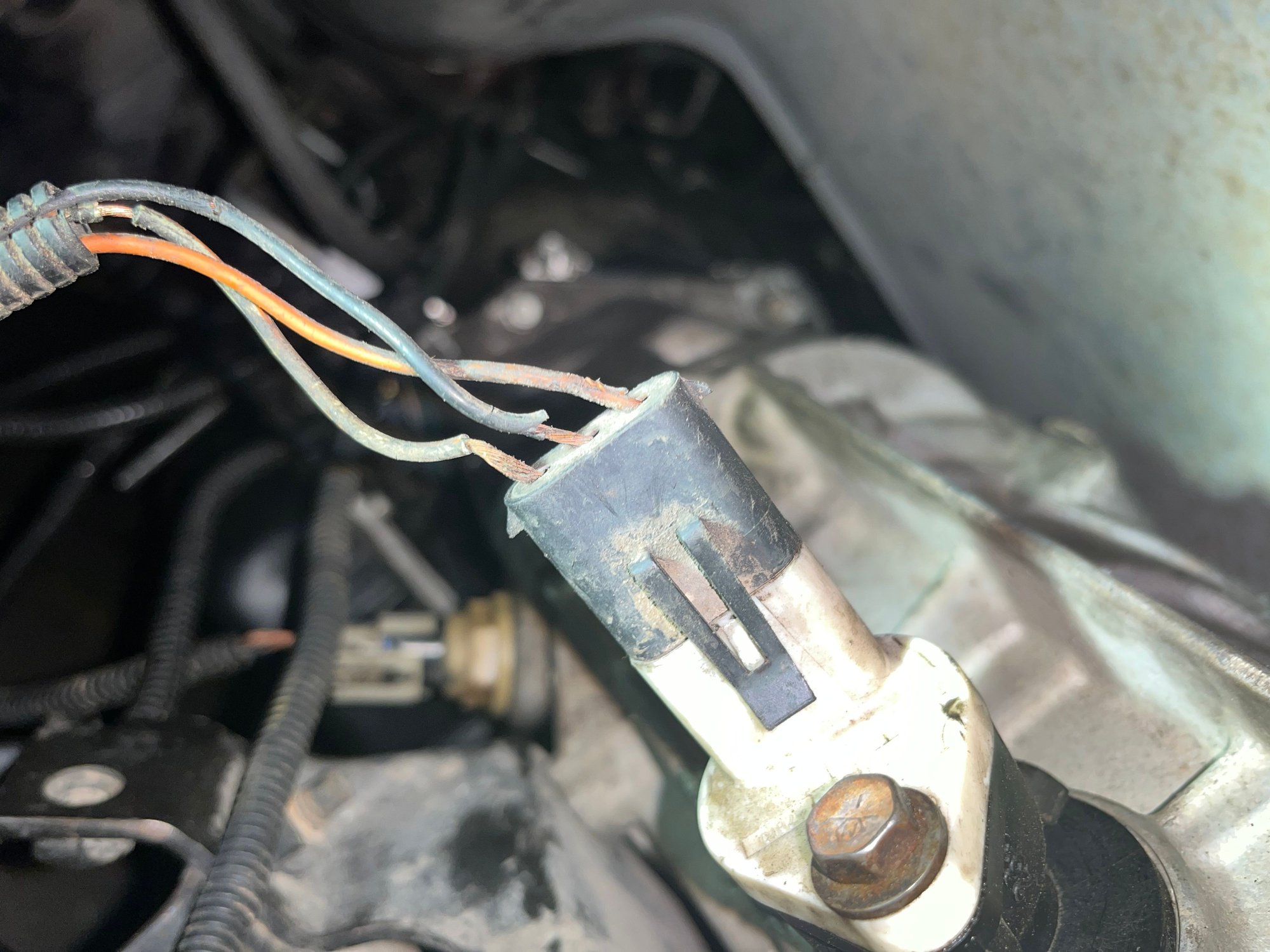

I was talking to somebody and it kinda gave me an idea my rpm gauge hasn’t worked since I bought the truck and when I bought it the trans was working fine but I had swapped it from a trans from the junkyard that was working fine for a small amount of time the problem with the one from the junkyard was that it didn’t have the rear diff vss as my truck has 2 so when I rebuilt the original I didn’t think much of it bc I knew the original had the connection for the rear diff vss but when I went down to disconnect the 8 pin I noticed the wires on the rear diff vss don’t look the way they should or at least the way I think they should could u tell me if the could possibly be my problem?
Nope. That's bad. Need to fix that.
Does your speedometer work?
Speedo works rpmdoesn’t

Well, the engine runs.... so the crank and cam sensors are working..... might just be a cluster problem, or a communications problem.

but I do need to replace that sensor right?

Bad wiring is on the harness side. Replacing the sensor won't help.
so you think there’s a short somewhere in that harness ? Or something to do with the pcm?

What is the exact problem you are having? Are you not getting third, like the original poster, or not getting Overdrive??
