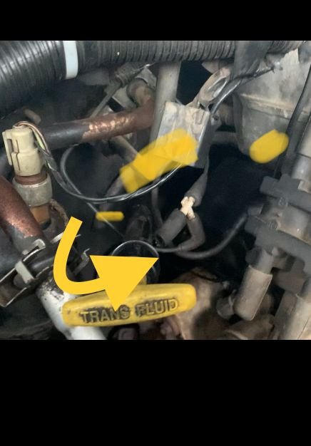

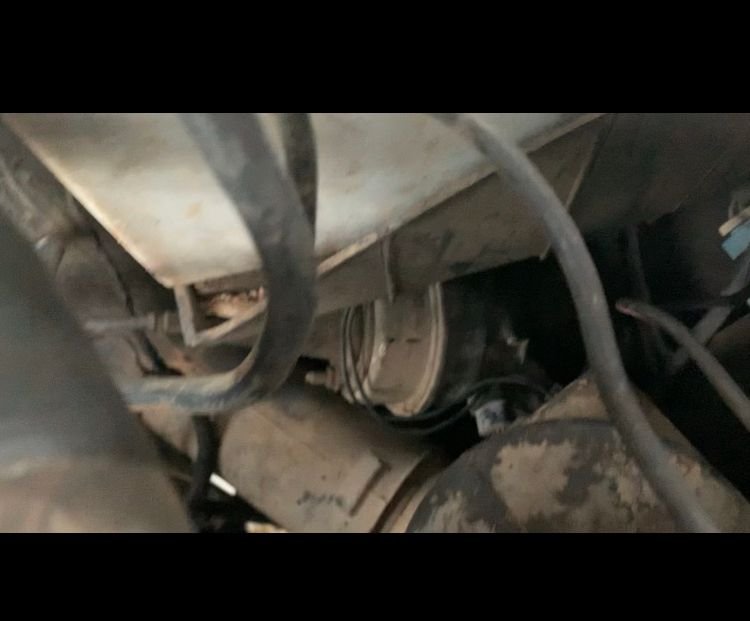

The main things are there’s a tube with suction coming from behind the carb block out and the closets connection to it I can find is this “T” connection of tubes with one side cut. The next thing is this black solenoid behind the drivers headlight. Is this the purge solenoid?
The highlighted part is the tube coming from the back of engine. The arrow is the “T” connection

First one is a vacuum line. Lines go everywhere under the hood..... where that particular one plugs in, I am not entirely sure.
The thingy (technical term) under the battery tray is the cruise servo. It needs a vacuum source to work.

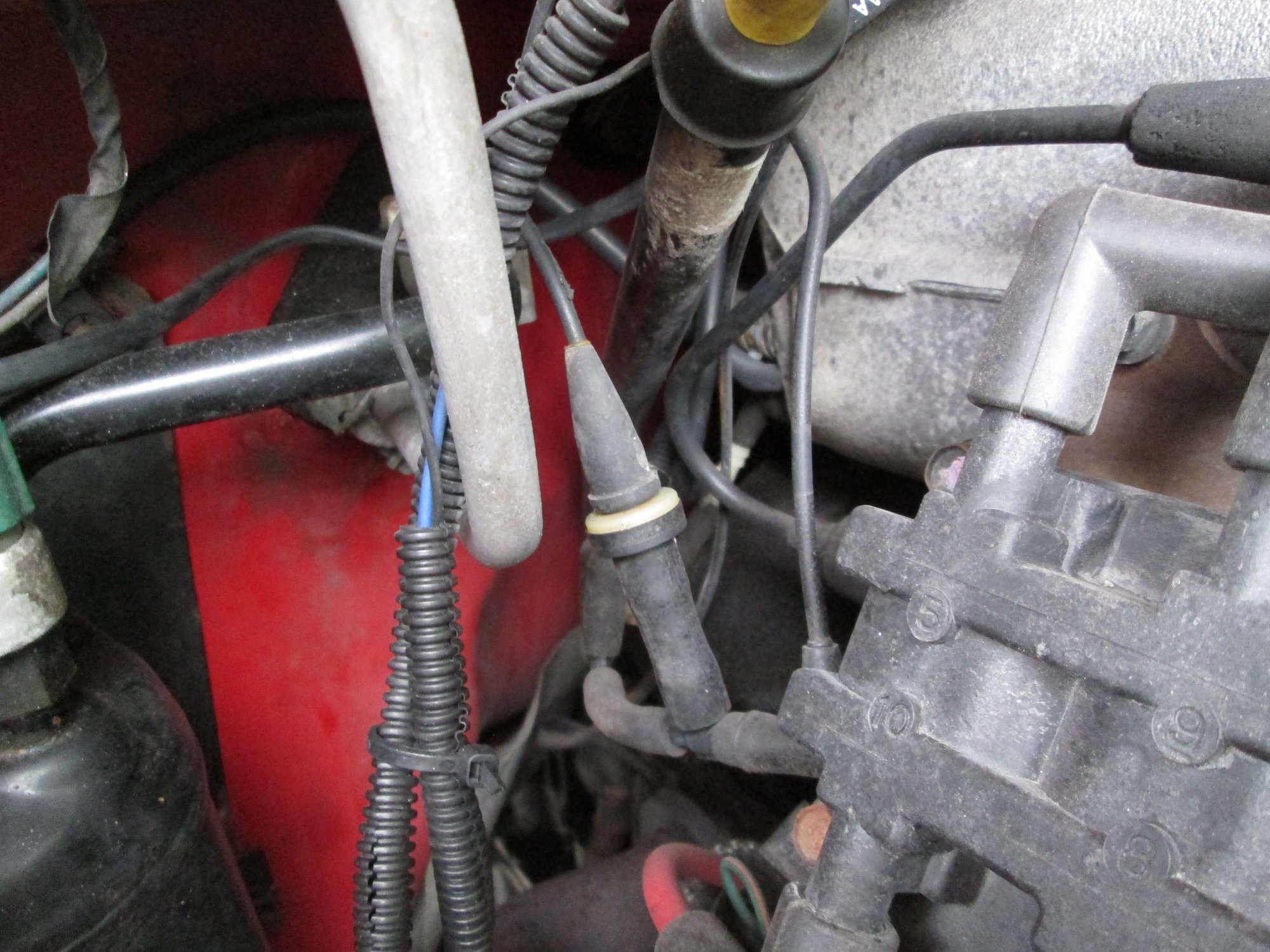

It looks like someone removed a bunch of vacuum lines from that fitting. There should be several inline with that T fitting.

Thankyou for posting a picture of yours, I’m gonna have to find a vacuum diagram to put this back together because I have no idea where things go.
