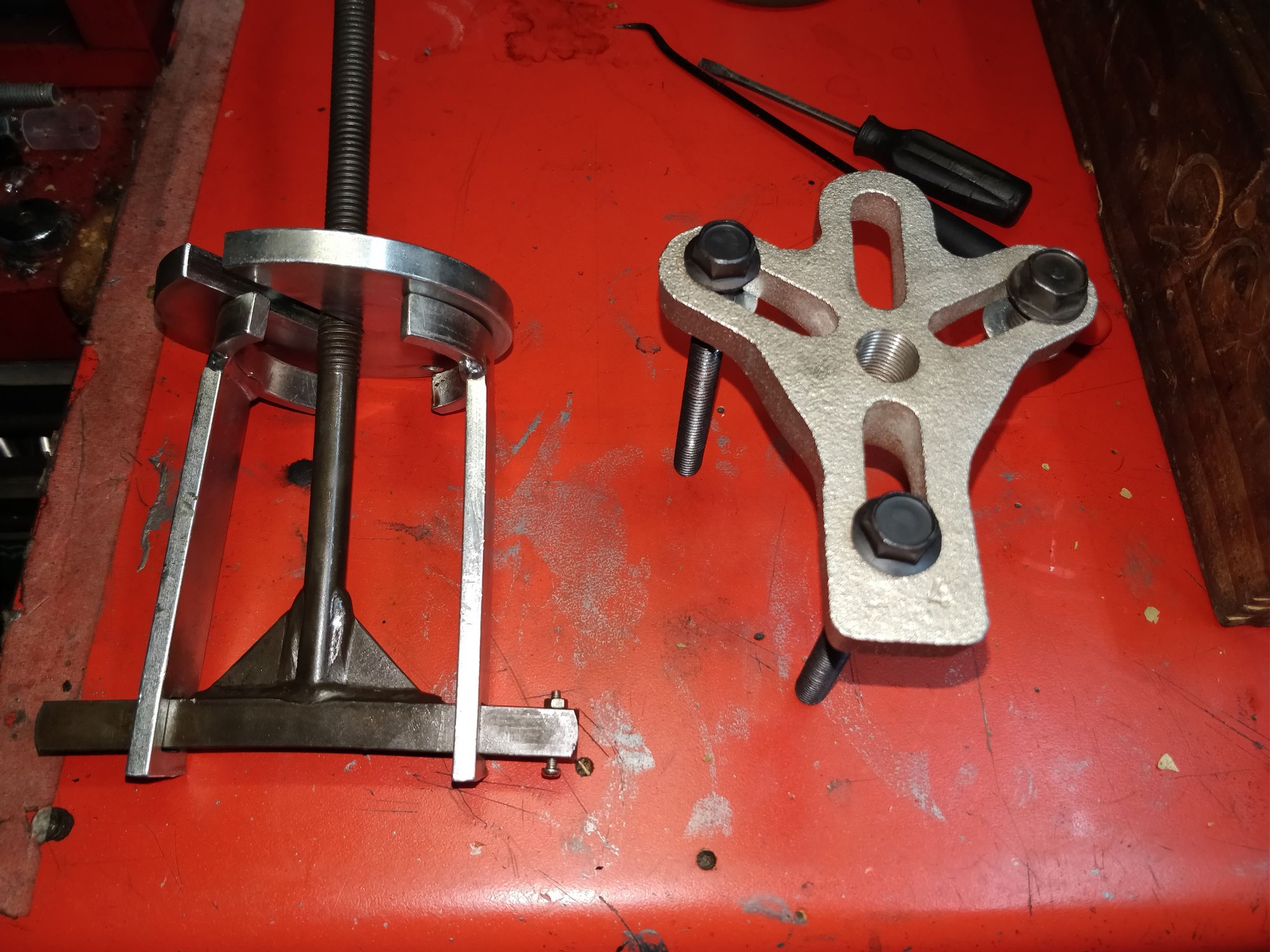

I have everything needed to get the overdrive torn down now. Cheaper than most tools. I can look into replacing the what I have with steel. My thinking is my slipping issues come from a pressure issues that are most likely seal related. I have replaced pretty much everything more than one without getting into the valve body other then the spring.
As to the valve body. I am just going to do as the zip kit tells me. I am using the 46re class video to walk me through tear down to rebuild. It shows me ways to test everything as it goes back together. Everything is going real good so far. I just had to make a couple of tools to release parts under pressure in a safe manner. Just taking my time and no rushing to avoid mistakes.

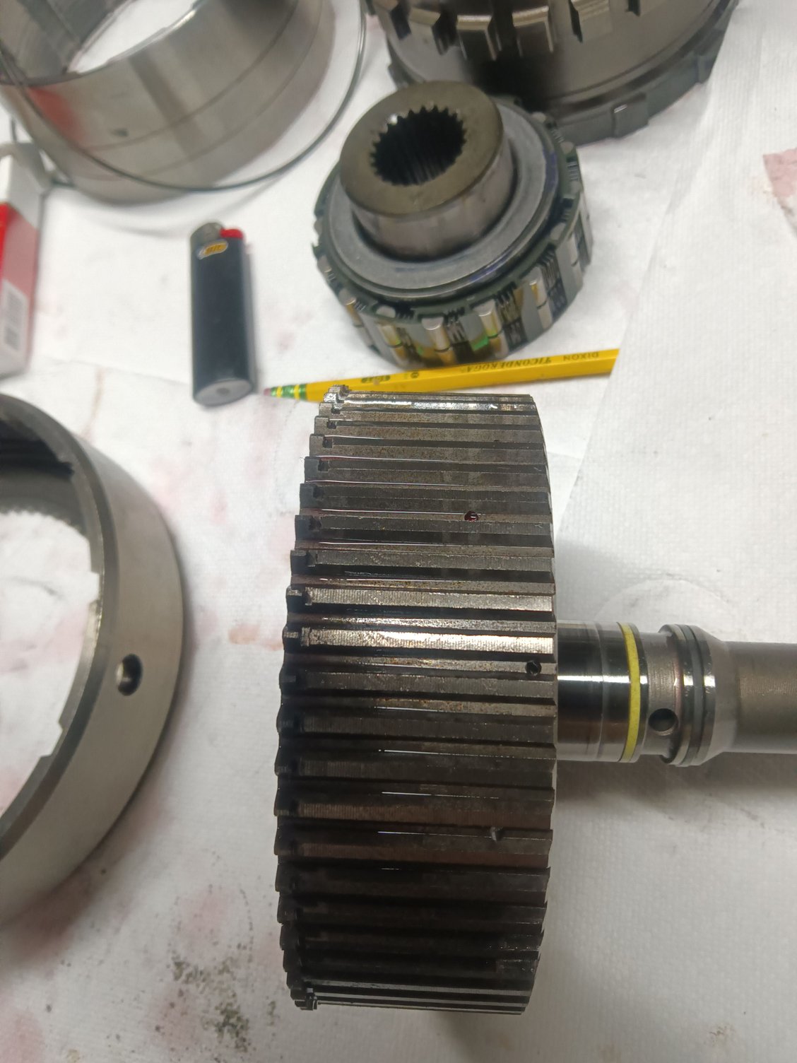

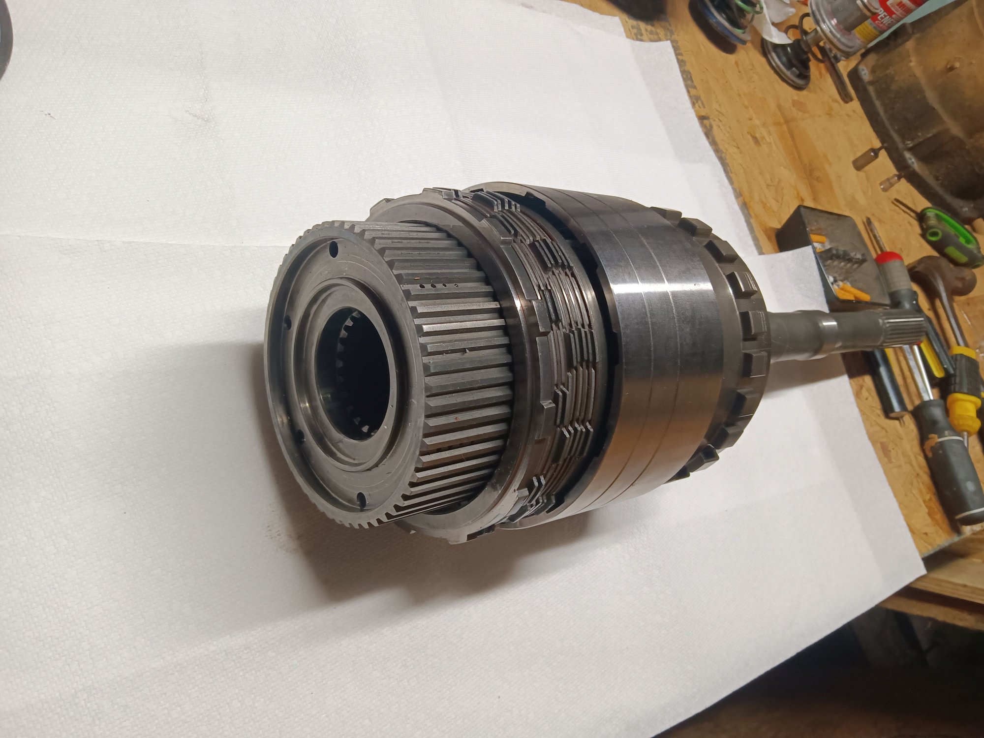

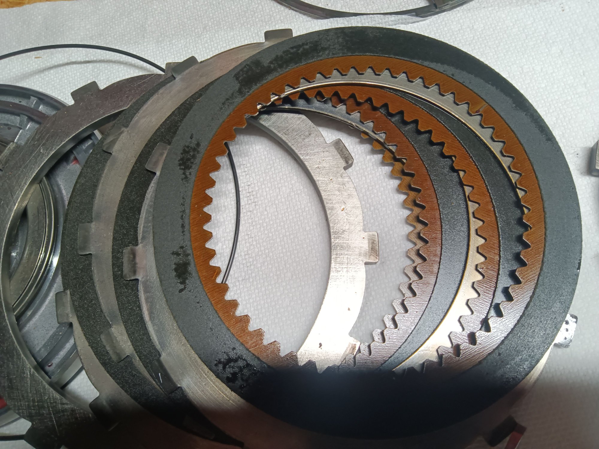

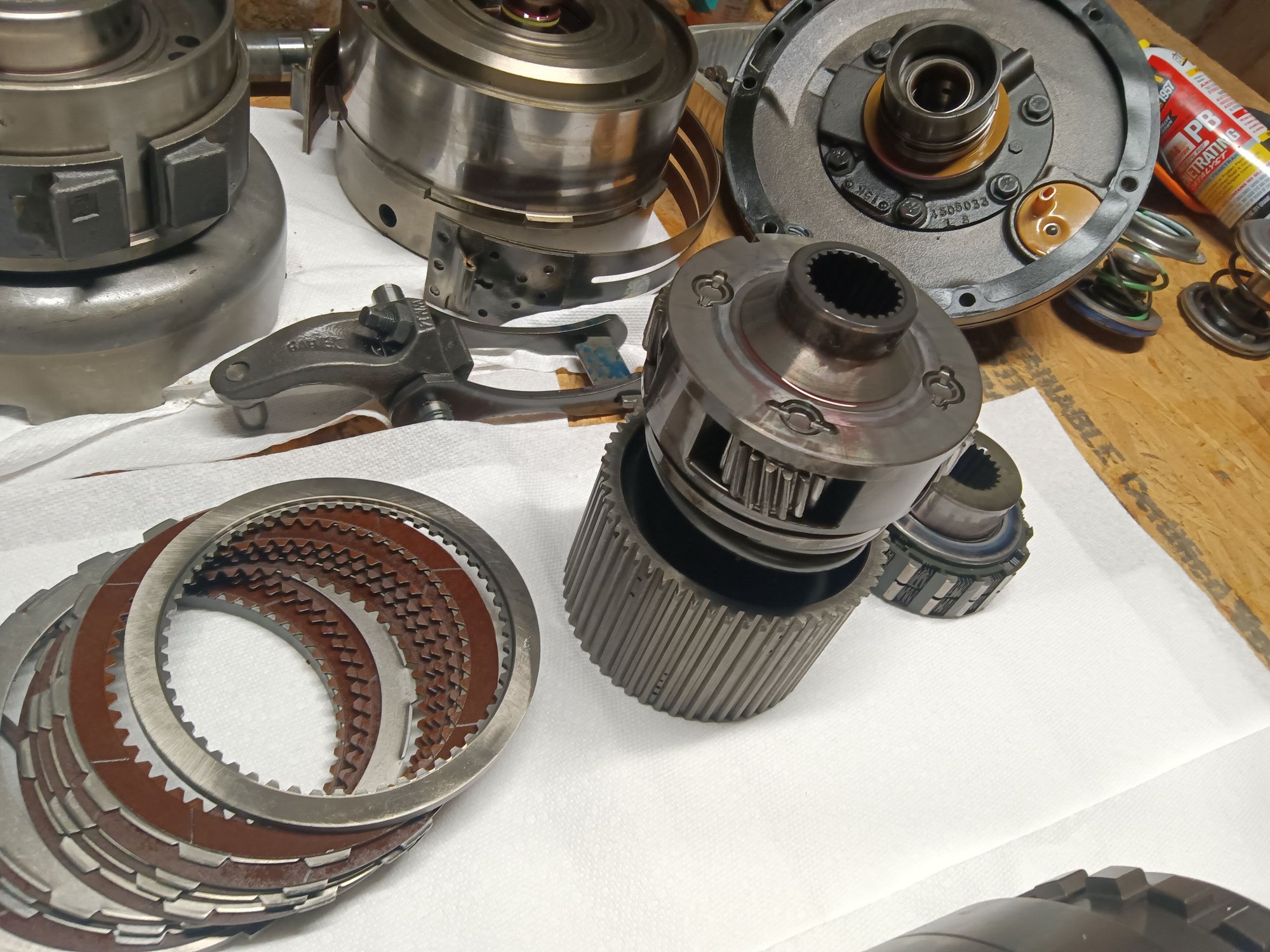

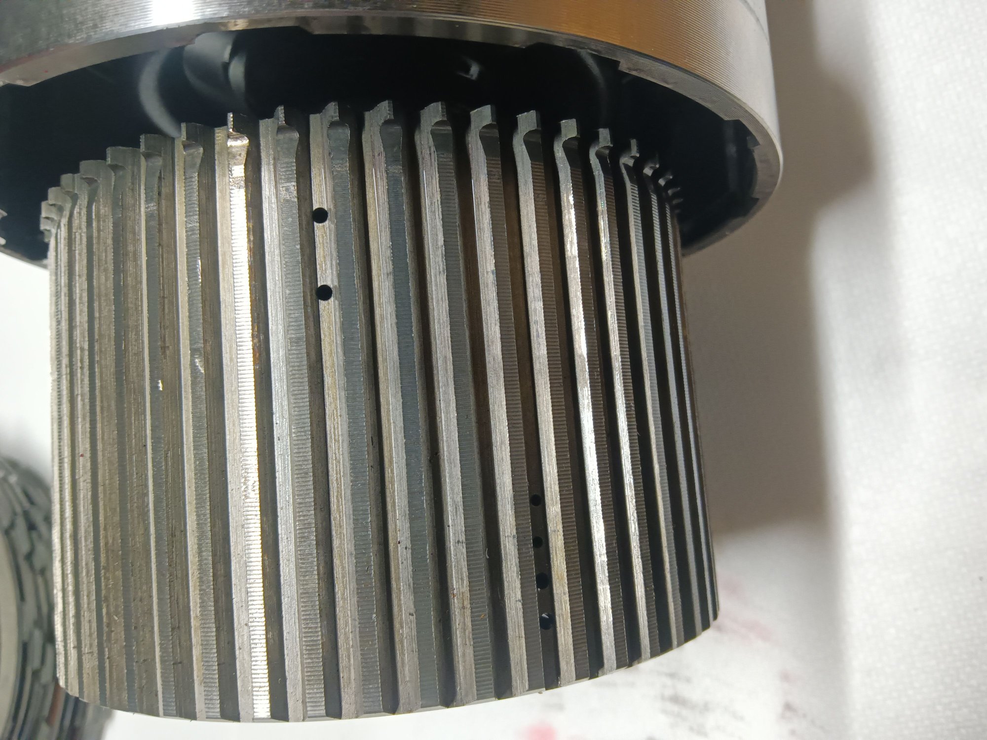

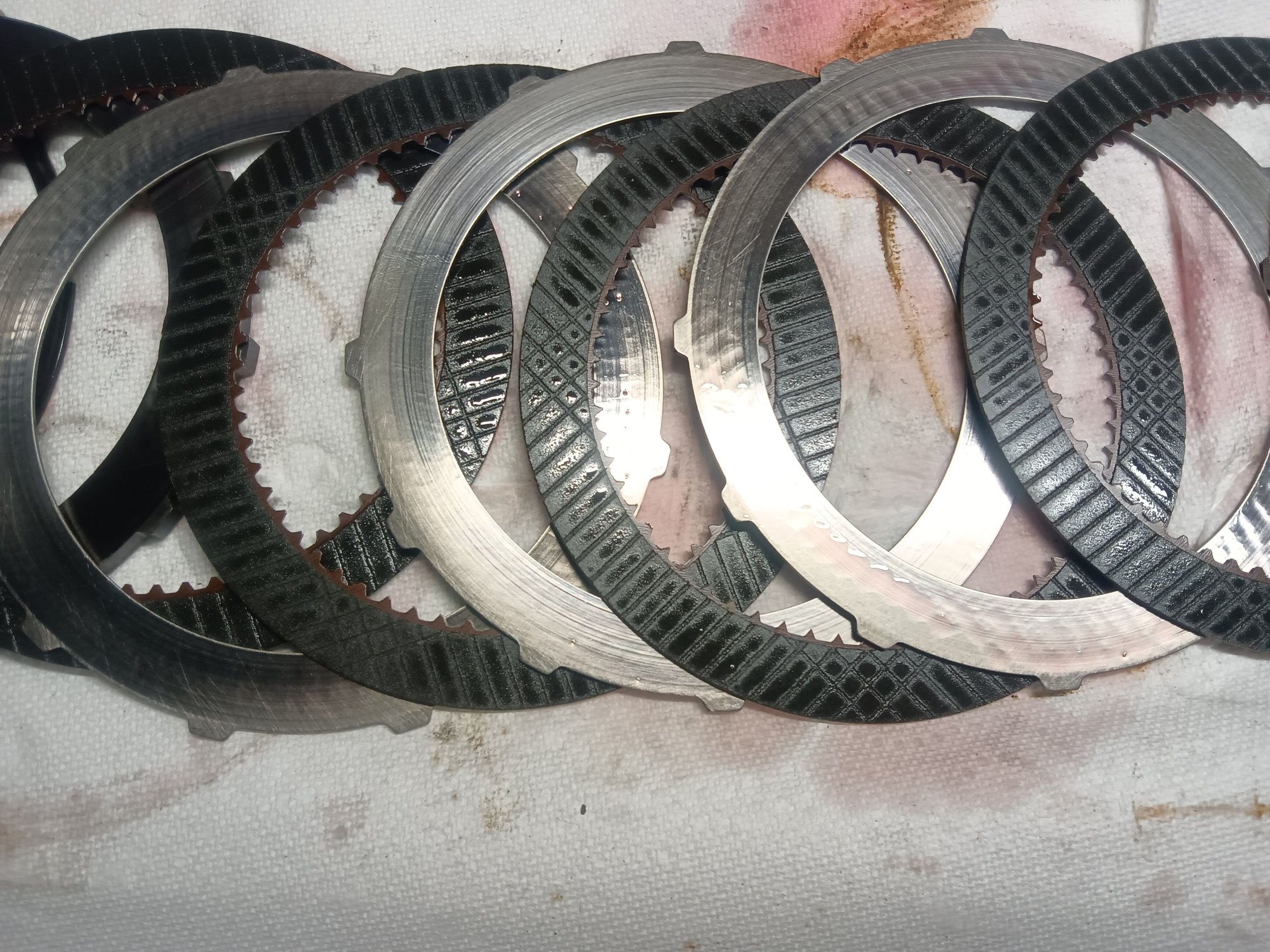

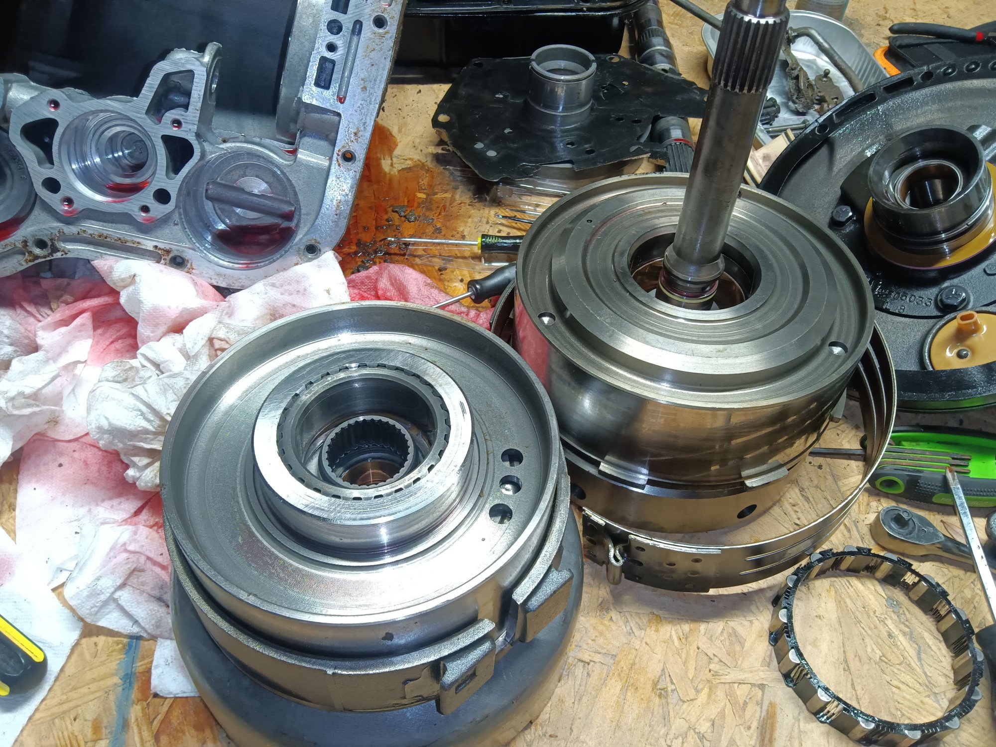

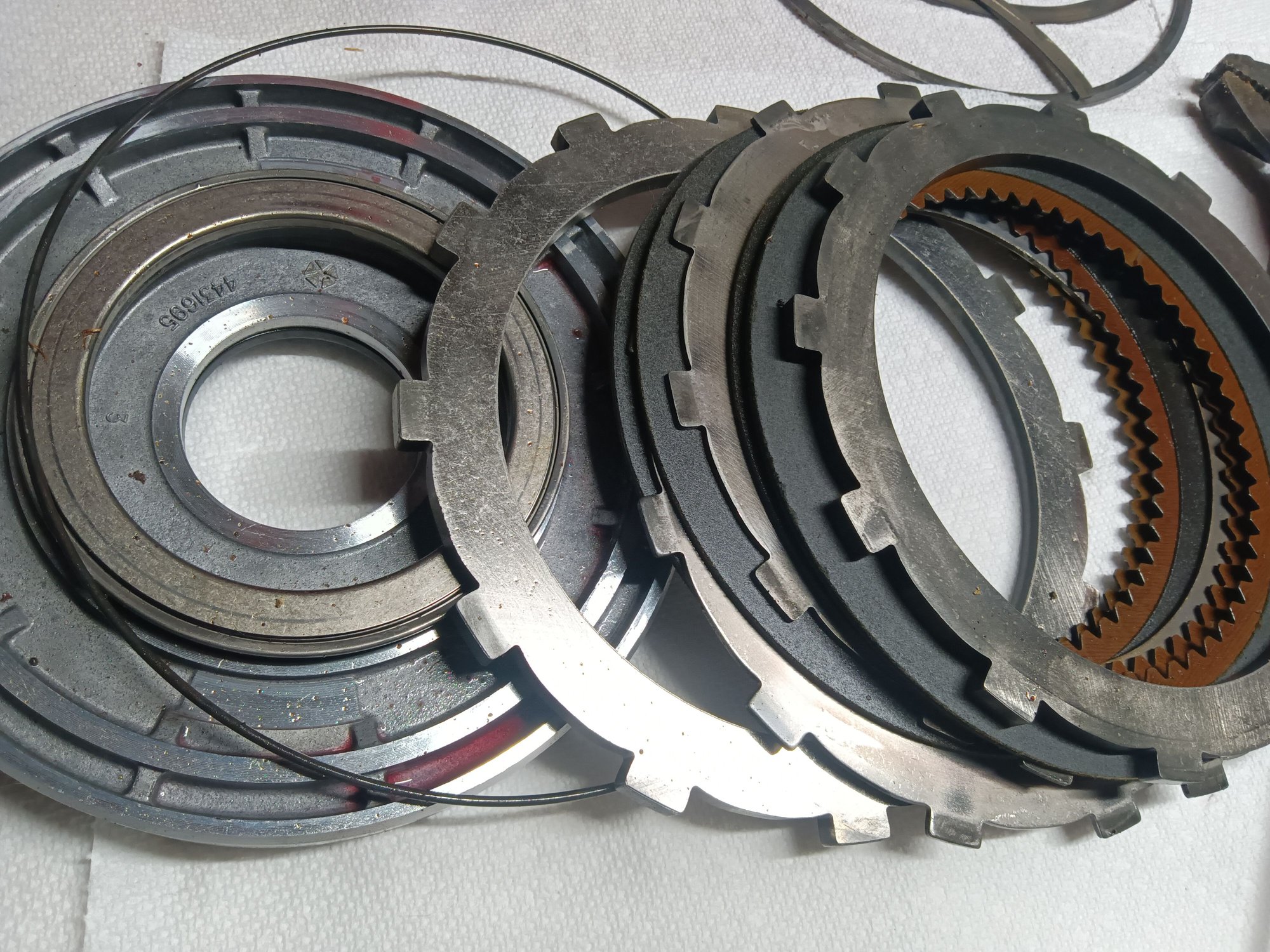

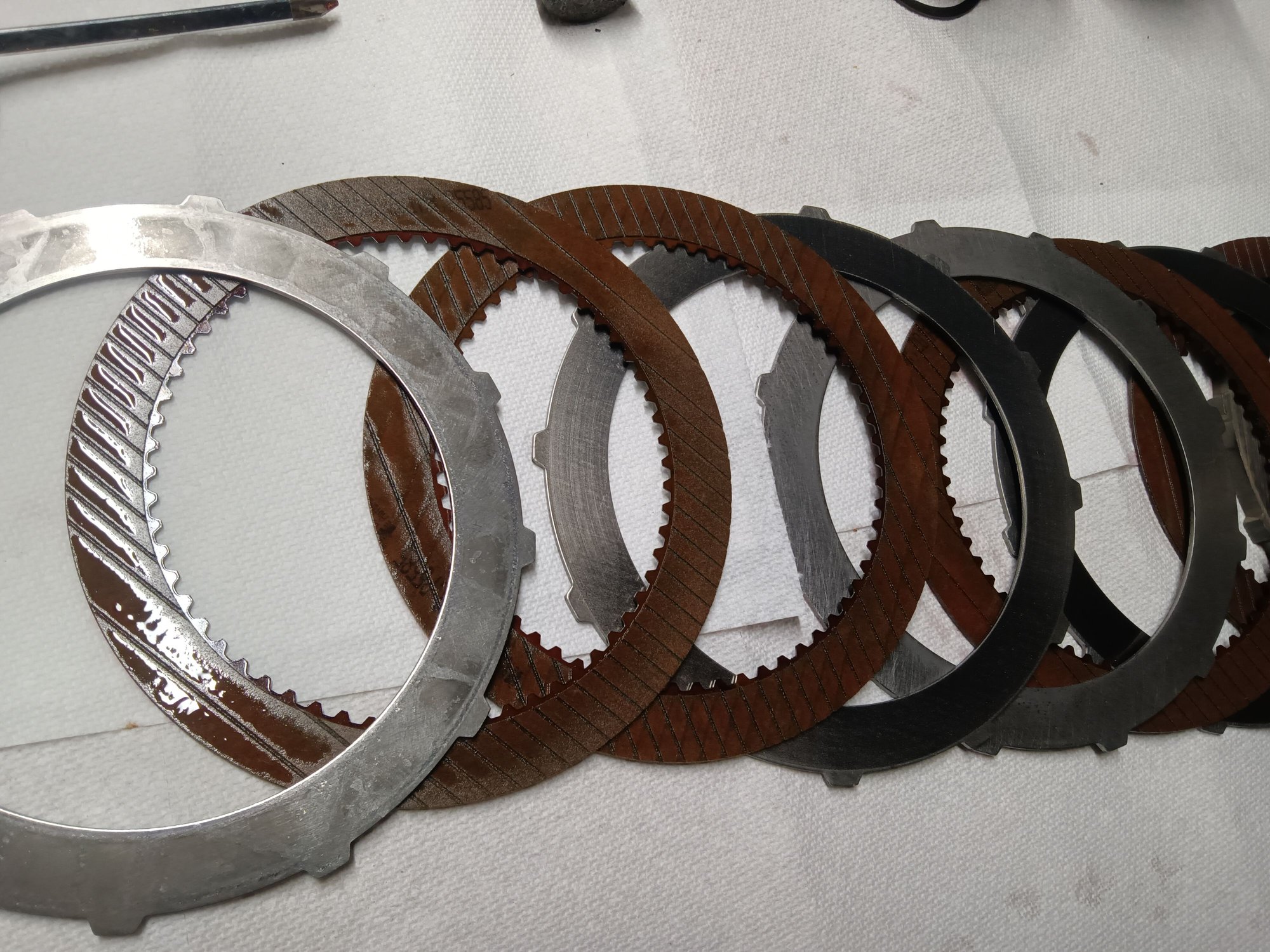

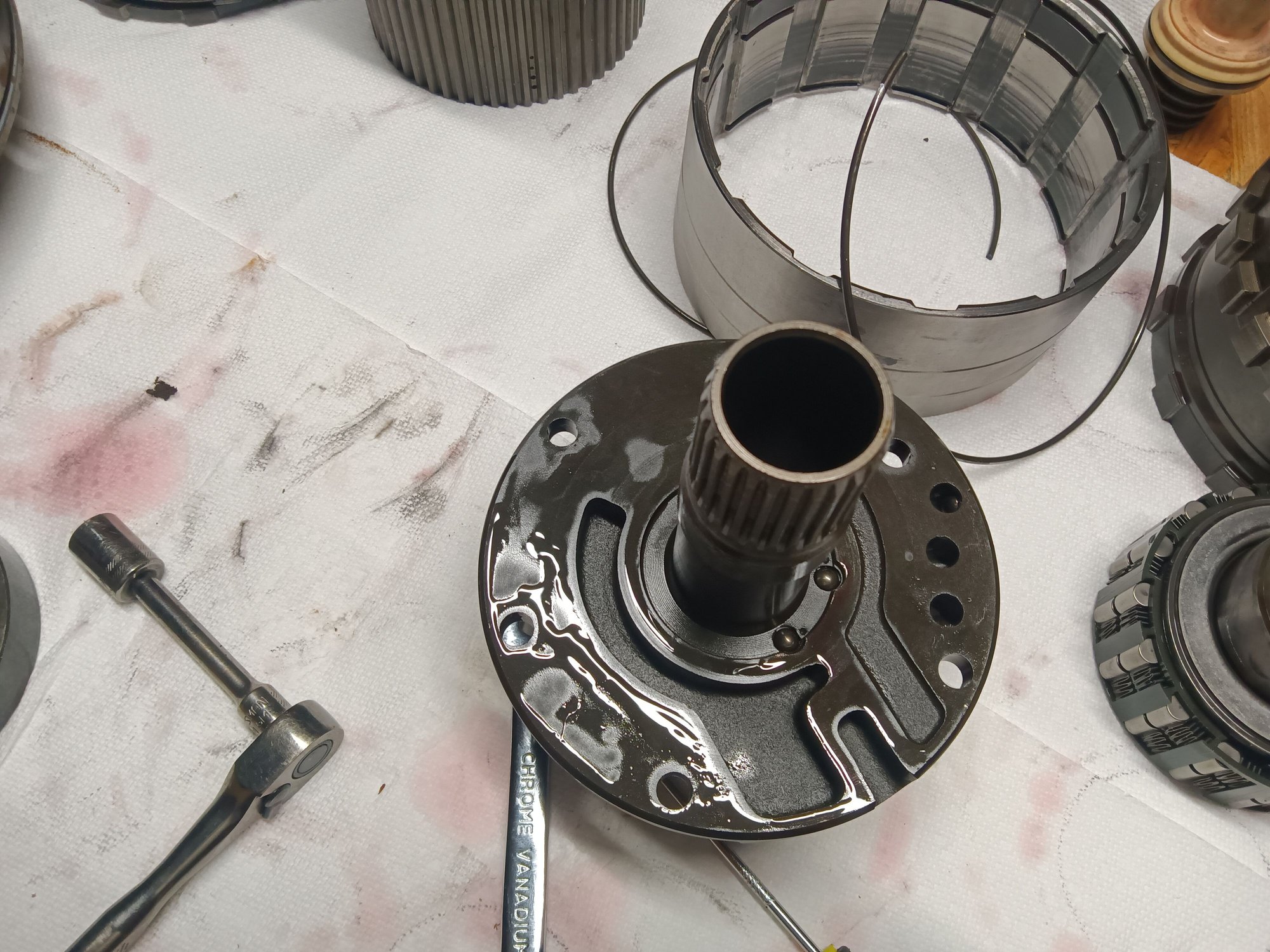

Everything is torn down with the exception of the valve body.( That will be last) I will post a few pictures but everything looks great. Even the friction disk are in good shape no signs of wear. You will see in the pictures. I did run into a issue with a set of steel and friction plates that are not as they should be. I don't know if it came from the factory or how I could have flipped one since I pulled them all together and only spread them out for pictures. I have one set where you will see two frictions plates are together and two steels are together. It should be steel, friction, steel friction and so on. It's not here.
Is it possible they did this and how would it run for years without issues? I even looked in the transmission book and it doesn't show in this order. I went back and check if maybe I did something that could achieve and it can't be done unless you took a plate and a friction out and swap them. Other then this stack. Every other stack is in order as they are meant to be.
Here are some more pictures of everything done today.
Here is the tools I made to get the overdrive out.lol

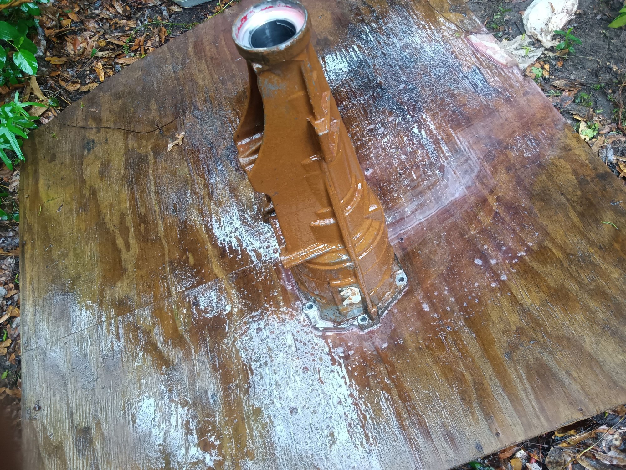

Will start cleaning and rebuilding this coming week. Still trying to get the red clay off the housing. I need to get the main down to have the threads bad either re-threaded or heli coils put in. I will continue to update you guys. Thanks
