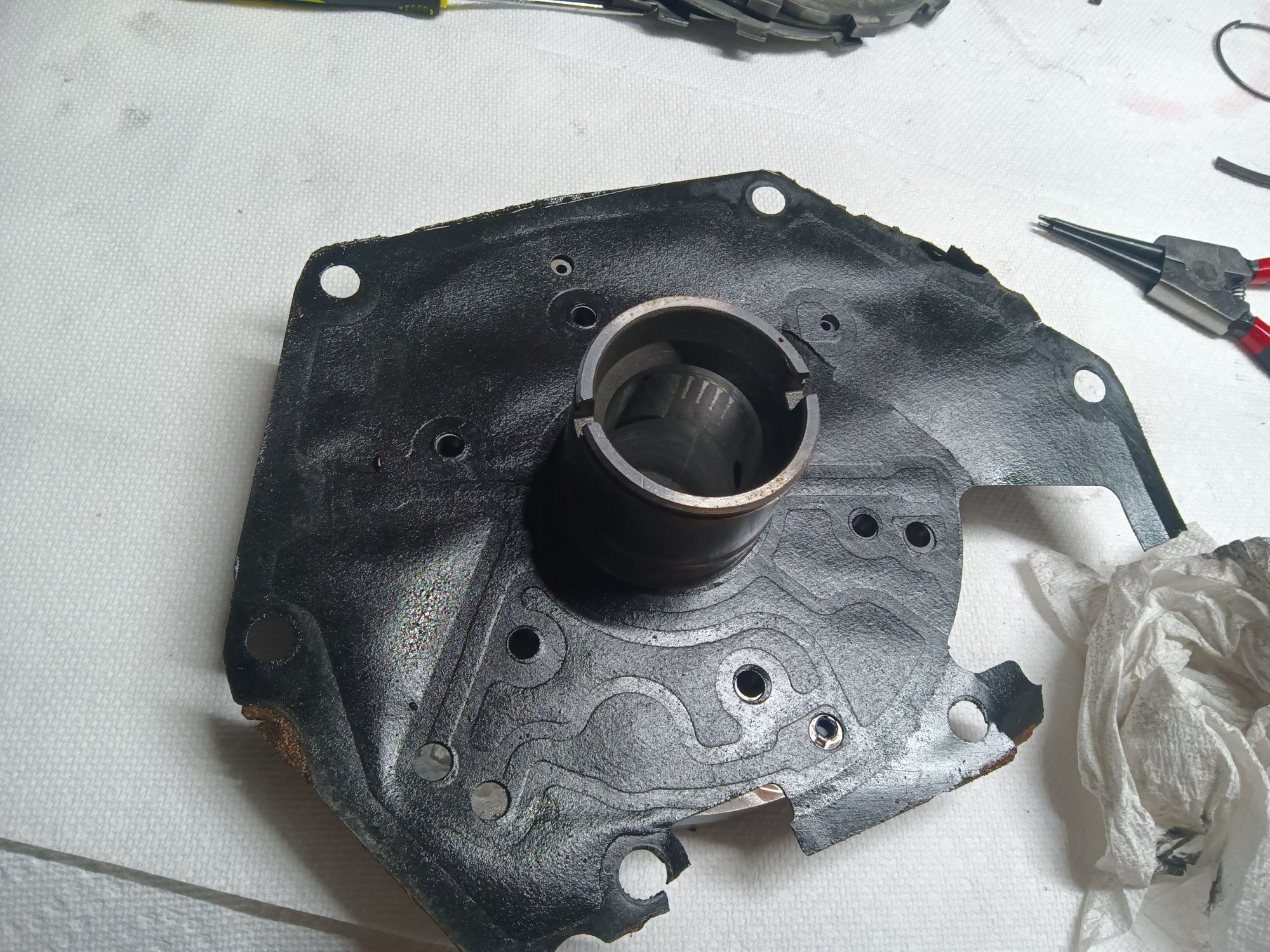

Ran into a snag with overdrive. I got smaller bolts for my jig that I used to compress the spring. It seems I will have to go down another inch in size since its barely getting in there to do it's job. I did get it in but noticed that it would press at a point. Released it and was looking to find why? Well this is what I am seeing. I don't remember seeing any scoring before so I am curious if maybe I was off a little and did this? It is very light but my question is if maybe taking a high grit sandpaper to smooth out enough to allow the gears to work as intended. I took a pick and light pull and some of them just came off but I would prefer them to be smooth as they should be. I am posting pictures and getting some advice here. It's just enough that it wont allow the press to push it down.

I would seriously consider replacing that......
I'm not sure of the correct name but have looked and so far can't find one. I am thinking I somehow went in not completely straight and I guess you would term gouged it lightly. My press is small so even though I drop from 4 inch bolts to 3 1/s. I really didn't have the room but tried.I was thinking and it slide in fine before I went to cleaning and doing rebuild so it's my fault. Just have to fix it either way.

Might try a fine file to clean it up....
I didn't think of that. I can go buy one in the morning. I need to get some smaller bolts anyway. All I can do is try and if it comes out good, then ok, If not. Then I will continue to try and find a replacement. I didn't force it so my thinking is it very extremely light like a scratch. Being it's in the gears. I might get lucky. They are tight as heck with no play what so ever. If I can bump enough to slide by, I should be good. Thanks
