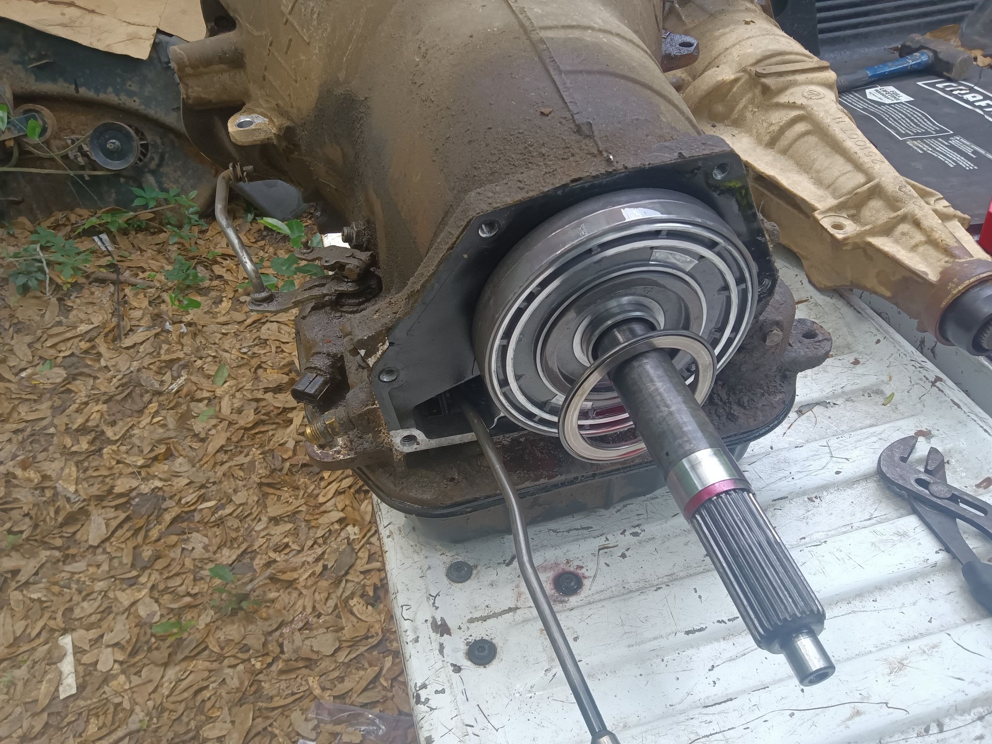

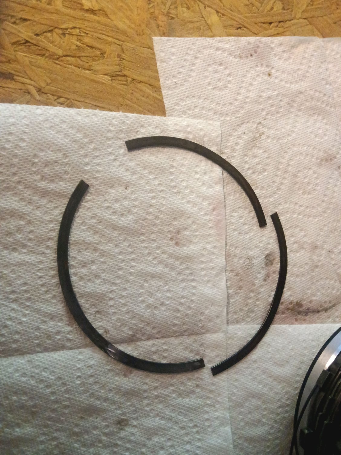

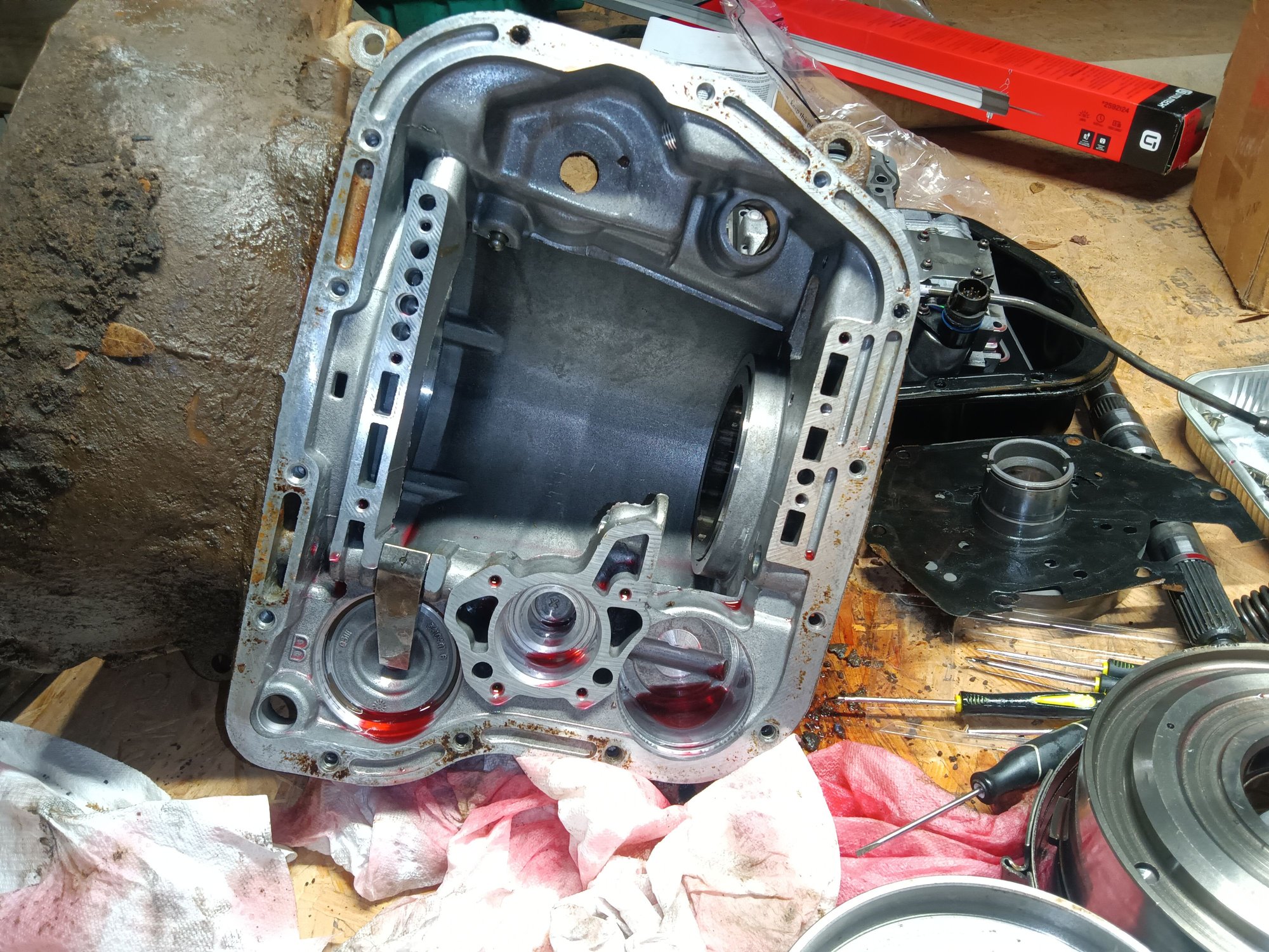

It was the rear bracket that I thought enough of it was removed but nope. lol. I did get the transmission down and removed. Dropped the over drive off and removed the convertor so I could carry it to my table in my little shop. I have some pictures of it both together and the tail off. I did find the first retainer broke as soon I went to take it out ( Video shows wavy but mine is flat). The everything else looked good no real signs of wear. I will post some pictures of then when I get back out there.

Basically, I did a light tear down since I had to pull the tail off to be able to carry it. I didn't do too bad for a one man pull for my age. I will definitely use a helper when putting it back in. I have assembly lube coming it this week. I figure I will take my time during the week with the tear down and make sure everything is laid out as the video does. I will update as the progress goes and get pictures as well. Thanks

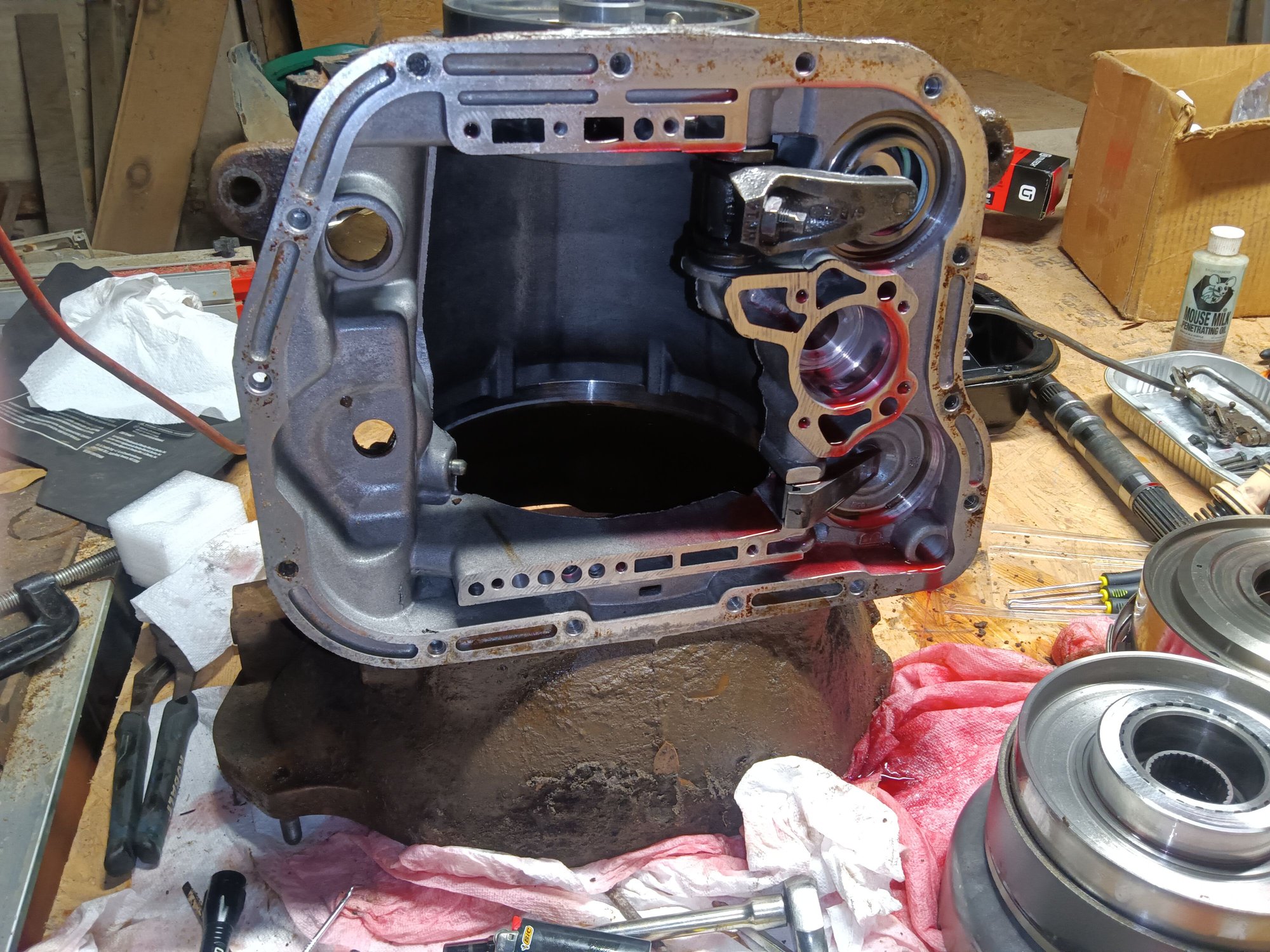

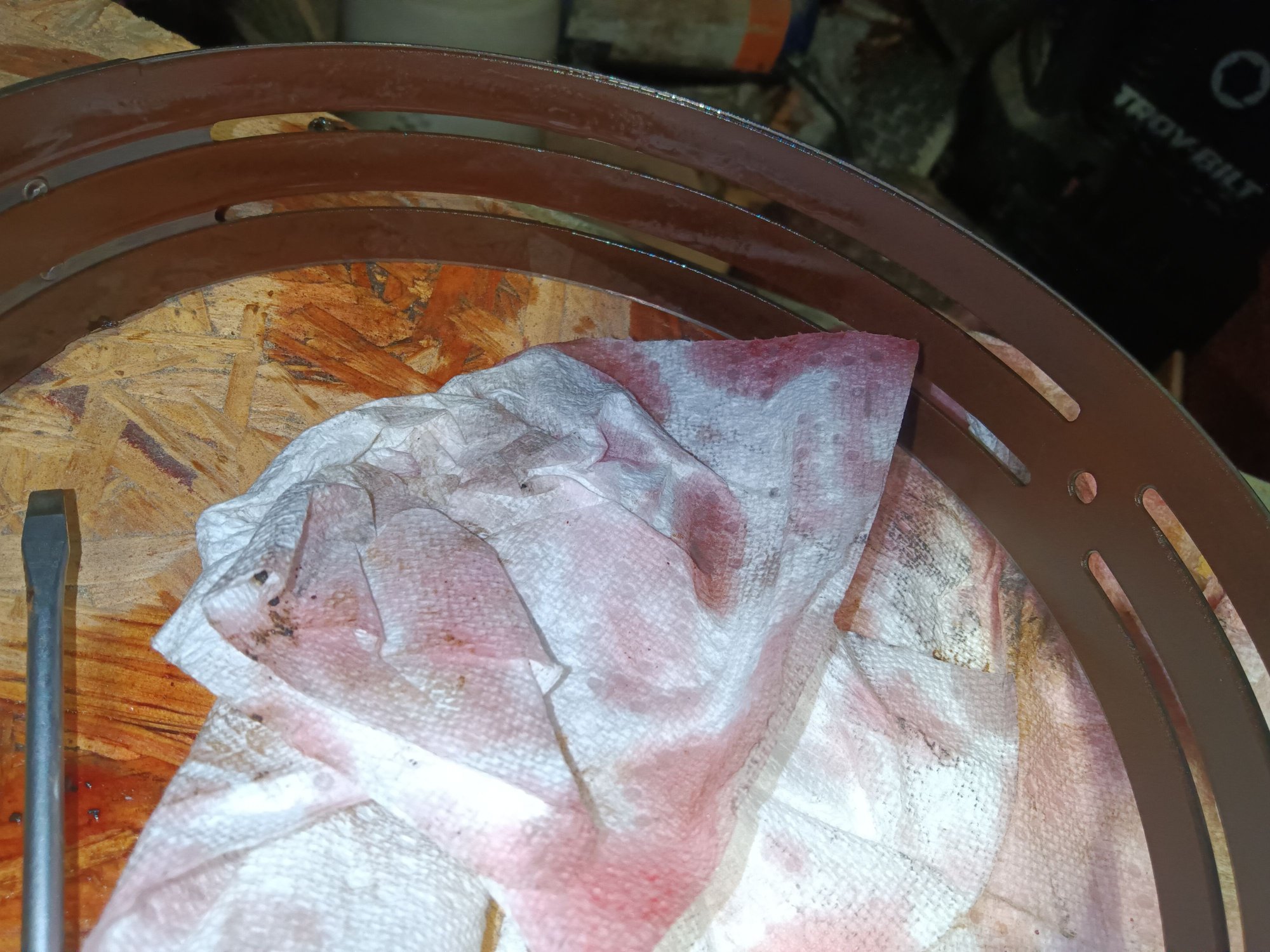

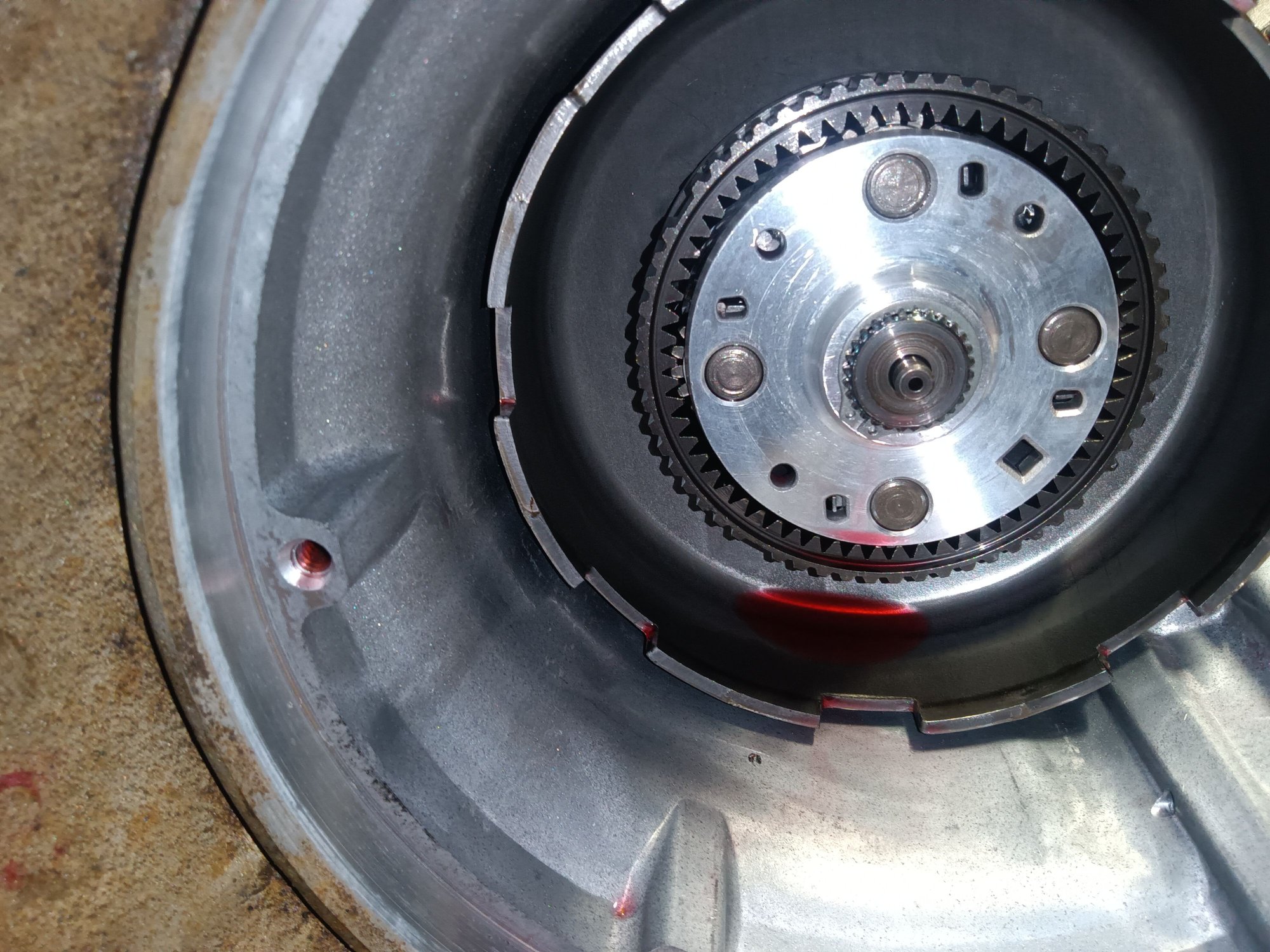

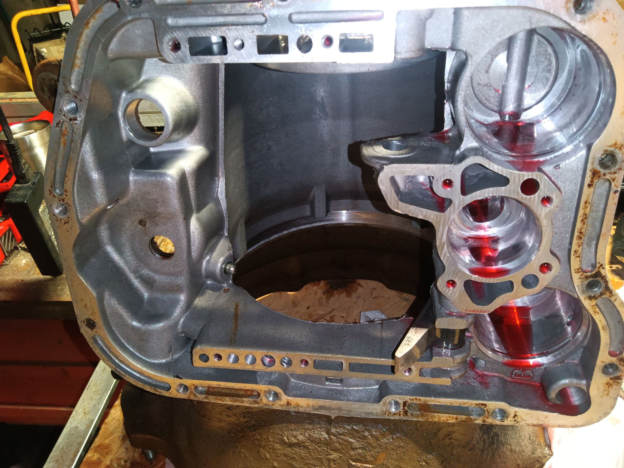

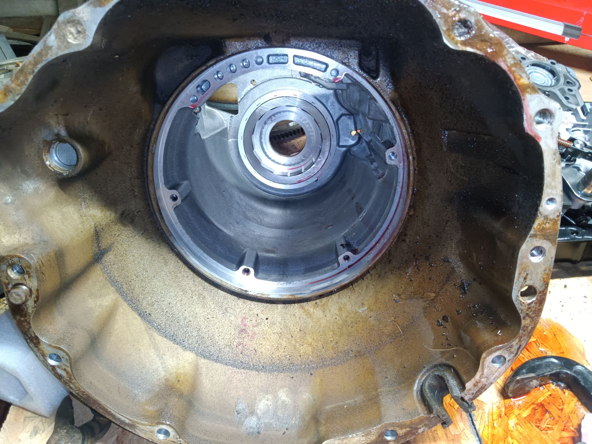

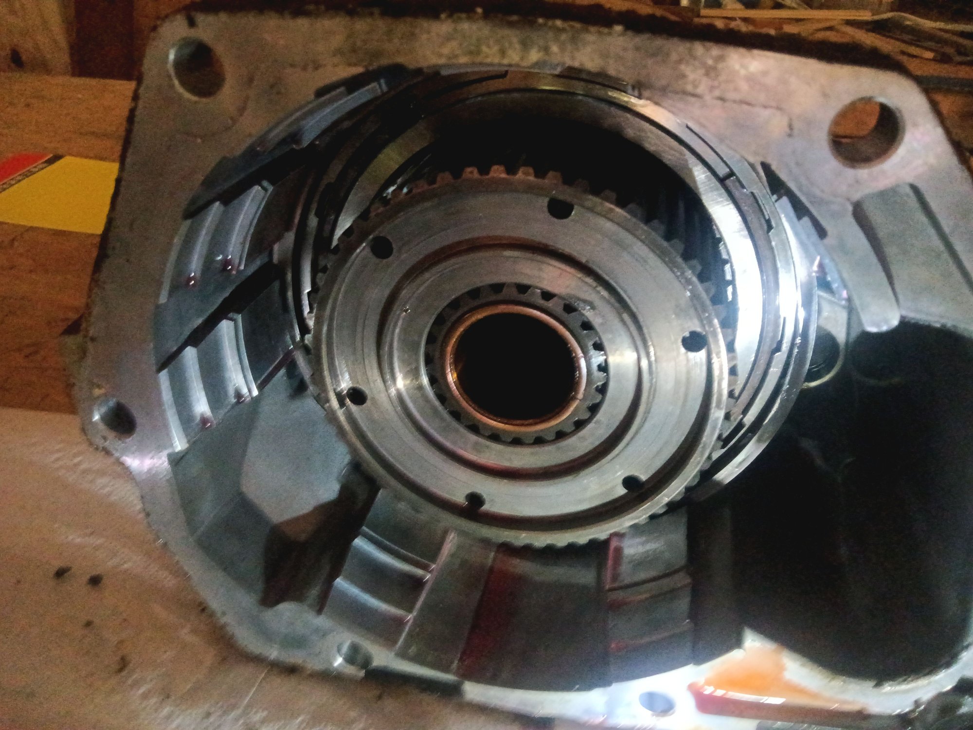

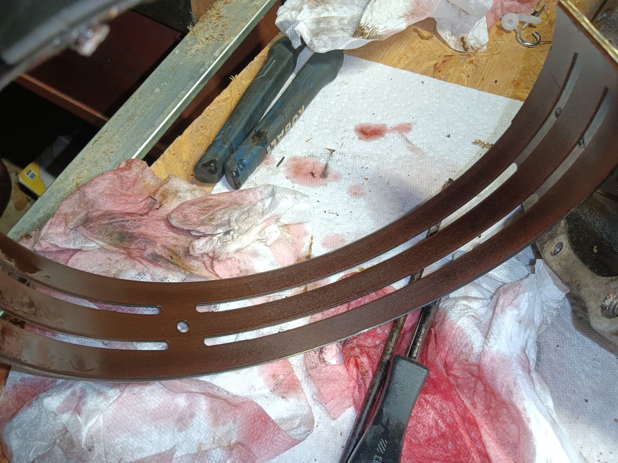

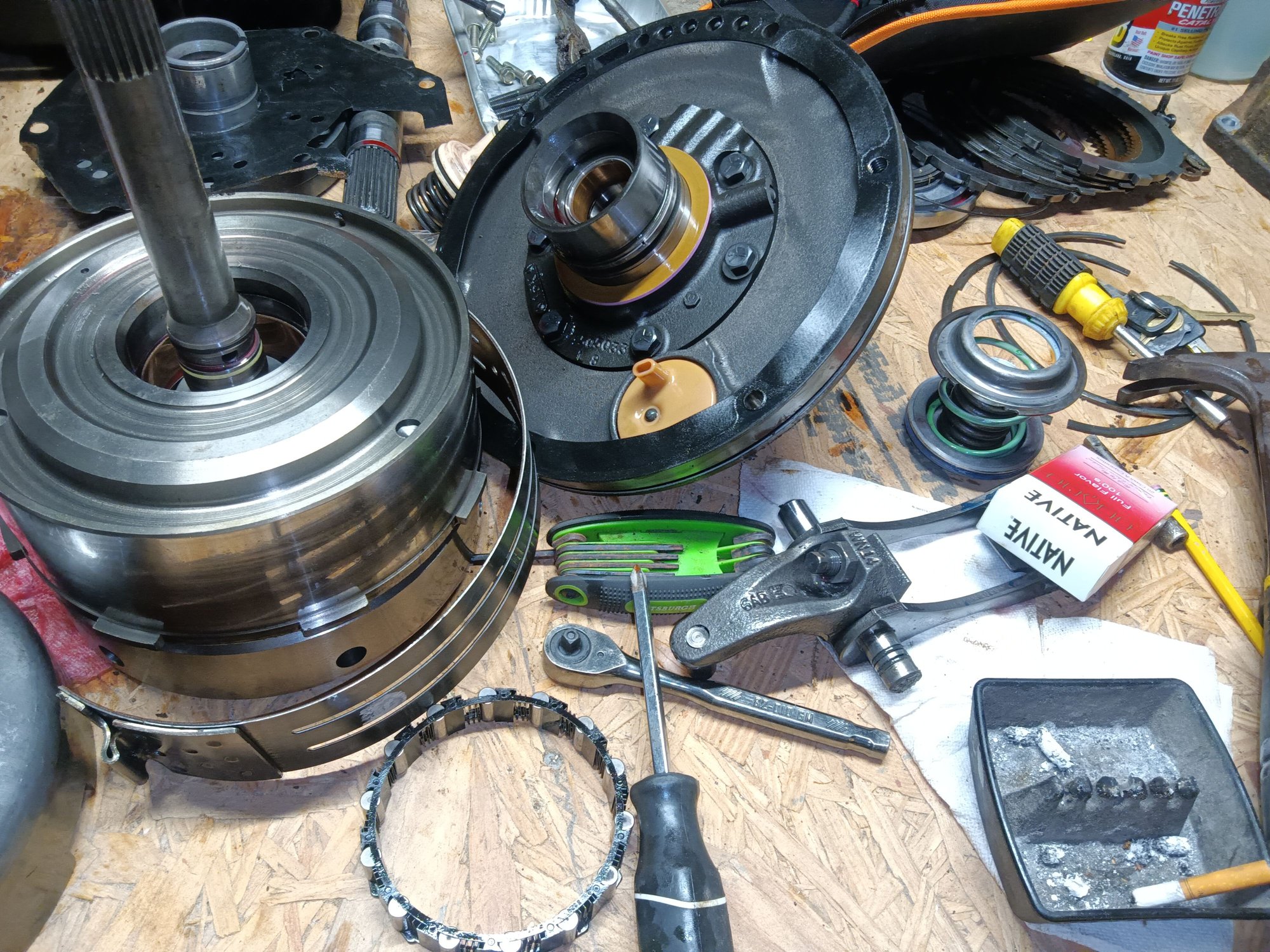

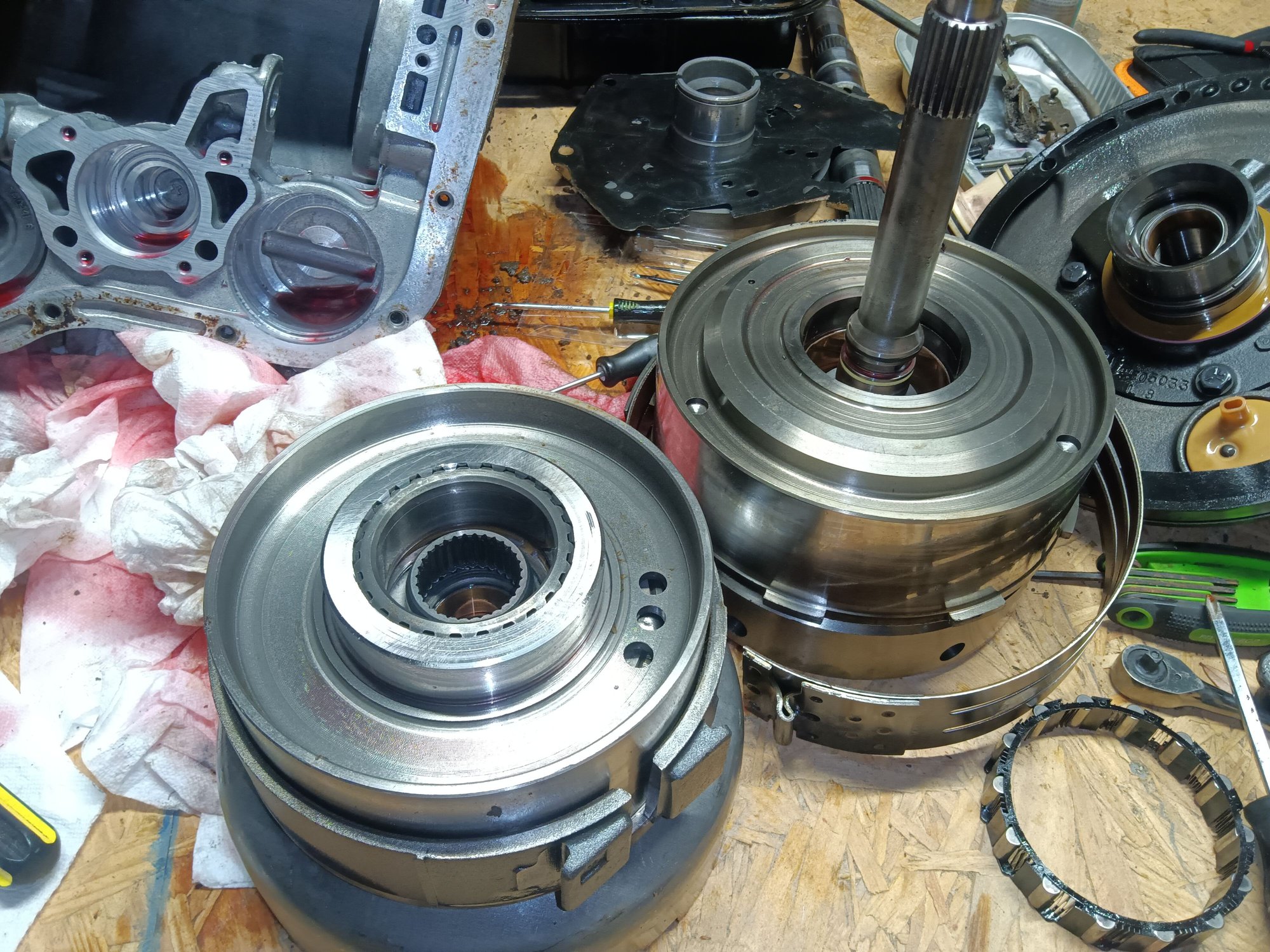

Another Update: Well tear down is complete. Didn't see any real wear but haven't gotten in the disk side yet. Band looked really good no wear spots. I did some pictures. I'm weird but I am actually enjoying the process and learning a lot.
As you can see. I live on a dirt road. Next is pressure washing the case and getting it clean. I did see some slight gray colored sludge here and there but nothing seemed damaged so far. For a 166,000 miles on it. I expected maybe worse. Gaskets were hard and somewhat stuck on. The video goes into rebuild and trouble shooting. It also shows you how to test with air to make sure everything is working as intended. I still will have to find time to drop off case to have it repaired of the two stripped bolt holes. I will keep you guys updates, Thanks

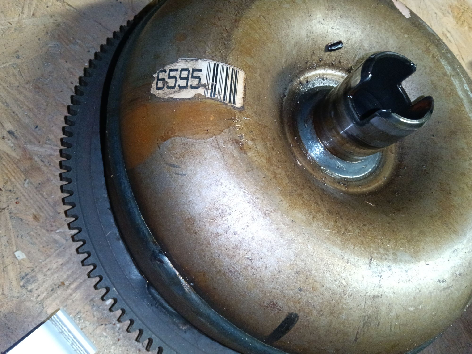

If you have looked through the pictures. There doesn't seem to be wear signs. I am waiting for friend to make a three leg to use with my press on the overdrive so I can get access to those friction plates and such. So far they don't anywhere near end of life. I am starting to think maybe the problem may have to do with pressure and seals. I'm going to contact the guy about the converter and work out the details to buy it by next weekend. Everything came out with no hassles and nothing is chewed up or scored. All the bearing are smooth no sounds. I think so far I have been lucky. Once I get the others dis-assembled . I will post some more pictures. Thanks Guys
