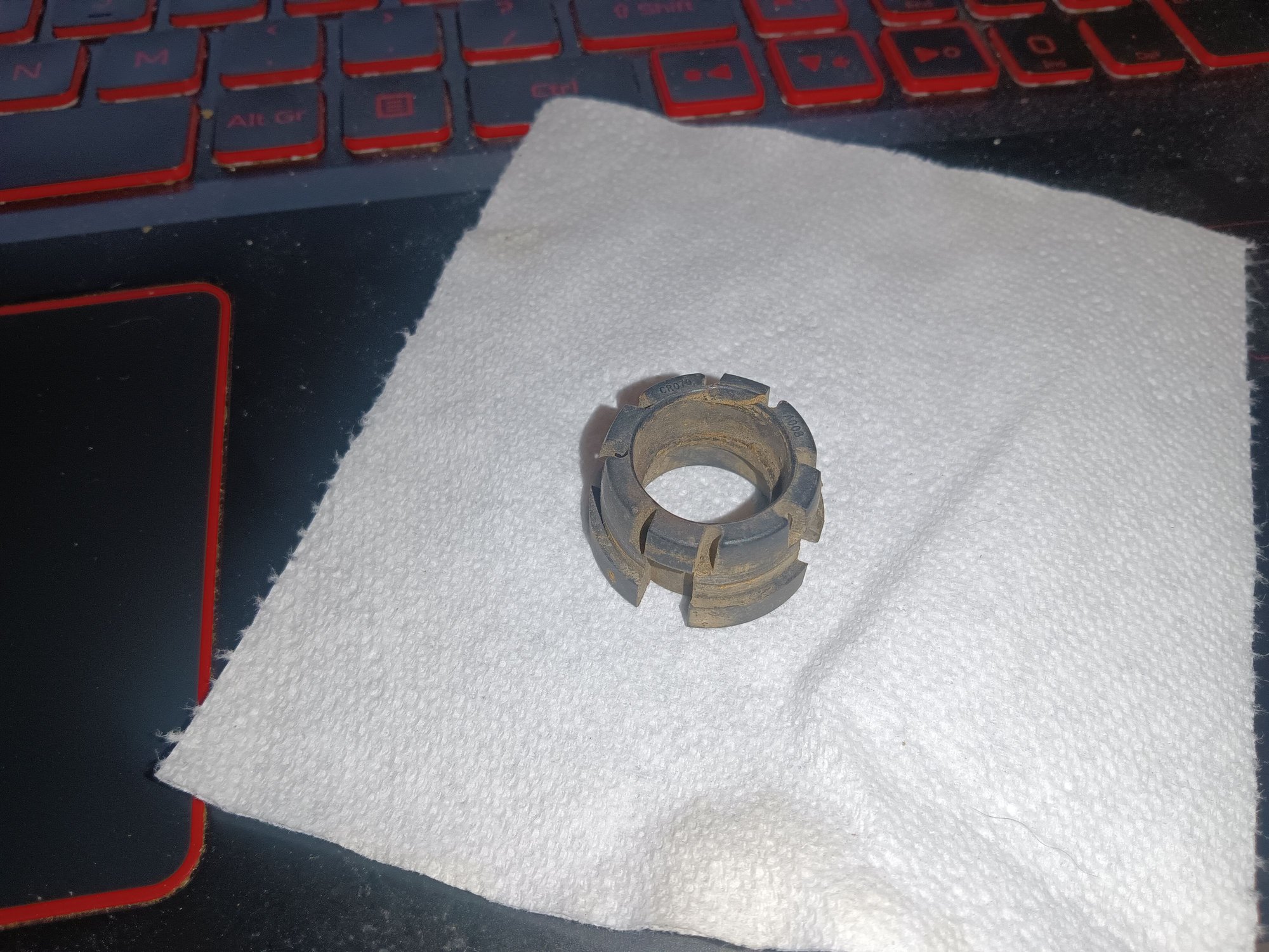

That is something I do need to look into. It use to be a firm through lever when putting into gear and I have play now which bugs me. I did find this under the truck while putting in the transmission but could never figure out if it had any place for it or it was something just laying around before?
I am starting to think this may be why I am feeling so much play.

See if you can find where the play is coming from, second warm body will help there. My guess is, when you find the play, you will also find where that goes.
I think what I posted is the gear shifter bushing and that is why I have the slack now. I just need a good picture to help on how it sets in place. I guess I was so busy thinking of everything else that I overlooked this part but was lucky that I didn't loose it.

Does it go in the base of the steering column?? If so, check out the Ram Rock Solid Steering Fix.

I believe that bushing is definitely part of the shifter linkage. A shifter linkage rod should go through it and that bushing should likely be in one of the stationary brackets.
