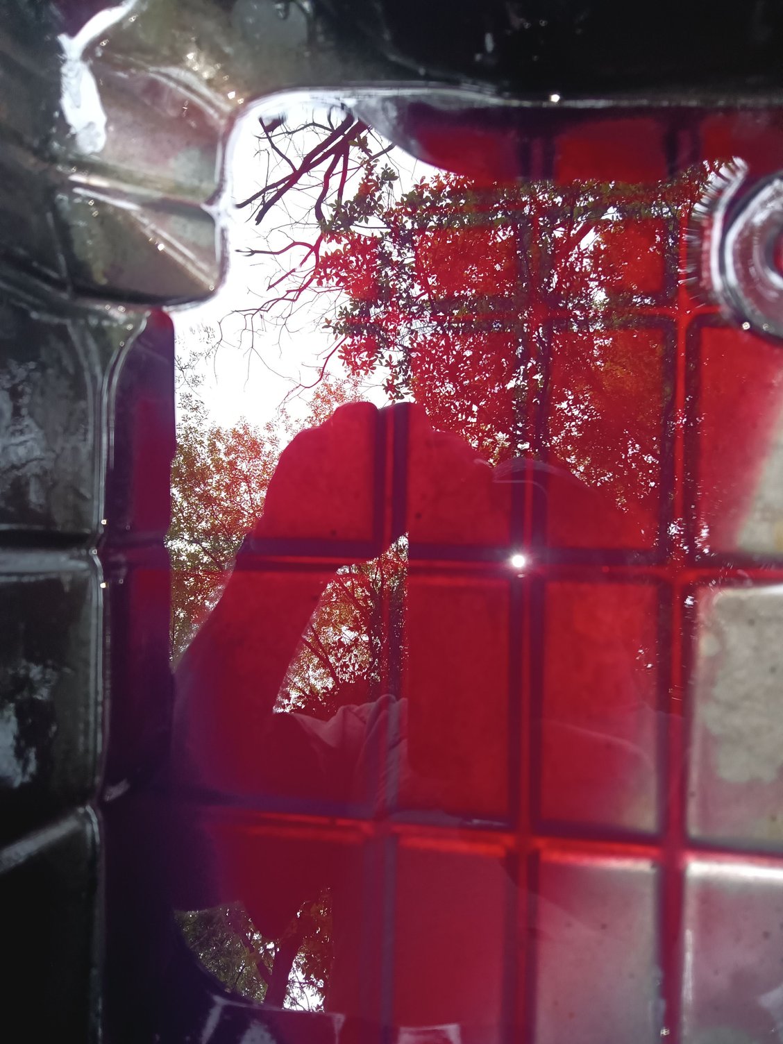

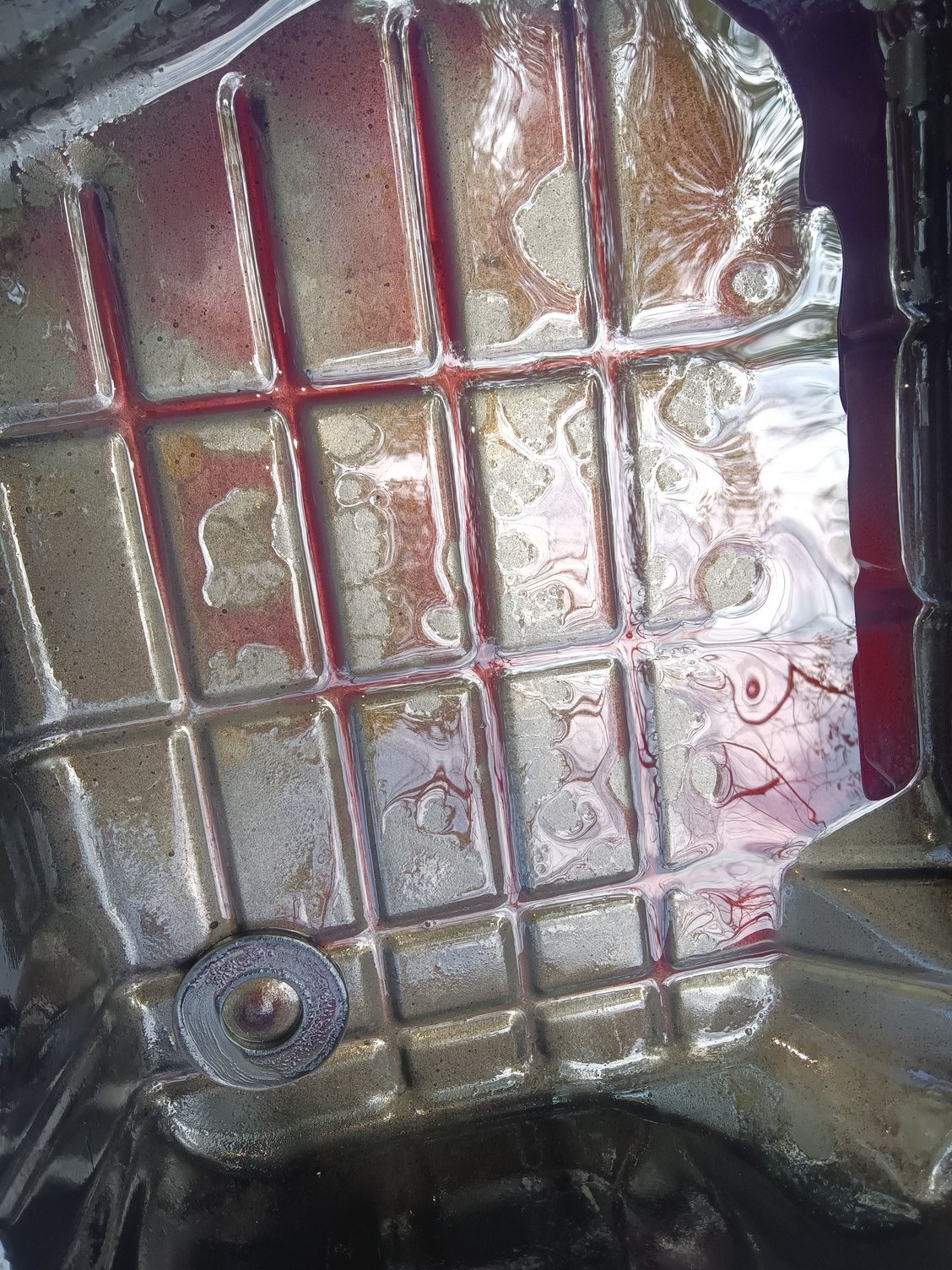

Yes Sir. I believe did it twice. I went back in making sure the adjustment was done by the book. I dropped the pan and it was clean as a whistle. Nice clean fluid no metal at all and magnet was pretty much clean. I have replaced the pressure sensors twice along with the lock up and over drive with harness. Replaced the spring as well. At this point, I can't see anything that could be replaced to fix this issue with slipping other then just biting the bullet and do a rebuild. Being third gear by the way it's acting is making me think that it's in the valve body or torque convertor may be acting up? If I am understanding correctly the band handles 1st and 2nd. I'm soaking down bolts for now. This how clean my pan was when dropped. You can see I index the finger and there was no metal at all. The black spots in the pan are from the over spray when I painted the pan way back.

Band is only used for 1st in manual first. If you have it in D, band is not used.
More likely, the 3rd gear clutches are just worn. Bumping line pressure might bandaid it for a while, but, it is quite likely rebuild time. (I believe the zip kit gives you some options on line pressure.)
