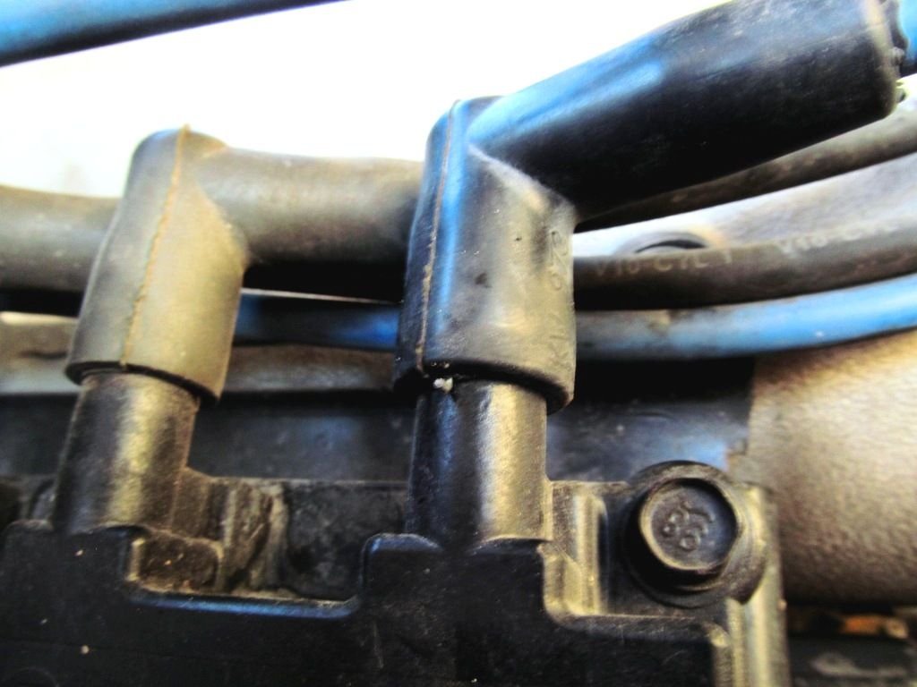

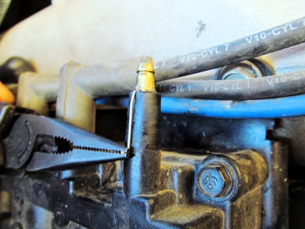

I built 10 little inserts for the coil wires to help me chase weak/different/odd cylinders. Slide the wires in, ground them with a test light while the engine is running, dead holes don't drop the idle.
