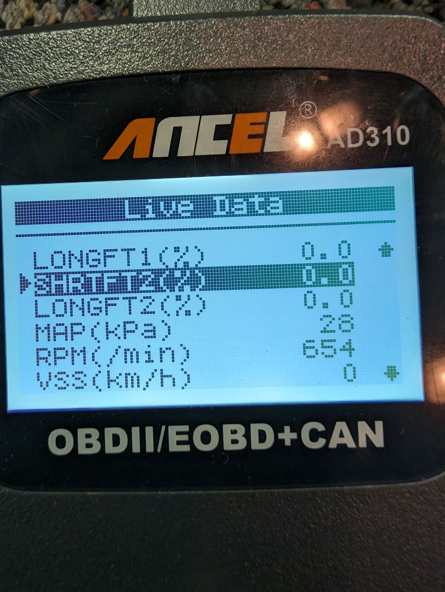

Well gentlemen - she's purrin like a kitten! Haha! Sort of...
Replaced the spark plugs and then checked the TPS. It was sitting at 1.4v... noticed it was also flipped the opposite way it show in the manual...
Took the bolts out, flipped it and clocked it to about .7v. Fired it up - smooth as can be! 😁
Bolts were absolutely no where NEAR going back in - looked with the endoscope and couldnt even see the holes... pulled the TPS and through trial and error ended up slotting/cutting A LOT out of the ears and using two different sized washers to get the bolts to be able to go in... also might have slightly cut into the sensor housing by accident.... 😅
Love data of it running after I had the TPS back bolted down...
(RPM is 650 in the picture but it usually stayed close to 750-800)
also this code came up... maybe something happened when I was adjusting/tightening it down...? Did it while the engine was running 😂
BUT SHES RUNNIN!!! 😁
