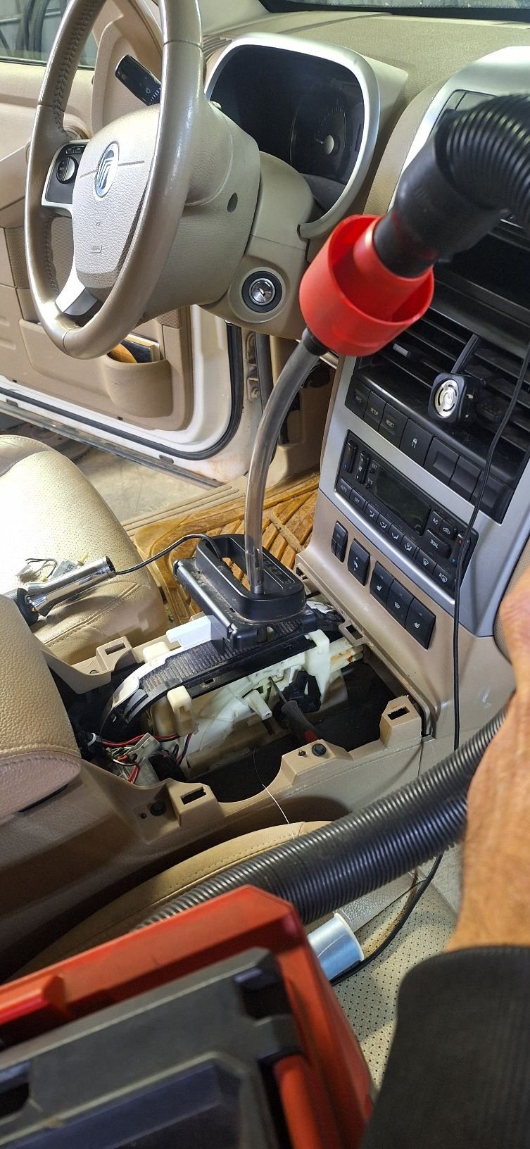

I wonder if you could literally use a vaccum.....like "Hoover didn't invent the vacuum but he sure sucked as a president".....perhaps the only thing I remember from 9th grade history
Milwaukee sells an "Air Tip" attachment kit for nearly any vac/shop vac. Reduces hose to much smaller hose size. I just used it to suck broken plastic out of an Exploder shifter . Several hose sizes are provided
