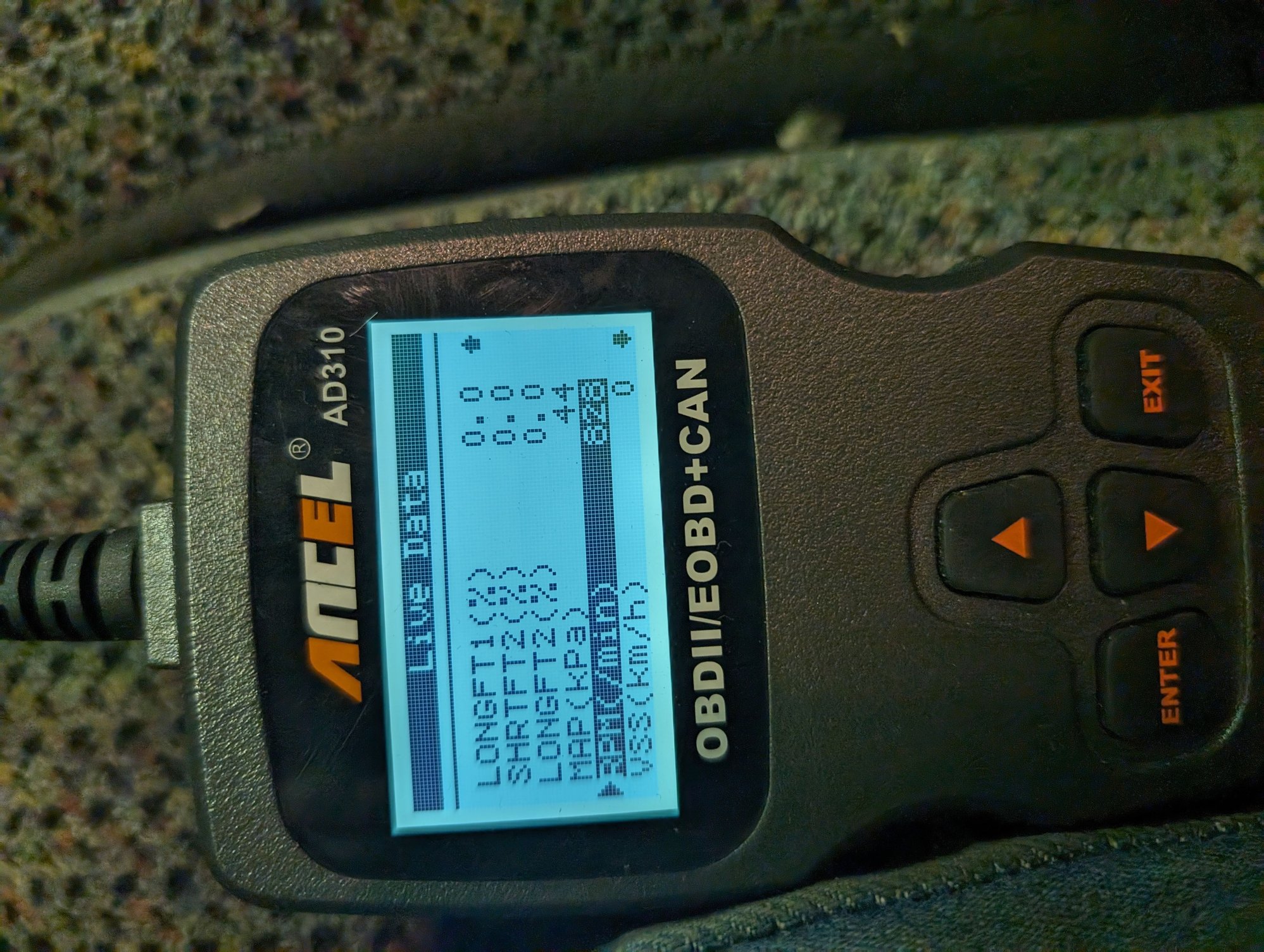

Got the SMP in today - a day early!
Went out and plugged it in - 4.6v on signal return...
fired it up - ran poorly still... 2.2v on return...
Ignore the dirty shop... been working on clearing out all the clutter that was left behind bay by bay and from the doors to the back 😂
Anyway -
​​​​​​Swapped for original PCM for fun.
ran a hint better...? 1.7-1.9v on return signal...
Got live data to work this time and showed the 40s for MAP reading.
Ran the truck for at least 5 if not 10minutes - no codes.
​​​​​​Still running rich. Hesitation on the pedal and backfiring when letting off. Definitely rich but no where near as bad as what it was! Or seems better...?
Aren't these readings going sort of the opposite of what they're supposed to be though...?

Idle around 800 or so? If that's the case, map is actually reading correct. Should be seeing 18 to 20 inches of vacuum on the manifold.
What do the other sensors have to say for themselves? Engine temp? TPS?
