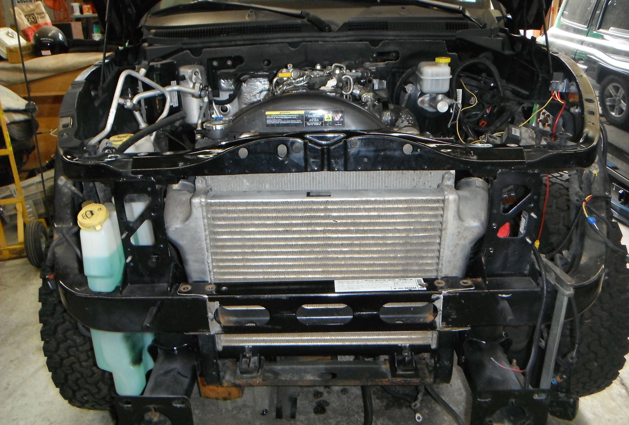

Its been a very busy time at work so have not had much time to work on the truck.
Did get all my turbo hoses ordered and the intercooler mounted.
Finally got the shifter bent to just the right angle so it clears the dash and comes up through the shifter boot.
Had to mount the Cummins ECM and Racor fuel filter where the battery used to be. I was going to move it to under the rear seat anyway so the space worked out well.
While I had the box off I pulled the tail lights and sprayed that water sponge that they put between the bed sides and the box with a good wax based rust preventative.
It wicks into seams and should keep the cancer away.
The truck is still sitting a bit high in the front end (2" leveling kit installed) and most of the "stuff" is installed. I don't think I'm going to be much if any heavier than stock on the front end. Still have the air bags to install in the rear so I can level it up.
This "Black Magic Extreme" fan should keep everything cool and is a perfect fit on the rad. http://www.summitracing.com/parts/FLX-180/
