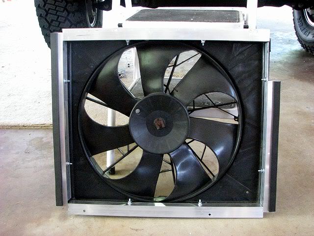

Here is the MarkVIII frame. It covers the radiator top to bottom and side to side. It's made from 1.5" aluminum angle. The cutout is where my tstat probe was located.

I made the frame.

Thanks frog, was the bracket needed for it to fit? I found one on ebay that I am looking at buying its like $50.00 so if this doesnt work the damage wont be to bad.

The bracket is what I used to mount it to the radiator. There are two holes i the top and bottom of the radiator. I just drilled brackets to match those holes and bolted it in. You can cut the aluminum with a hacksaw.
