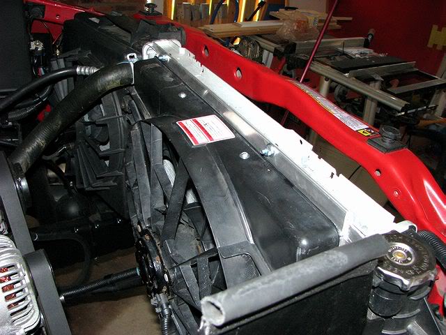

This is a markVIII fan I had in my rig for a while. It completely covers the radiator.
And this is the one you have. Check out the mounting tabs and size- two different fans.
Do you still have the Mark fan frog?

I sold it when I got my viper fan. Even on low speed it moved a lot of air!
Old Apr 26, 2009 | 02:22 PM
  #36
dedogg's Avatar
dedogg
Joined: Mar 2008
Posts: 1,437
From: North Carolina
why did you upgrade, just a better fan? I have found a couple Mark VIII fans on ebay. Would you say this is a better fan then a taraus fan? With the Mark fans you dont need the stock shroud? How will this work with a body lift?

It should fit with a body lift. The Mark VIII is a good fan. Looks like it fits really well too.
You got a pic of the Viper fan Rubberfrog?

The markviii is equally as good as the viper fan. I "upgraded" simply because my junkyard markviii looked a little rough.
The markviii does not need a shroud and actually covers the radiator better then the viper fan does.
I don't have a pic of it on the truck.

sweet then going with a Mark fan vice a turaus fan will save me work in the long run, going with the body lift and all. I would imagine everything is still the same (wiring and relays)? Thanks for your help and input.

The Lincoln fan is a completely different animal. Yes they do pull the amps at start up. People are getting those mixed up with the 3.8 liter ford fans. I could not use the Lincoln fan on my truck because I don't have a radiator cap on my radiator like you do. Mine is on the over fill tank and that bolted to the stock shroud so I had to keep my stock shroud and went with the 3.8 Ford fan to fit inside it. The wiring diagram will work the same its just that you need to upgrade your relays to:
http://www.skycraftsurplus.com/index...OD&ProdID=1503
