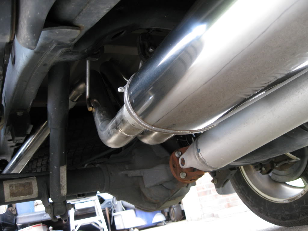

My 08 2wd driveshaft is aluminum. Should net be an issue with 4.56 gears. It is a popular upgrade for Mustangs to upgrade to an aluminum driveshaft. Perhaps if off-roading and you drive over something and hit it, it may bend easier, but in normal conditions, no problems.
Also, a good shift kit will reduce actual shift times which will increase acceleration a little bit as well as reduce slippage between gears which increases transmission life.
