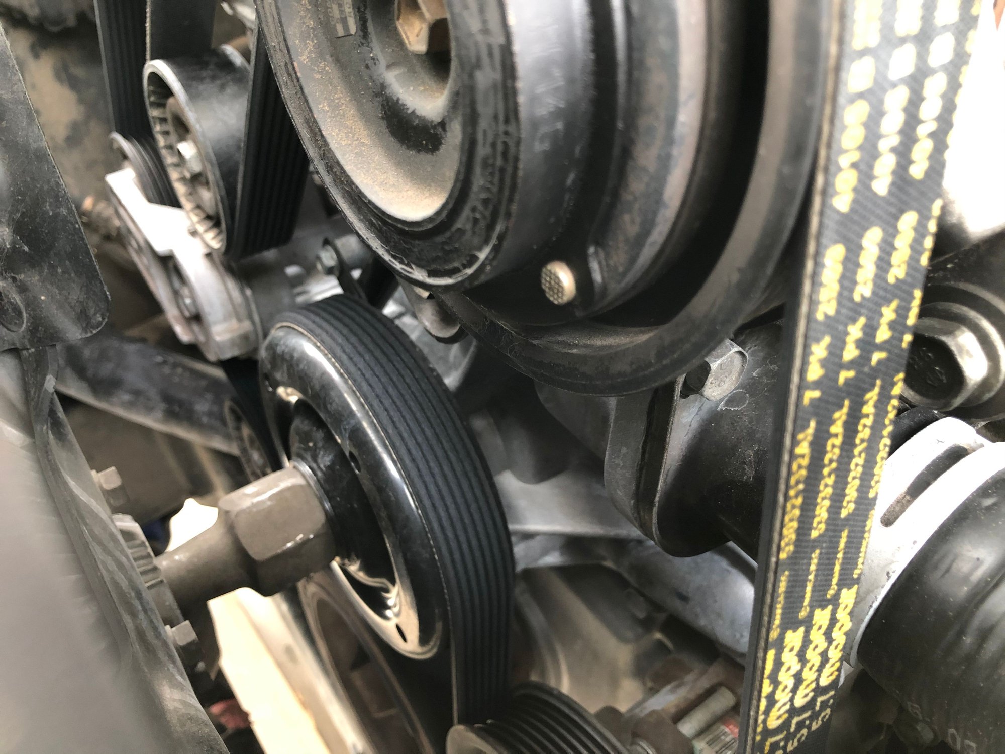

New mopar water pump cha Ching and drive belt
